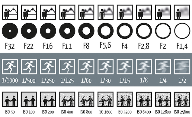

This will help to understand, along with ISO and aperture.
You need to understand all three

Hi Steve
That is an awesome diagram! i was actually looking at that exact one when trying to change my shutter speed.
I am in shutter priority mode and i turn the dial at the back of the camera but i cannot seem to get the shutter speeds of (1/1000 1/500 ..... 1/2) i only have full numbers. Someone suggested possibly this is the ISO i am changing? Id like to know what i am doing wrong here and why cant i see the fractions?
