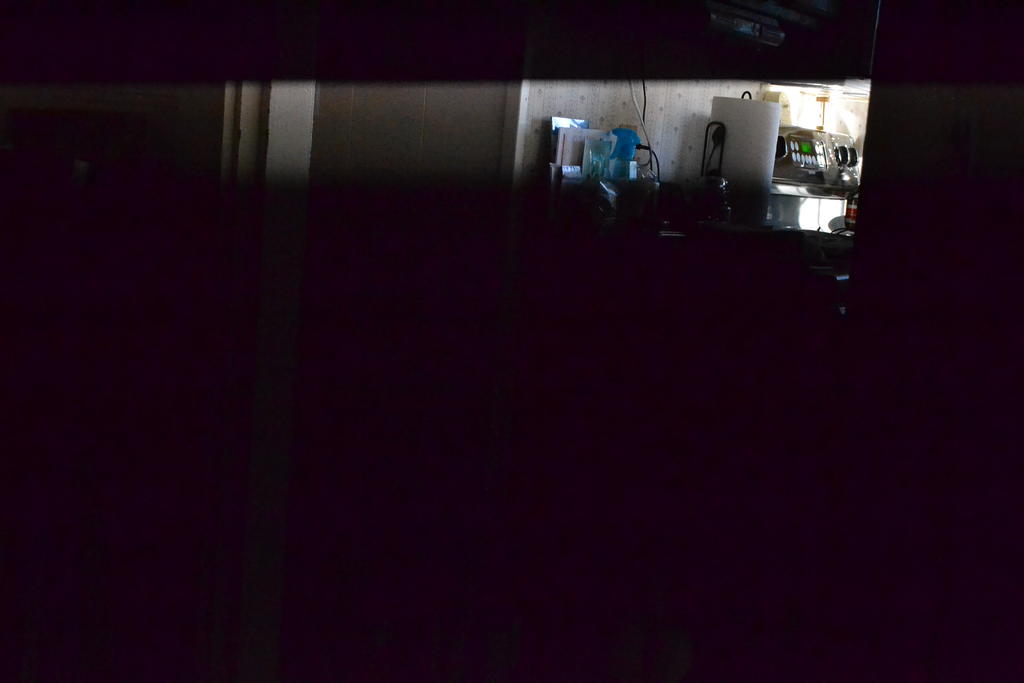

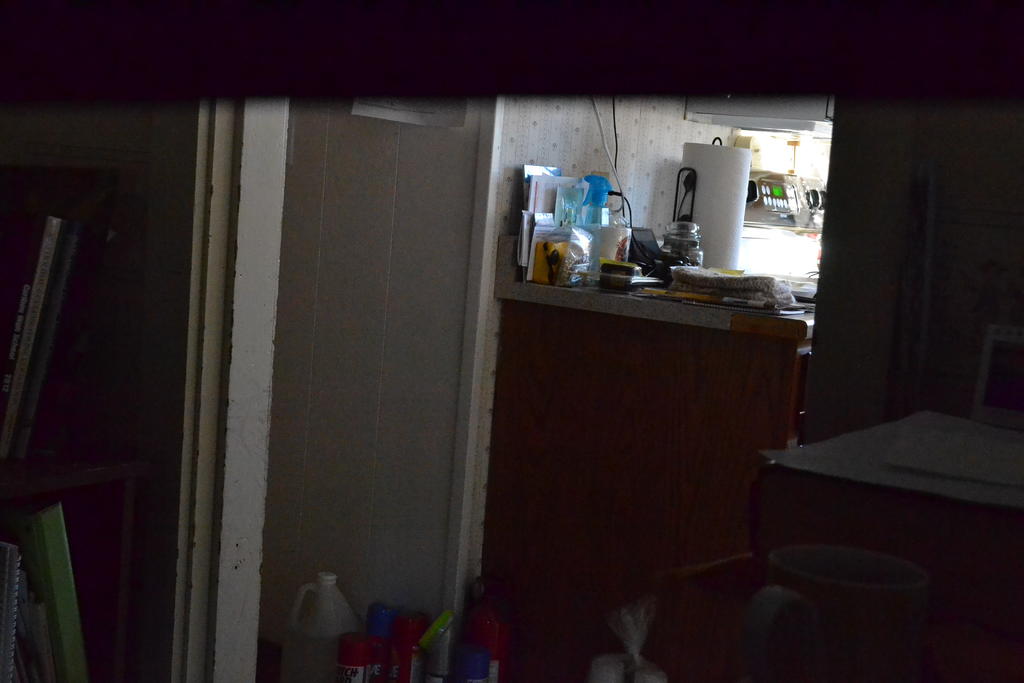

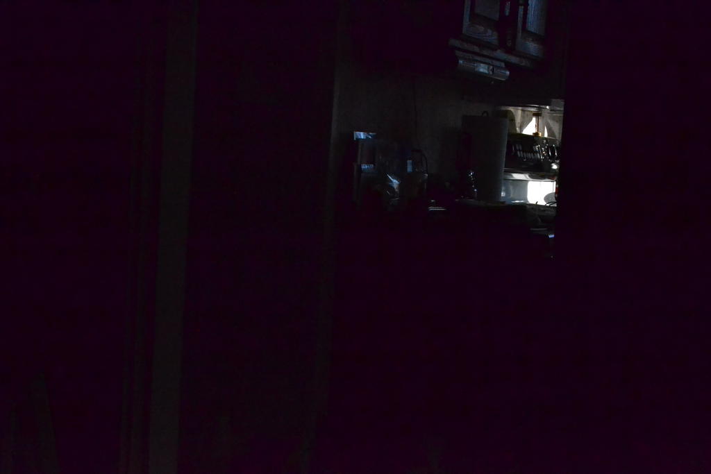

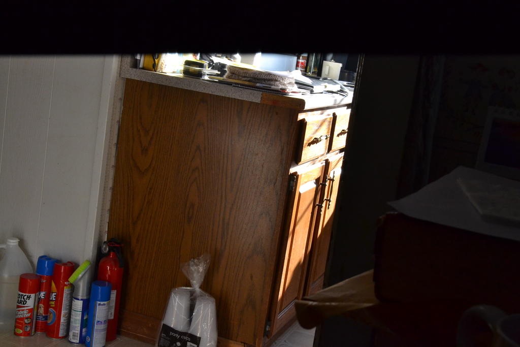

Problem 1. there is a sizable horizontal black band across the top of the photo.
problem 2. there is an horizontal bad that is much more exposed than the rest of the frame sandwiched between two that are exposed according to the camera settings. This becomes much more pronounced when the photo is under exposed and set to high ISO.
Auto Mode:
manual f/8 iso3200 shutter 1/4000:

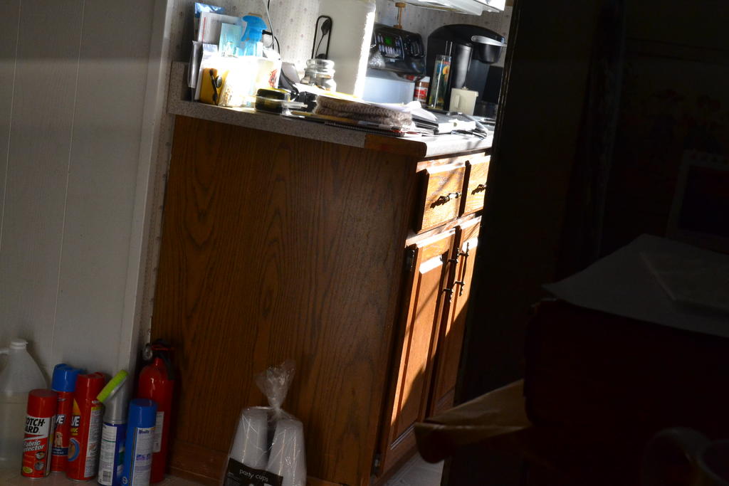

Same settings, in quiet shutter mode, this is how the above two photos should appear:
