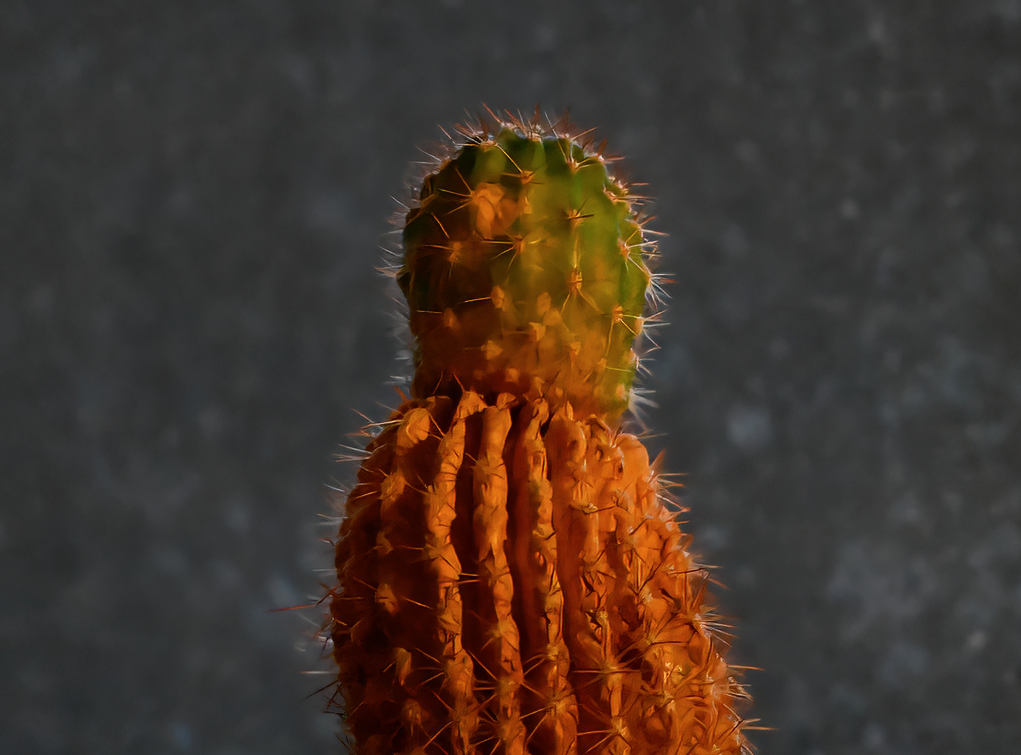

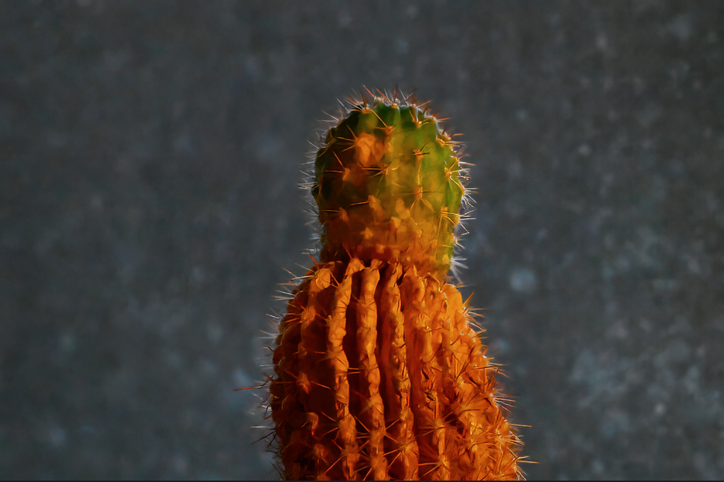

Just received the z TC1.4x. Did a quick test indoors:
@600mm jpg, cropped, DN AI, scaled down
extended 840mm no crop, tone curved, DN AI, scaled down
Due to the poor weather, no animals are available for the test for the details on subjects. From the indoor quick test, it looks working fine as of sharpness except downgrade in light exposure (no AF slowdown felt though) which may be saved by tuning the tone curve. It also looks like the image details are retained better without being cropped in 840mm (If I didn't crop the 600mm a little too much). What are your thoughts? Do you consider the Z TC1.4x a keeper?
