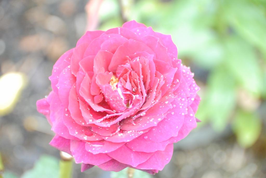

I have D200, with very light use. Just all of the sudden started shooting over exposed shots...over by many stops not just a little. Went through camera reset to factory reset thinking maybe i had a setting off somewhere but problem remains, recharged the batts to full still over exposed. have discovered that when i use the in camera flash the pictures are exposed correctly. I got a book on D22-Field guide but hasn't helped. Anyone recognize this problem issue and can shed some light (no pun intended) I would greatly appreciate it. Jel

Thank you all for your prompt responses, when I try to shoot in manual mode it seems to be stuck on M BULB whether flash or no so need to get that on track first .

It may be that the command wheel has been turned to settings past the exposure adjusting capability of the camera. For example, in shutter priority mode, the shutter is set longer than the aperture can adjust to provide the correct exposure.
I can't read the EXIF. Can you look and list what settings were used for the first shot?

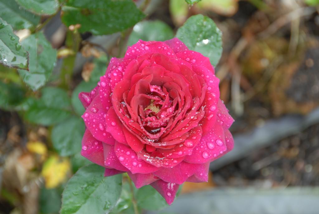

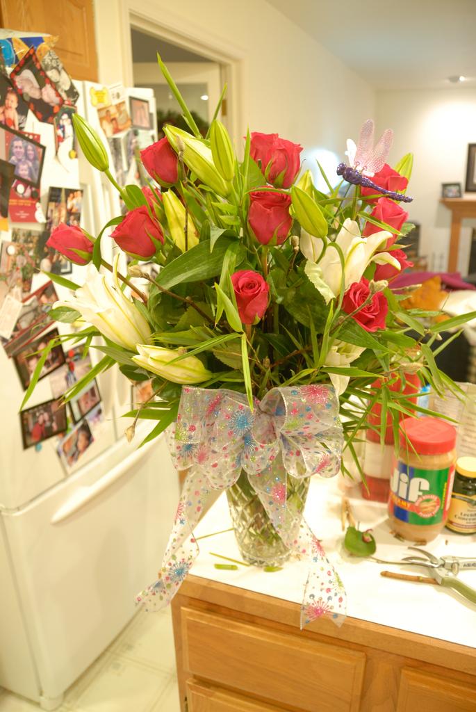

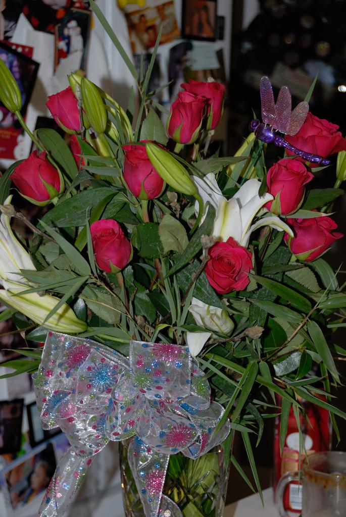

I don't see any EXIF data so there's little info. Of the four shots only the first seems to be somewhat overexposed. The others look pretty normal to me.
J-see
When I check the histograms in LR, the first is about 1 and 1/3 to 2/3 overexposed, the second about 1/3th underexposed, the third 1 stop to 1 and 1/3th overexposed and the fourth about 1 and 1/3th underexposed.

I don't normally look at those details so I hope these are what you wanted t see..thank you again
J-see
You're using exposure compensation. +2.0EV is about what the histogram showed. That combined with spot metering might give undesired results.
Set metering to matrix and exposure compensation to 0 and check the shots. They should be better.
