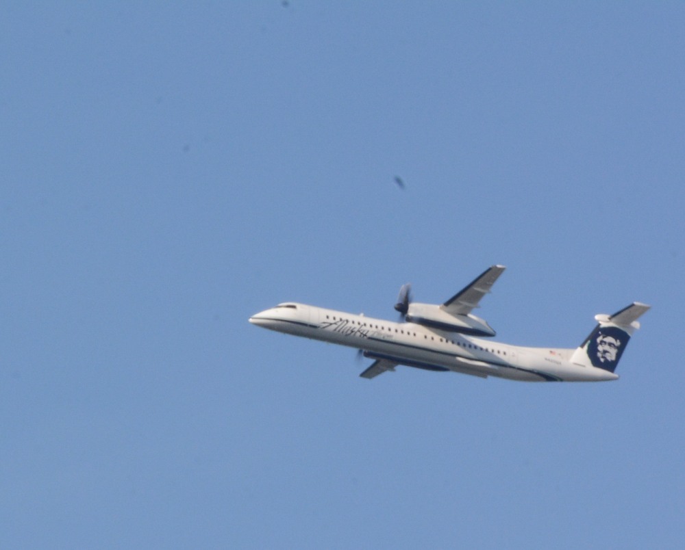

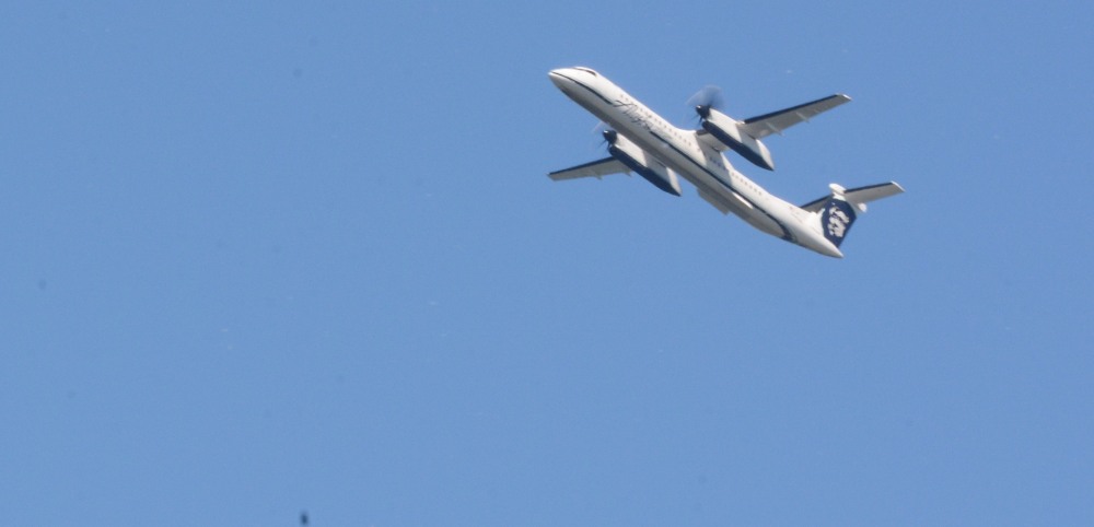

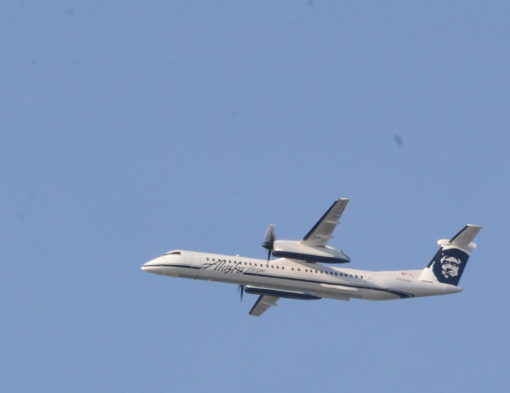

Shot a few aircraft yesterday and was trying to get the props showing movement.
If shooting from close to same distance what settings will be needed to get
the movement and plane in focus?

To me all the images show the props having movement. As far as the focus goes, what focus mode are you using. F-stop has nothing to do with the focus issues. Of course the smaller F-stop the narrower DOF.
STM
To stop prop blades with some blur, you should probably be around 1/250-1/500 sec. Anything faster will just stop the blades
Rick M
Whats up with the small aperture? f25, f29 is way to small. It's slowing the shutter too much and introducing diffraction.

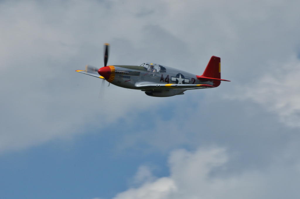

I shoot at Airshows when I can and try to get prop blur. A frozen prop looks unnatural. Use shutter priority and let the camera pick the f stop. The speed suggestion that was given by STM work very well. You can adjust up or down to get the amount of blur you want. The faster speeds will make it easier to get a sharp picture.
