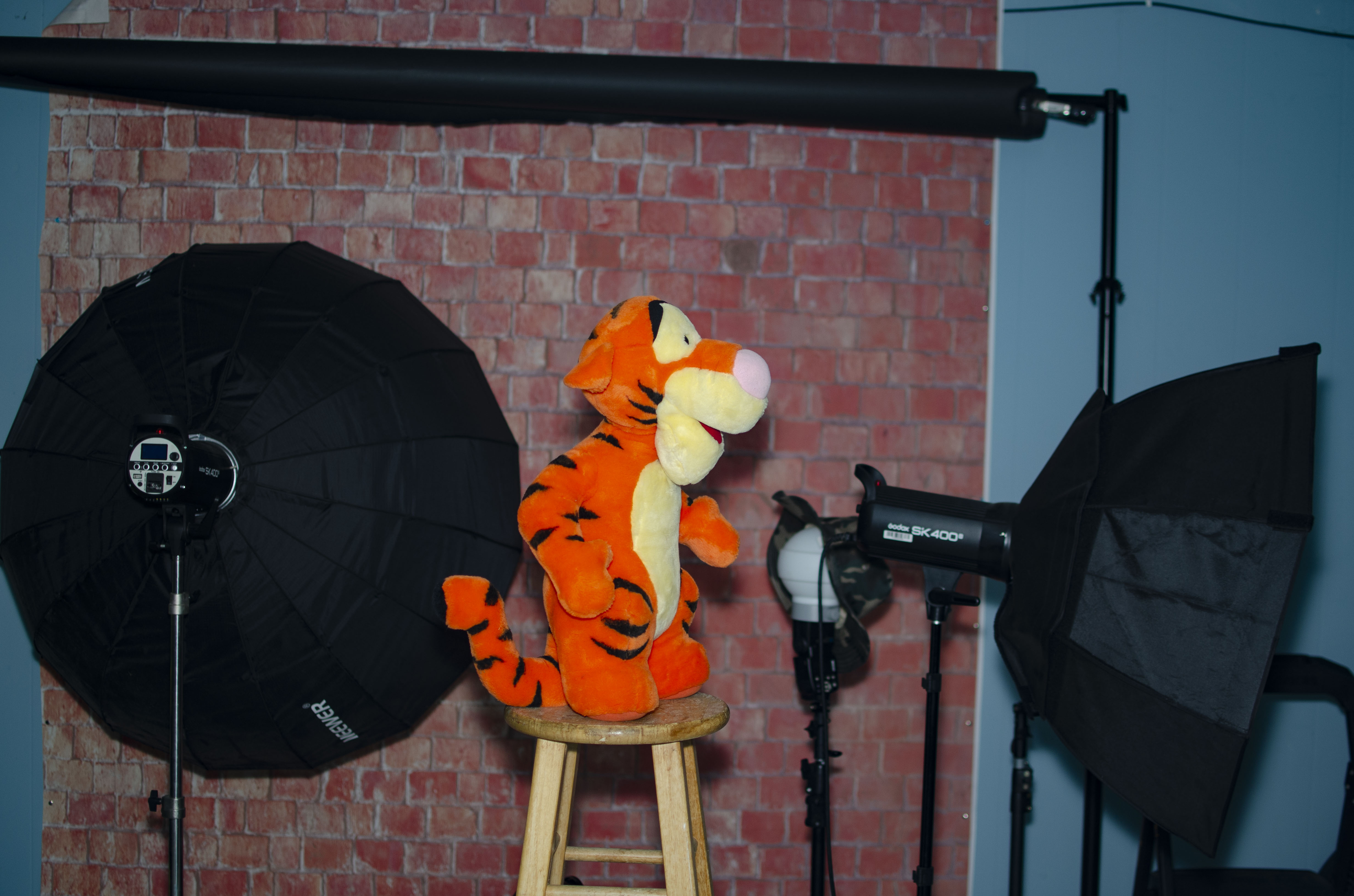

Lautermilch

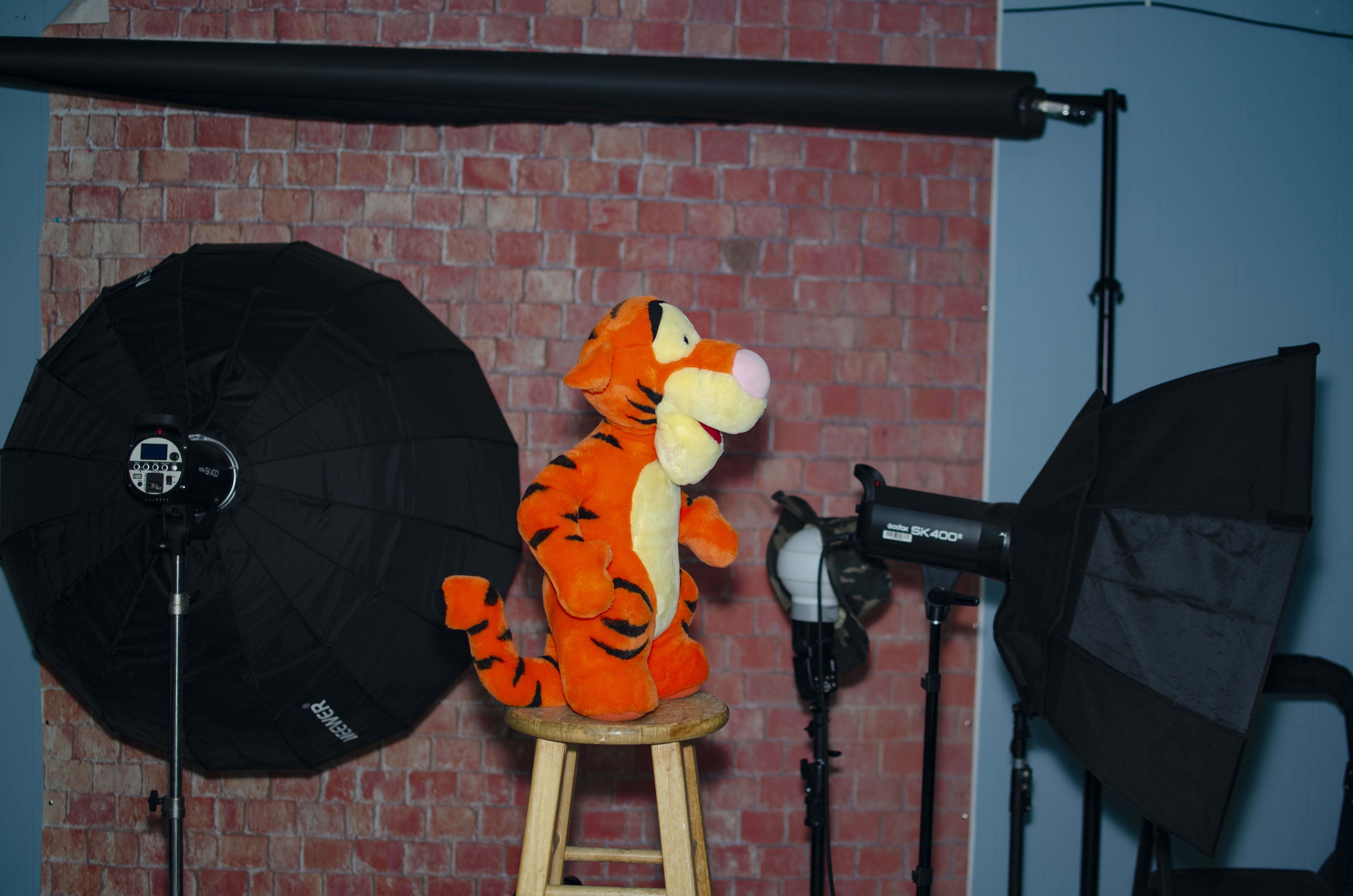

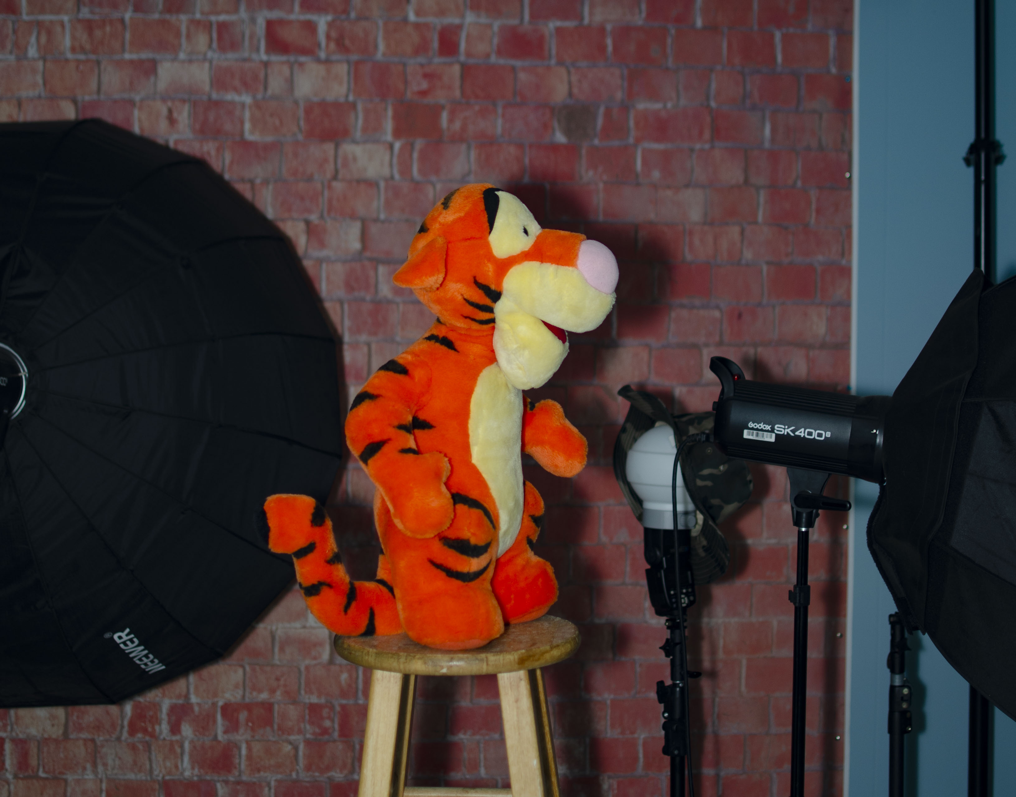

Thanks, that worked. I am using a lower F stop to keep the flash lower as I already overheated and ruined one a few months
After the changes I took some shots on 'Tigger' in my home studio in darkness created by only having a light from another room lit.
