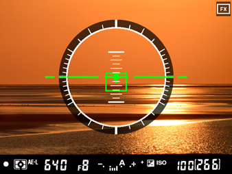

This is the rear LCD/Live View version, you can NOT have this show in the viewfinder:
Rear LCD Virtual Horizon​

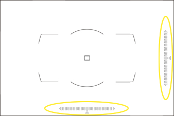

What you can have displayed in the viewfinder, assigned to the FN button, is this simplified dual-axis display:
Viewfinder Virtual Horizon​

On your D500 the menu you need is found under the Custom Settings (Pencil icon), section "F", sub-menu 1, or "f1" for short: Custom Control Assignments. It appears you can program the Fn1 button to the Virtual Horizon but NOT the Fn2 button. Go figure.

I looked around and finally found the option @bikeit is looking for: you can assign the viewfinder virtual horizon to the Pv and Fn1 buttons, but not to Fn2. Why Nikon chose not to make it a continuous option, i.e., allow users to turn on the viewfinder virtual horizon via a separate menu option, beats me.
