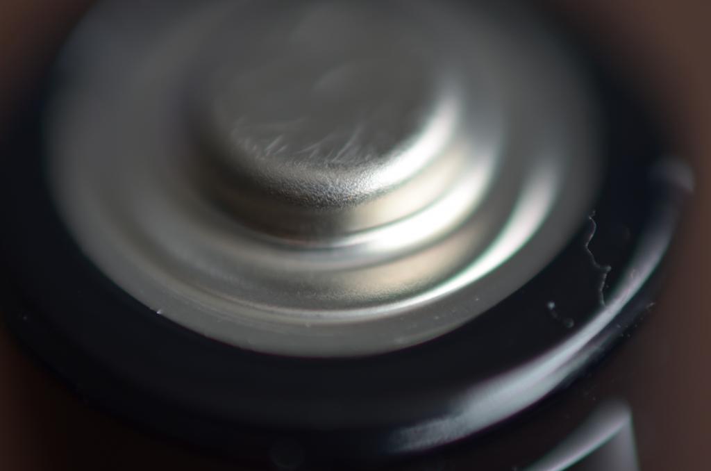

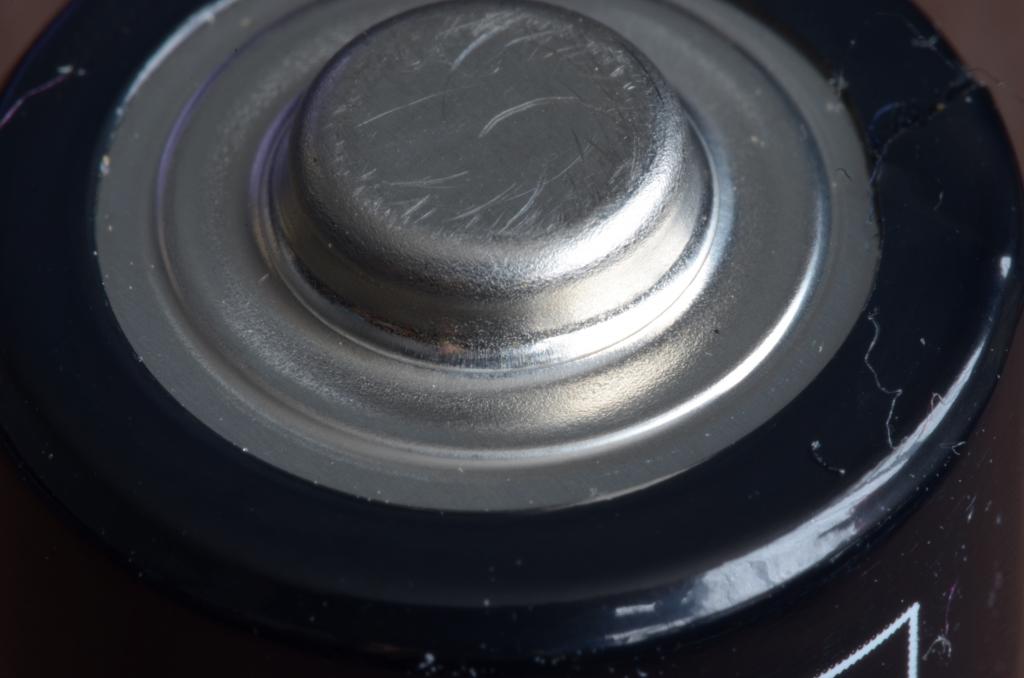

Using the 18-55 kit lens, set at 55mm (shorter focal length gives more magnification when the lens is reversed)
1st pic with a fully open aperture and second with smallest aperture.

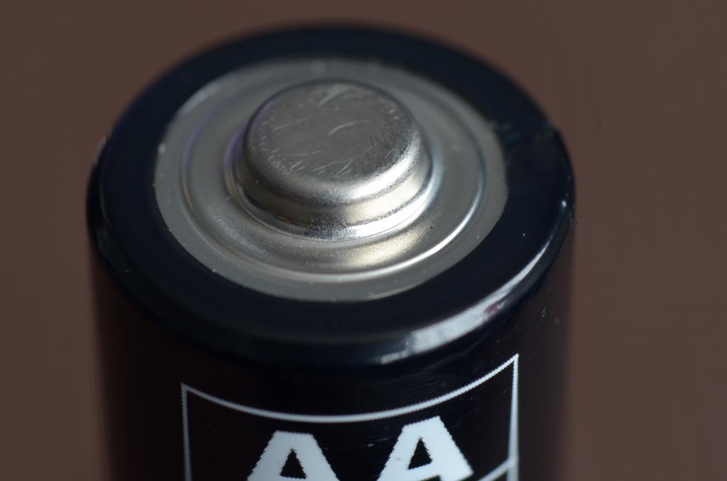

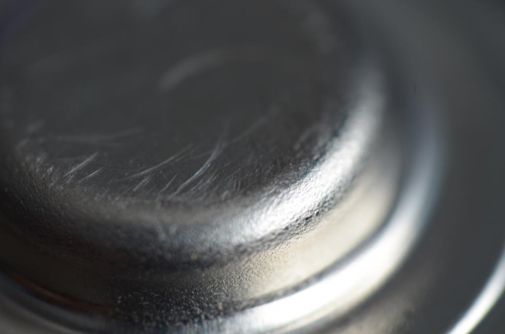

Same kit lens at 18mm, full open aperture and smallest aperture.

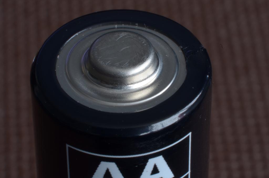

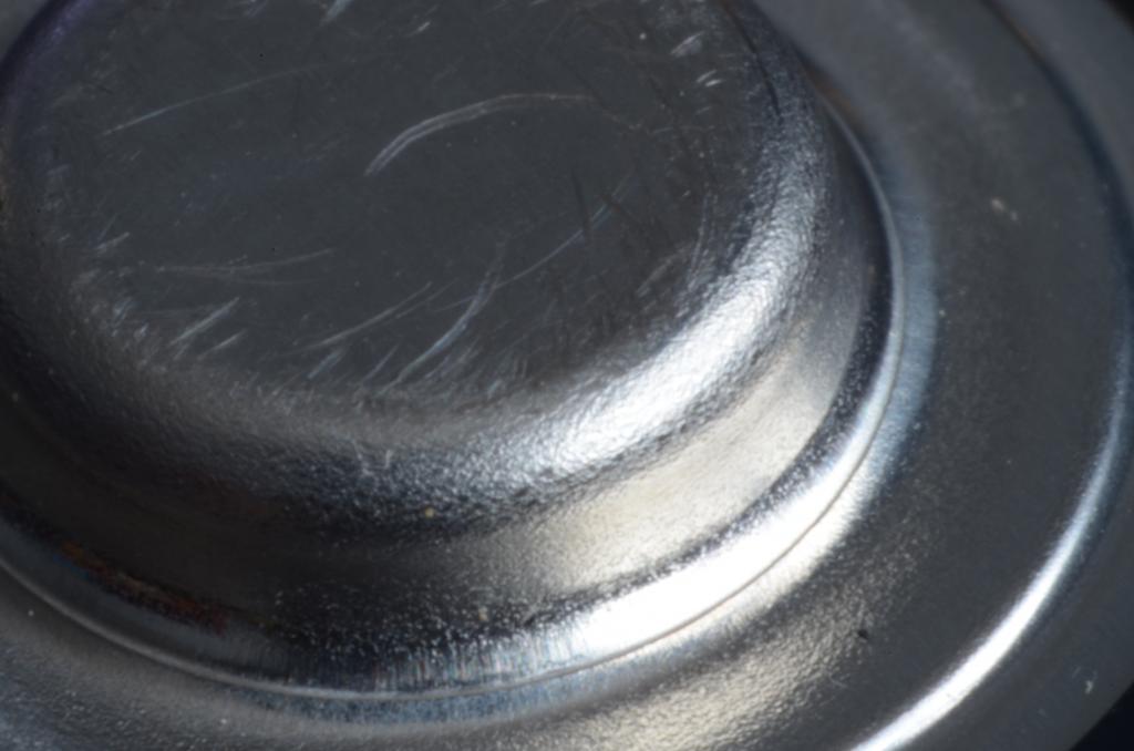

Now a 35mm 1.8 prime, full open and smallest aperture.
