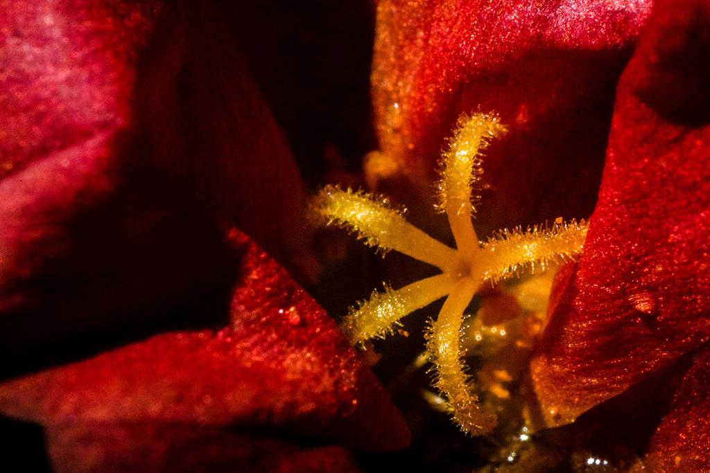

I shot this photo with a reverse mounted 28mm Series E Lens that I got for little money on eBay. I used a Nikon BR2A reverse ring and a Nikon PK-13 extension ring on my D7100. This is a very small flower from a moss plant.
I had to set the lens to aperture to F2.8 to be able to see the flower to focus and once focused, I set aperture to F22 to take the shot. I had my Nikon SB-910 held above the flower.
I have a Nikon 85 macro lens but wanted to try this reverse mount method.
