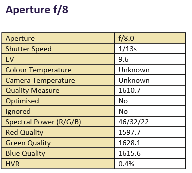

I have not saved all my reports so really can't tell you what they are. I did save the 35mm aperture sharpness report though. here is the top aperture report

About QoF numbers, I truly am not straight on that info yet. Originally at purchase I downloaded version 1.9.10.406. Next, downloaded the beta because it included the D7200. Finally downloaded version 1.9.11.416 as it was the official release that included the D7200.
In the 3 versions, charts have a different feel and the numbers are not the same. One day this week I will be running all lenses on both bodies with the 1.9.11.416 version.
I had posted the aperture results of two lenses here: http://nikonites.com/general-lenses/31236-post-your-focal-reports.html?highlight=reports
The results are a bit confusing compared to the chart and the summary box. The diamonds and lines are similar but not the same, so how to interpret that is unclear.
