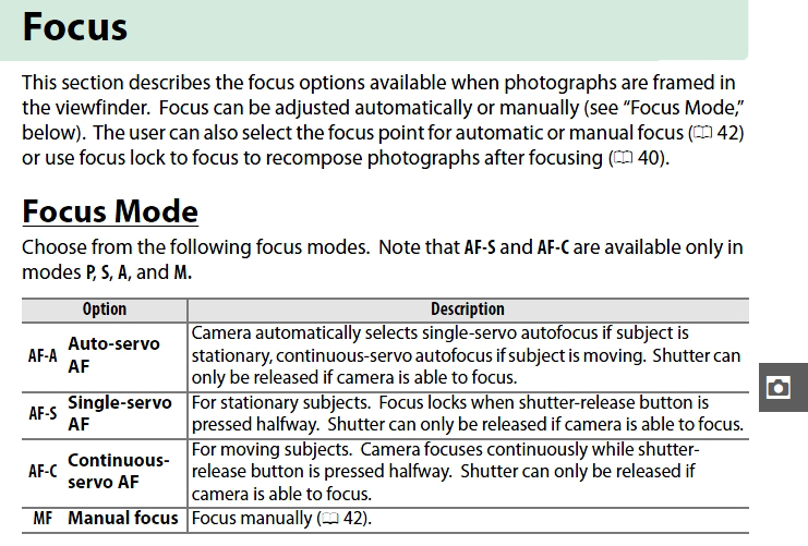

I don't think the d3x00 family has the option to set release priority. As far as I know, my d3100 does not. So if the camera cannot focus, you can not activate the shutter. (Unless you switch to manual focus)
Looks like you're right... Even AF-C is set to "Focus" priority with no option to change this behavior.
From page 36 of The Manual:
