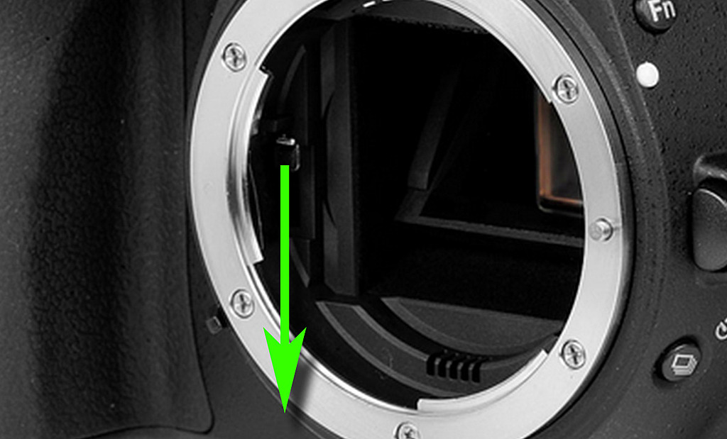

Hi everyone,I bought a used but almost new D3300 with faulty SD connetor. In the end, I have had to replace the main board and the power one.
Now the camera works but when the diaphragm is F10 or higher values error "press shutter release button again" appears.
I thought it was only in auto mode, but in manual if I set it to F10, for example, the error appears too.
The lens is the standard 18-55 and I checked that the diaphragm lever moves softly. But the lever in the body (that is on the left when you look from the front with no lens) moves freely but I think the spring is quite strong to be moved quickly with an electronic mechanism.
Would anyone be so kind and move this lever to check if it moves easily or needs quite more strength that the one in the lens? Or any other reason for the problem you could think of?

Guillermo ESP
Hi and thank you,
Of course I assume it completely. It's just to get any idea in case someone has been in the same situation.
By the way, I could test with a different D3300 and lens and the problem is in the body. And the mentioned spring moves just the same way.
I don't know if I'll manage to get a solution :-(
