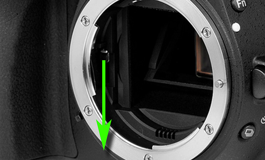

So I bought a D5300 solely for the birth of my first baby daughter. Being a n00b, I purchased it a few months earlier so I could get used to the camera. Took maybe 1500 shots, all good. There we we we're day 1 in hospital about to go under the knife.. I run a test shot to see the lighting in the operating theater ...
Murphy meets Nikon ... "Press Shutter Release Button Again"
WHAT THE HELL NIKON!?!? The only time in the history of ever that I need to take a photo and Nikon failed me.
After a few more shots, it appeared to be hit & miss, and turning the camera off & on again seemed to clear the error. Luckily for me it was still taking & saving important day 1 baby photos. I played around with it for a bit & determined it was only causing the error when a reduced aperture was needed.. (f/5.6 to 22) . So all my previous shots were at full open aperture regardless of the setting.
I took the lens off, fired a couple of shots & noticed the aperture armature was stuck. Took a few more shots (in manual mode / high speed 5fps) and at the same time, gently pushed down on the armature. It became unstuck, & all works fine now. I've taken maybe 100 shots since at various apertures & all looks fine.
Probably the only time I'll ever buy a cheap body.
Hope this helps someone.
