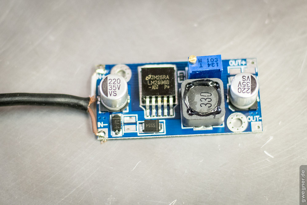

- A LM2596 voltage converter (note that this one is slightly different from the one pictured and has a lcd readout of the voltage & screw wire connectors so you wouldn't have to solder) You could also use this converter.

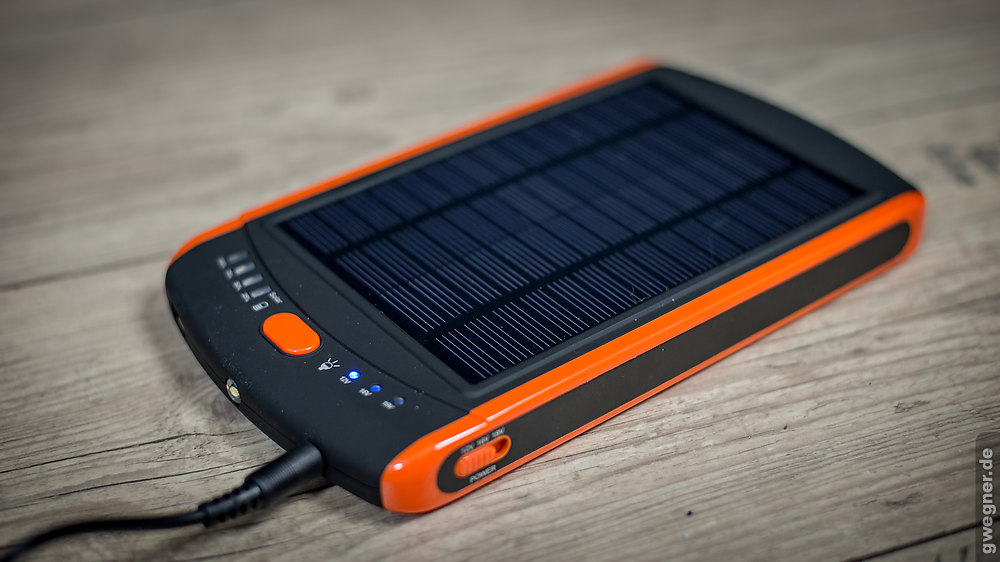

- A 12V power supply, I recommend the XTPower Power Banks, for example, with 23000 mAh.

- Solder the other end of the cable to the voltage converter to the end where the "IN" is written. Pay attention to correct polarity ±

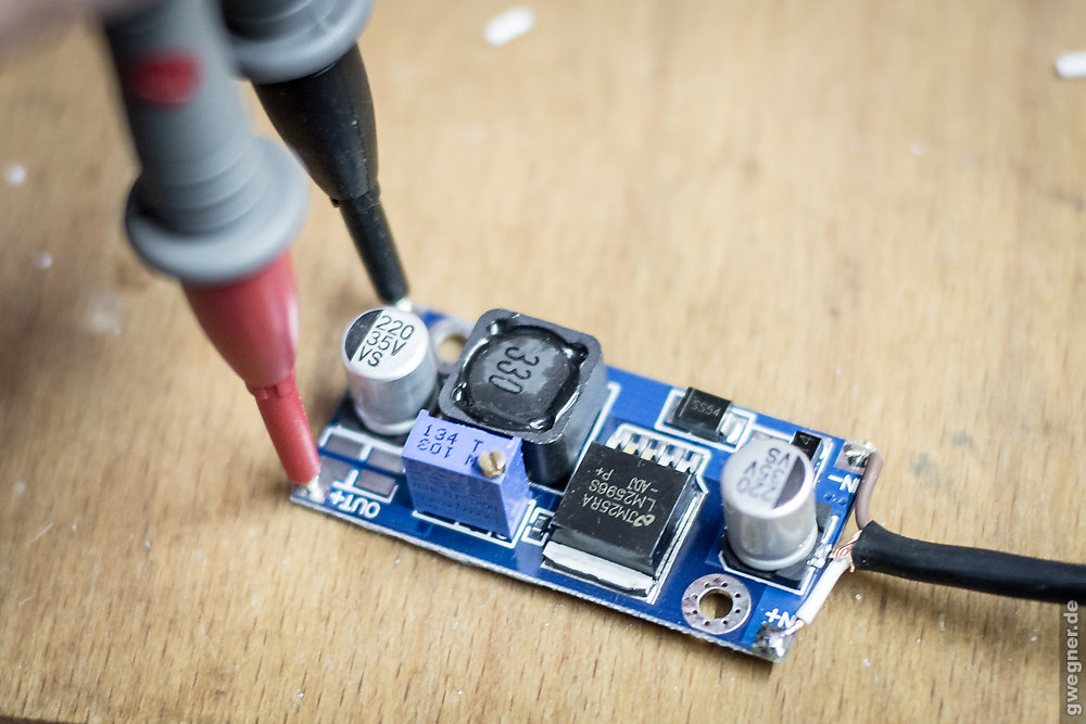

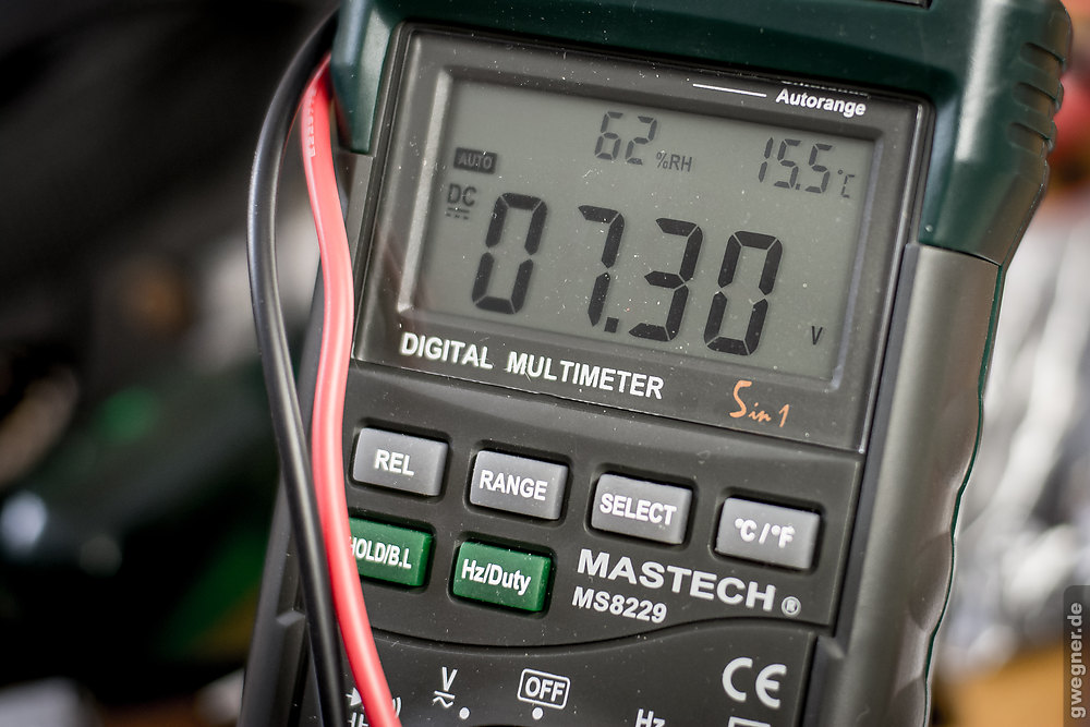

- Measure now at the other side of the voltage transformer (OUT) of the voltage with the multimeter. At the beginning it is usually 12V.

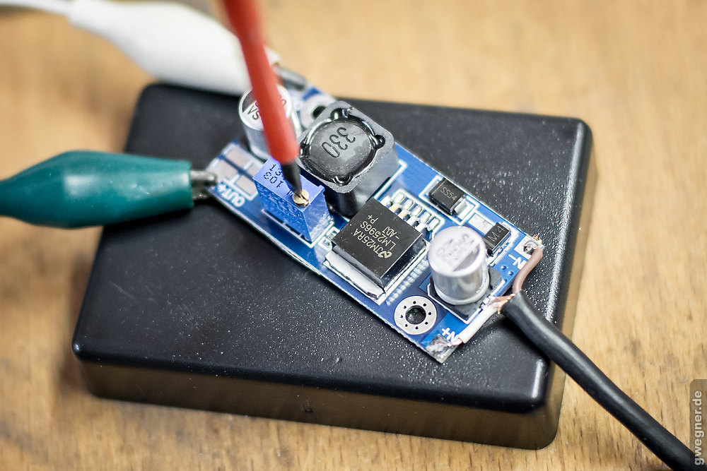

- Turn the screw with a screwdriver while you measure (alligator clips help) the voltage on the converter until the desired target voltage is reached. The EN-EL15 is this about 7.3 volts, the EM-EL14 approximately 7.4 volts. You should pre-measure the voltage with your camera battery as a reference.

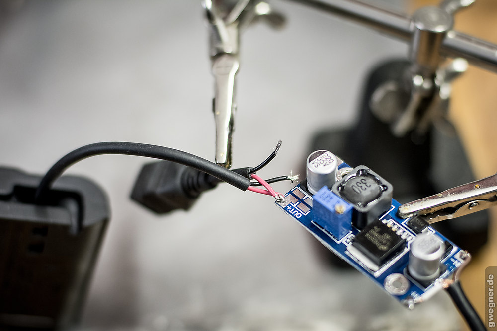

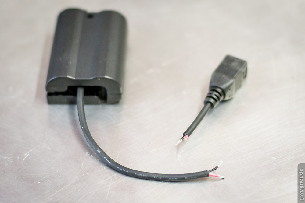

- Now cuts the cable of the EP-5B or EB-5A and strip the two inner strands.
- Solder the two red wires to the positive terminal on the OUT side of the voltage transformer and the two black wires to the negative terminal. If you want to play it safe, solder a small 2A Miniature fuse in series with the positive terminal.

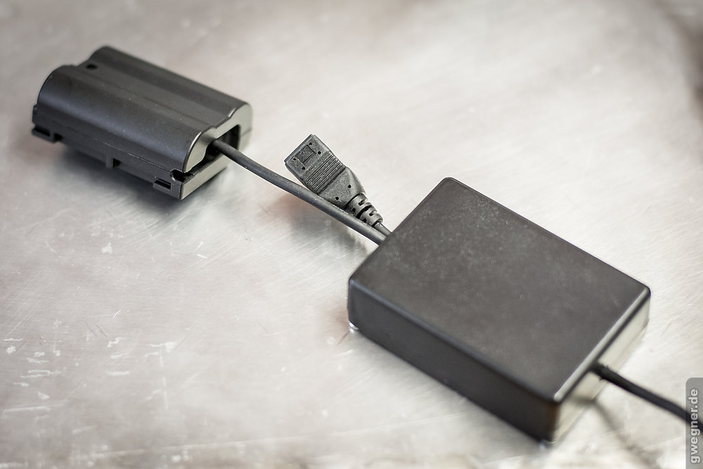

- If you want to use the AC power connector later you can solder on the adapter. Otherwise you can also omit it and just solder on the battery adapter.
- Ready for a first test:
- Now even in the case INSTALLATION (VT with hot glue fix) and and go out, take time lapse!
