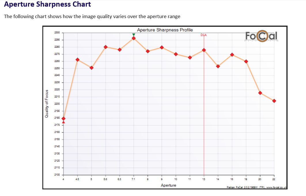

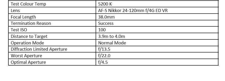

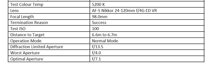

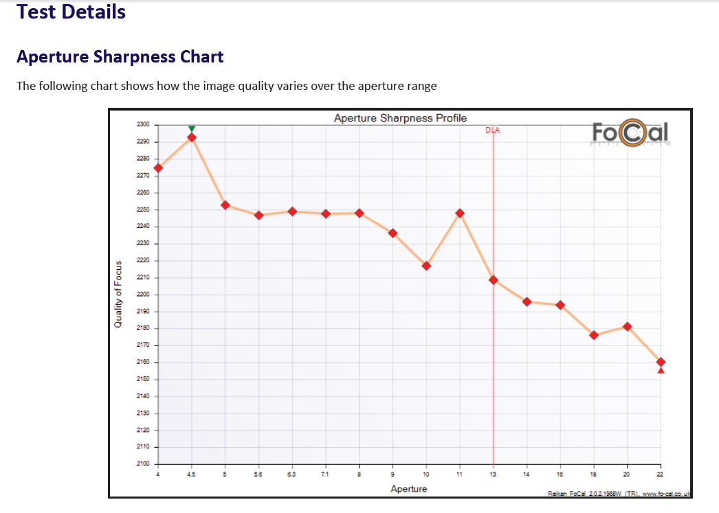

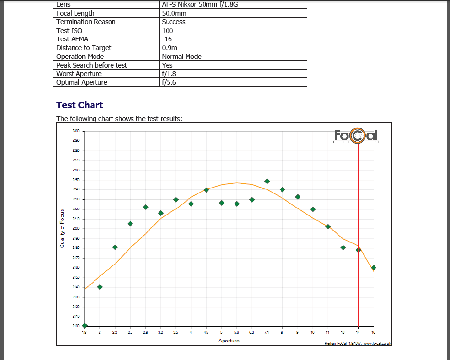

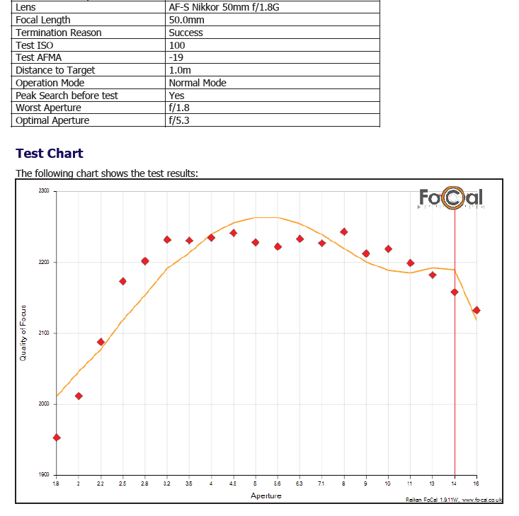

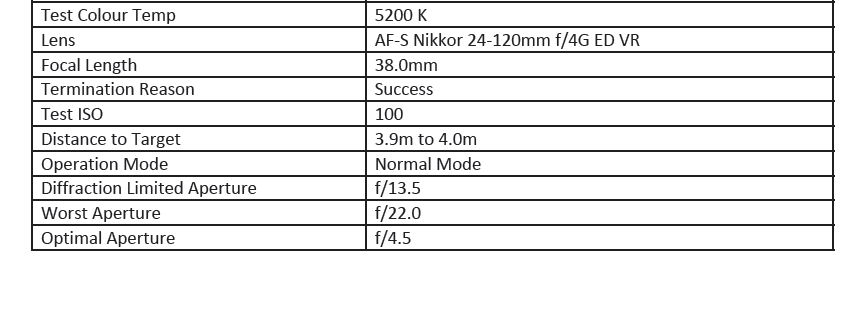

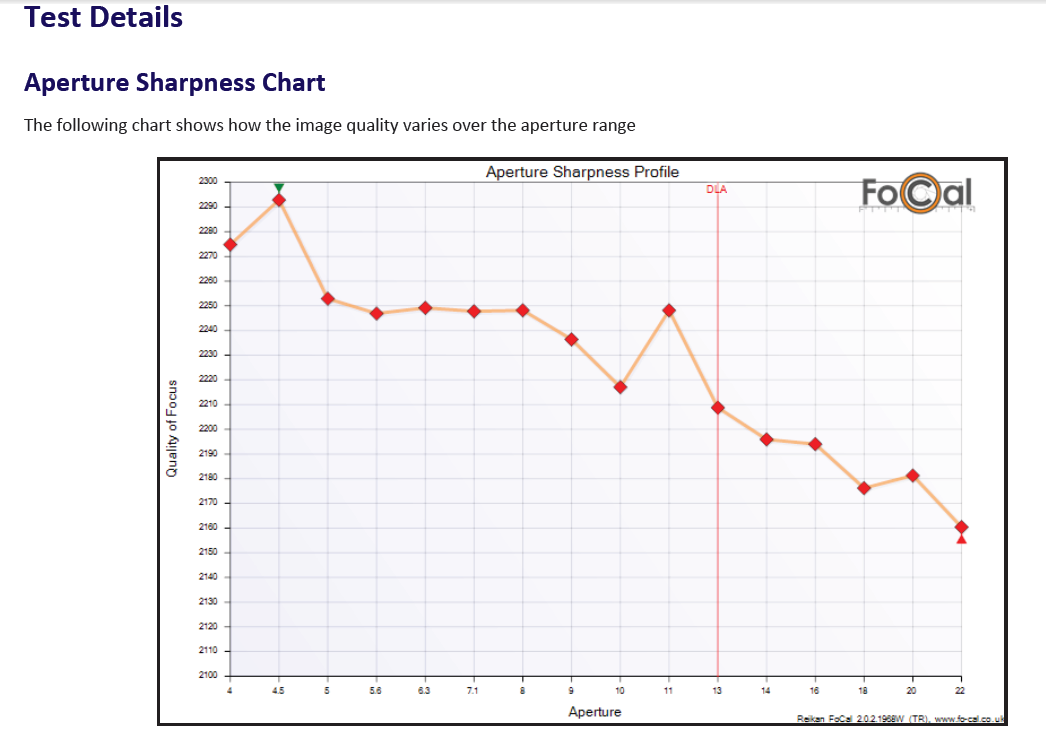

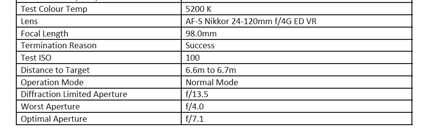

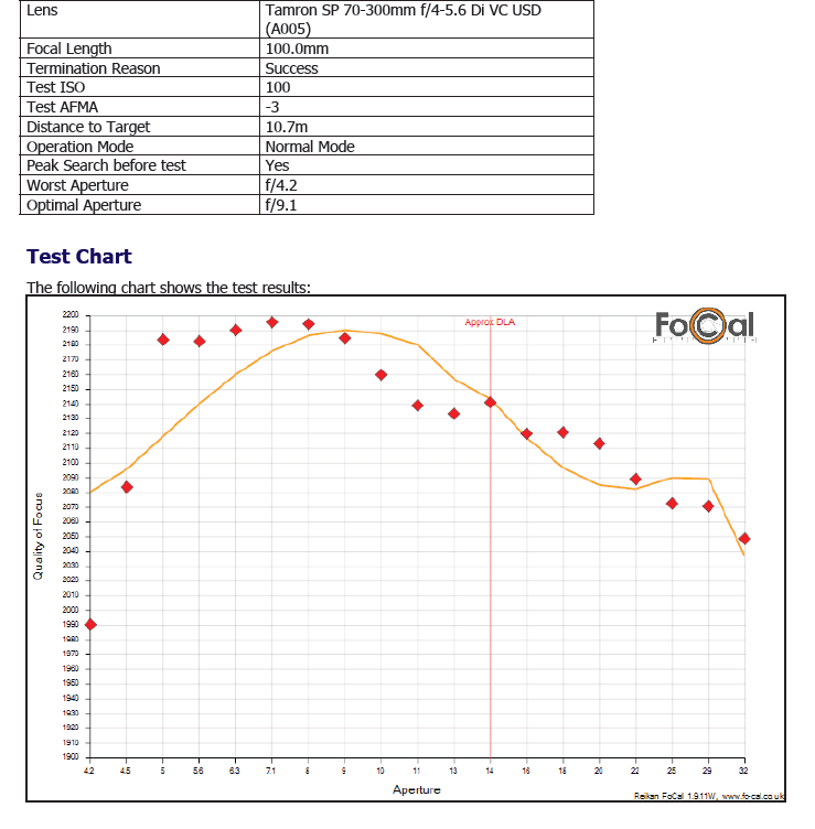

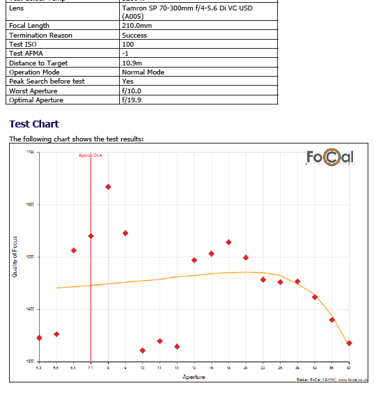

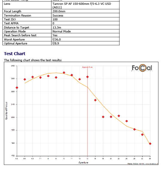

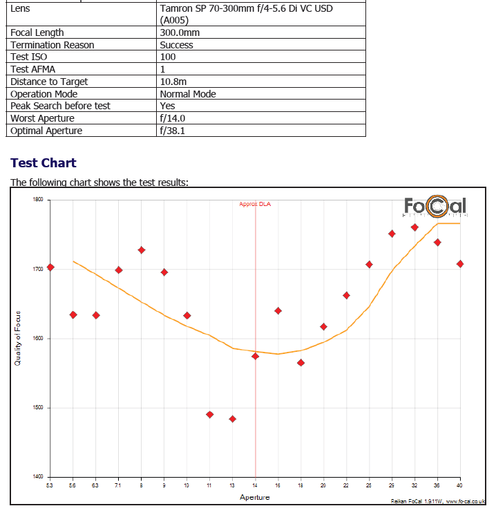

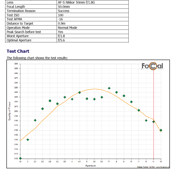

<blockquote data-quote="Bourbon Neat" data-source="post: 487682" data-attributes="member: 37727"><p>These reports are the results using the D700 body with the AF-S Nikkor 24-120mm 1:4 G ED lens. Pretty sweet if ya ask me. After a few shots I could see it was off considerably from the zero setting and needed adjustments. At 38mm it required a -13 and at 98mm a -16. I chose -14 and will go with that all the way through.</p><p></p><p>Other lenses require negative settings also which is ok with me. If different lenses required vastly different corrections, that would be a concern. The test results I have gotten from this software shows that Nikon to Nikon matings are pretty consistent. Notice this lens is consistently above 2200 with a low of 2160.</p><p></p><p>Something that would be a nice feature with focal would be to run the auto focus test using the optimum aperture. The default is wide open.</p><p></p><p>[ATTACH]176379[/ATTACH]</p><p>[ATTACH]176381[/ATTACH]</p><p></p><p></p><p></p><p>[ATTACH]176380[/ATTACH]</p><p>[ATTACH]176382[/ATTACH]</p></blockquote><p></p>
[QUOTE="Bourbon Neat, post: 487682, member: 37727"] These reports are the results using the D700 body with the AF-S Nikkor 24-120mm 1:4 G ED lens. Pretty sweet if ya ask me. After a few shots I could see it was off considerably from the zero setting and needed adjustments. At 38mm it required a -13 and at 98mm a -16. I chose -14 and will go with that all the way through. Other lenses require negative settings also which is ok with me. If different lenses required vastly different corrections, that would be a concern. The test results I have gotten from this software shows that Nikon to Nikon matings are pretty consistent. Notice this lens is consistently above 2200 with a low of 2160. Something that would be a nice feature with focal would be to run the auto focus test using the optimum aperture. The default is wide open. [ATTACH=CONFIG]176379._xfImport[/ATTACH] [ATTACH=CONFIG]176381._xfImport[/ATTACH] [ATTACH=CONFIG]176380._xfImport[/ATTACH] [ATTACH=CONFIG]176382._xfImport[/ATTACH] [/QUOTE]
