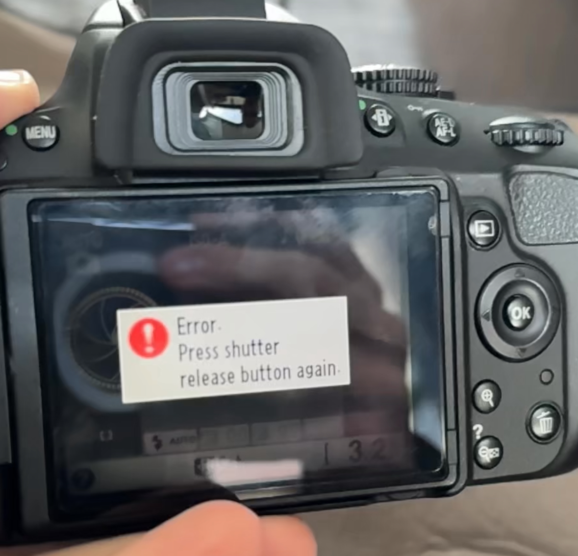

I am in the middle of Africa with no access to a camera shop / expert to help.
After my flight my D5100 went into an error mode
“Error. Press shutter release button again”
This is a youtube video of the problem.. pls help

BF Hammer
Tough spot here. My mind goes to sensor clean mode where you activate to raise the mirror and open shutter before turning it off to start a cleaning. It's in the menu setup section.
And then there is Mirror_UP mode (MUP) which raises the mirror on the 1st shutter release press but only opens the shutter and takes the photo on 2nd press. This is to reduce vibration from the mirror slapping open on long exposures. On my DSLR bodies it was on the function knob on the left side. I do not see that on your video, but it could be included on the menu.
There should be a 2-button combination press to return all functions to factory defaults, or a menu item for that. Not much to lose trying. The other trick we try is to remove the battery and then hold down the shutter button for 30 seconds or even longer. This is meant to discharge capacitors and reset stubborn hardware. Then put the battery back in after 5 or 10 minutes then turn on and take a test photo.

sharpe15
I had the same problem, and it wouldn't reset. Diagnosed as dust in the shutter mechanism, $250 to repair. I'm upgrading to a Z5II, the old 5100 has been great, but not worth the repair.
