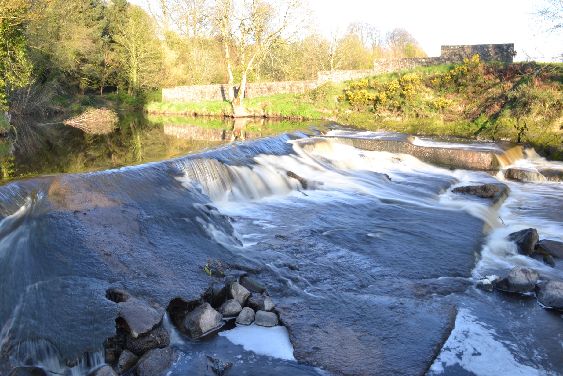

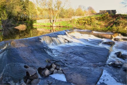

I headed out this evening at 7 pm with my D3100 in lovely evening sunshine (odd for Northern Ireland) to try out some shutter priority shots at the local salmon weir, i.e. weir, tree reflecting on pool above weir, lovely blue sky behind (approx 2/5 of view). Used my 50mm f1.8 AF-S. Tried Auto to get indicative readings before going to manual. Selected 2 secs and highest F (22) at ISO 100. Guess what? Blown. I tried all sorts. Thing is if I moved below 2 secs the water would not blur so it had to stay. Could not reduce ISO. Camera would not give me more than f22 (though fleetingly I saw f35 which disappeared almost instantly. Changing to my kit lens 18-55 f4-5.6 saw a little improvement but the sky was so pale, tree and background greenery washed out even at 1/2 sec DSC_2562.jpgDSC_2546.jpg. I don't yet know enough to get into filters, nor do I know enough about Adobe (I have NX viewer2 and Gimp). What am I doing wrong. Big learning step here for me. Help would be appreciated. Do I need filters and if so which?

Camera Maker: NIKON CORPORATION
Camera Model: NIKON D3100
Image Date: 2012-04-12 18:06:12 (no TZ)
Focal Length: 18.0mm (35mm equivalent: 27mm)
Aperture: f/22.0
Exposure Time: 0.400 s (1/3)
ISO equiv: 100
Exposure Bias: -1.67 EV
Metering Mode: Matrix
Exposure: Manual
Exposure Mode: Manual
White Balance: Auto
Flash Fired: No
Orientation: Normal
Color Space: sRGB
GPS Coordinate: undefined, undefined
Software: Ver.1.01
seeing how you shot this looks like you were trying to soften the water? Show movement? Study up on HDR. (Google it) now sure what software you have or if you can do it.
Marcel
Happily retired
Way overexposed indeed. Your picture's exif shows .4 second @ f22 with an iso of 100. Now the sunny 16 rule would say that for a 100 iso you should be using 1/100 sec (.01 sec) at f16. Since you were at f22, you should have been around 1/50th sec which would be .02 sec. I noticed that you were on manual exposure. I think you did something wrong unless this was the result you were looking for. Was it?

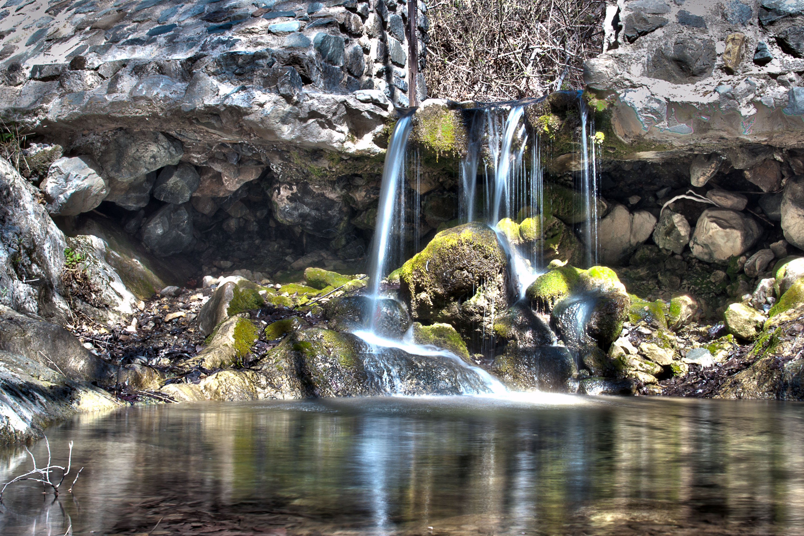

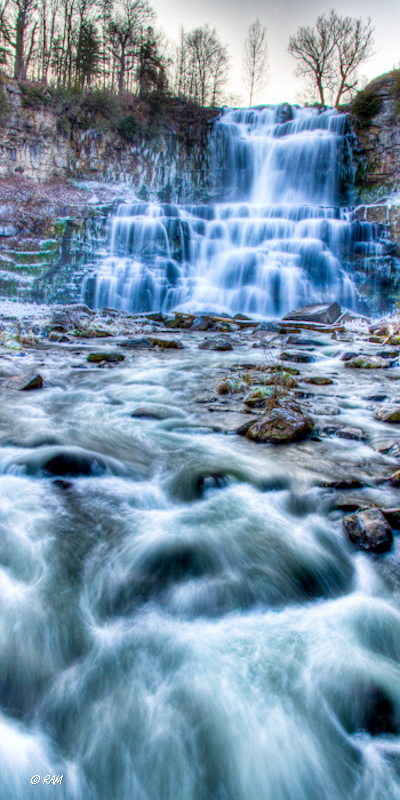

Just a ? If you bracket 3 or 4 shots and then HRD them what would the moving water come out like?

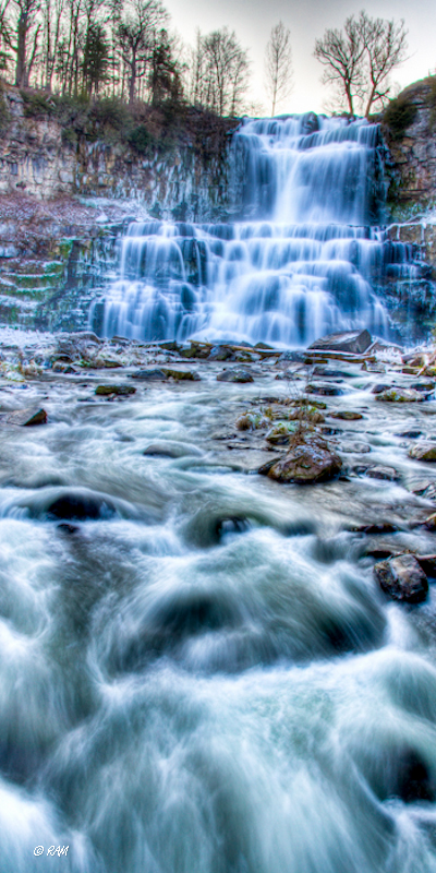

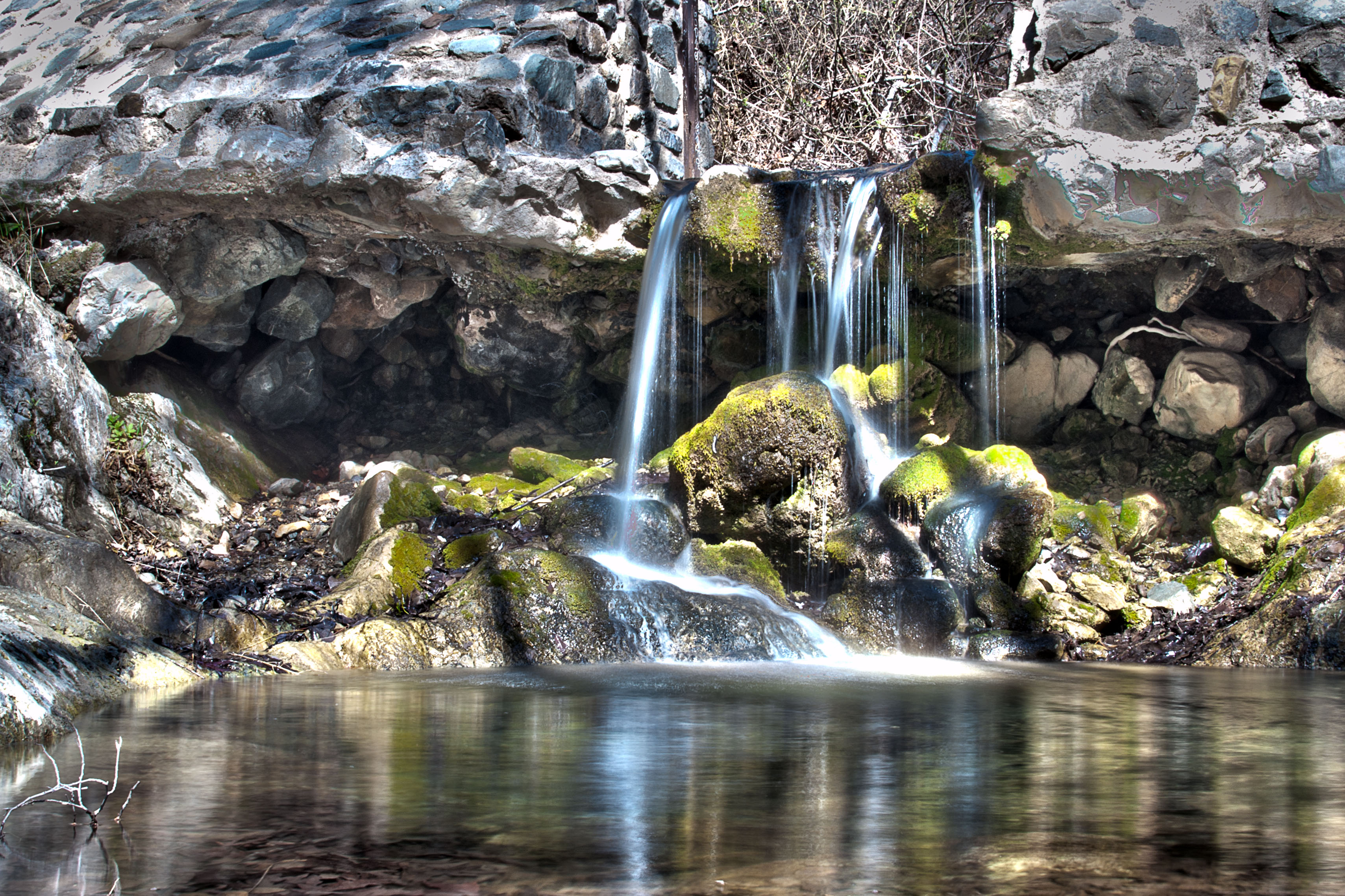

Here's one I did a while back , HDR waterfall, for example.
The first with slow shutter speeds, the second "normal" speeds

Now that does look real. Nice
Thanks! it was a lot of work to use the HDR and not have it come out looking surreal. But the tone range necessary to convey the image I saw necessitated the use of HDR. Unfortunately you can still see some halo on the rocks.
In some cases I really like the surreal look of HDR. I think Cnyram's second image is very nice.
