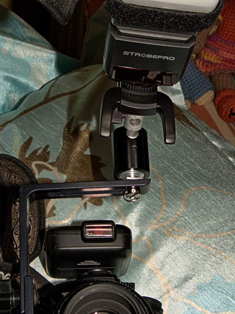

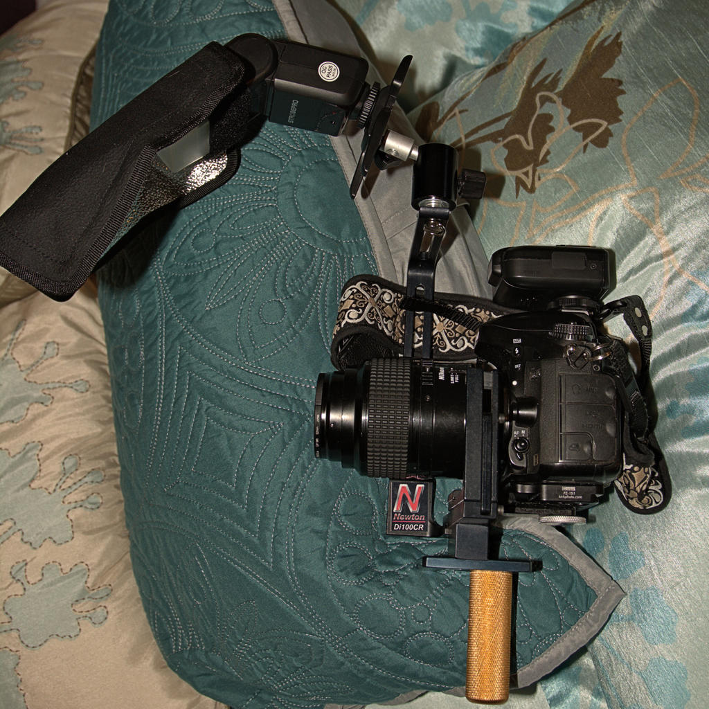

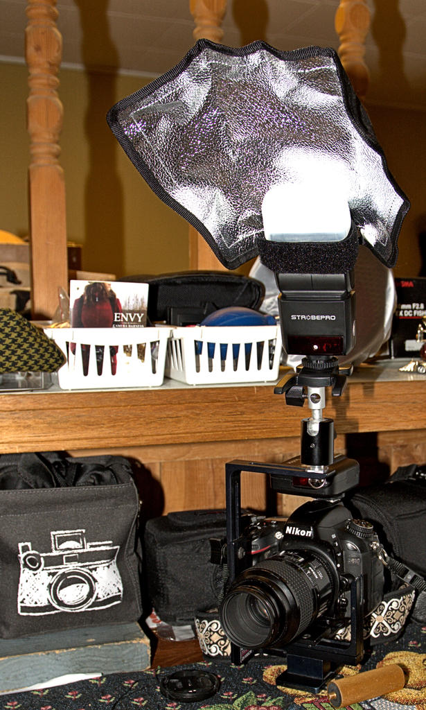

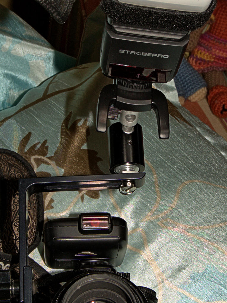

<blockquote data-quote="Fortkentdad" data-source="post: 630741" data-attributes="member: 24285"><p>Been playing around with flash modifiers and contraptions to get the light where I want it for macro photography.</p><p>Have tried the DIY Pringles Can (try it - worst case outcome is an increase in caloric consumption of 'potato' chips). </p><p>I did snoots with deflectors on the end. And a side arm bracket that worked but ... then I remembered a forgot 'must have" purchase I made a while back - a Newton Flash Bracket. </p><p></p><p>[ATTACH]262521[/ATTACH]</p><p> </p><p></p><p>B&H has them but special order: <a href="https://www.bhphotovideo.com/c/product/224818-REG/Newton_Camera_Brackets_DI100CR_Di100CR_Camera_Rotator_Bracket.html" target="_blank">https://www.bhphotovideo.com/c/product/224818-REG/Newton_Camera_Brackets_DI100CR_Di100CR_Camera_Rotator_Bracket.html</a></p><p></p><p>I then added a a ball head style umbrella / flash bracket </p><p></p><p> [ATTACH]262522[/ATTACH]</p><p></p><p>This allows me to mount the flash any which way I want - including straight out. The top image give the idea. </p><p>The bracket allows for portrait or landscape, and I found I could rotate the flash from straight up to straight out the one side - or any point in between ( in clock terms it could be at 12 or 3 or in between). Of course with the flash on a ball joint it can be moved to any angle and the head of the flash also turns and I'm using a bendable "Aurora Lightbank" flash bender to give direction to the flash. I put the diffuser - I should experiment with it on and off - and maybe even with a grid on the flash. </p><p></p><p>FYI I'm using a Godox TT350 (Canadian rebranded by Studiopro as the X35). It is a light weight flash - two AA batteries. But for macro work I found that I didn't even need it a 1/4 power. Cheap and good - what's not to like about this flash. I have larger flashes (and a smaller one if you count the Nikon SB400) - I went with light weight. I mounted a Godox X1 radio transmitter on the camera to control the flash. </p><p></p><p>[ATTACH]262523[/ATTACH]</p><p></p><p>I also put a brass grip on the bottom - because I had one and it was very handy grip to have. It has to be unscrewed to set the rig down in the upright position as is shown above. </p><p></p><p>I was very happy with how it handled and went out to take a few sample backyard shots. </p><p>I was playing around with manual settings - to lots of trial and many errors - be kind I'm not really that proficient with OCF al a manual mode. Didn't bring out the light meter to see what I should use - and played with HSS just for fun. I wanted to see what the flash would do. It was not dark out - but late evening sun. I was using a Nkkor AF-D 105 - no extensions tubes or magnification filter. </p><p></p><p>[ATTACH]262524[/ATTACH][ATTACH]262525[/ATTACH][ATTACH]262526[/ATTACH][ATTACH]262527[/ATTACH]</p></blockquote><p></p>
