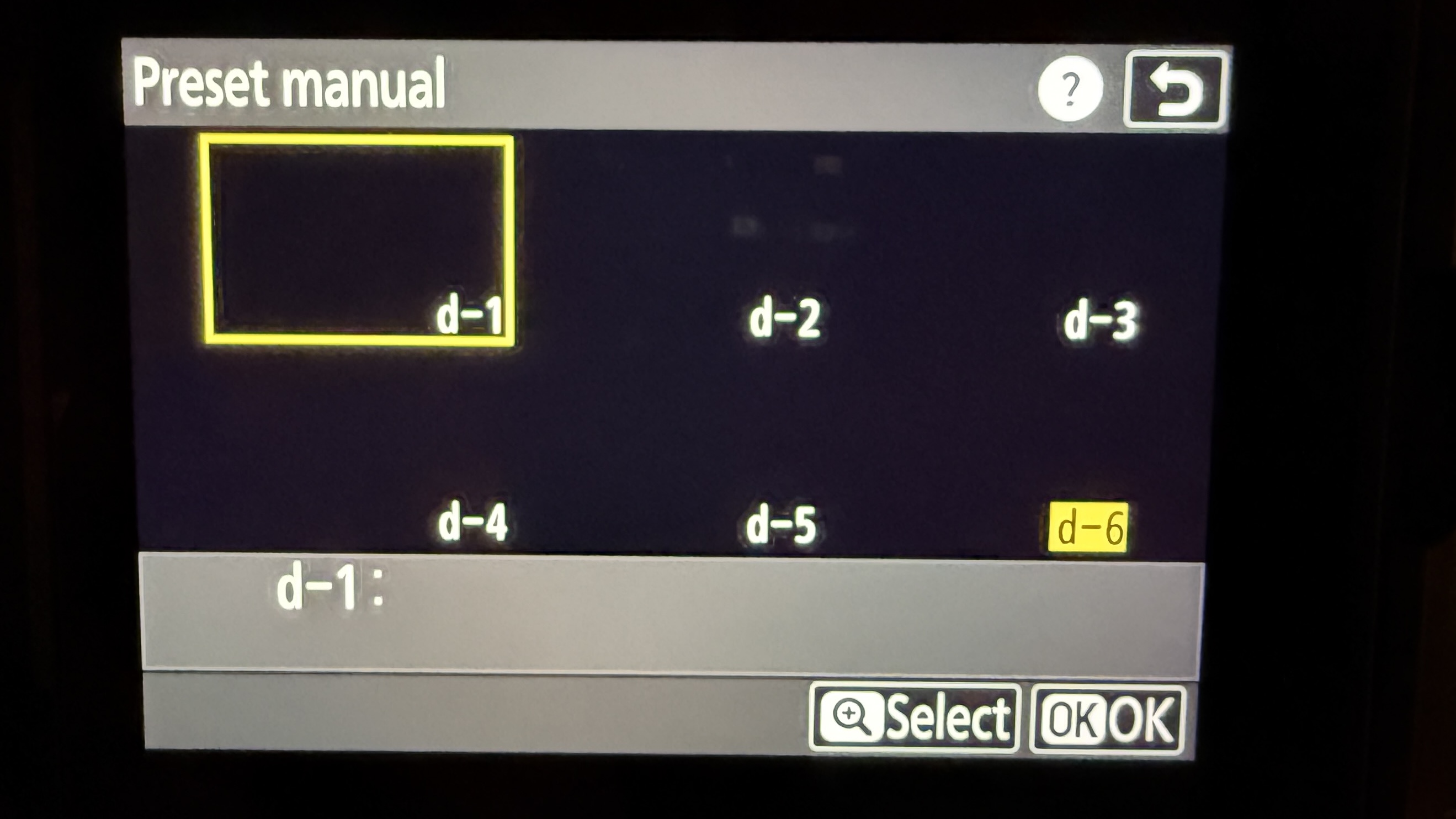

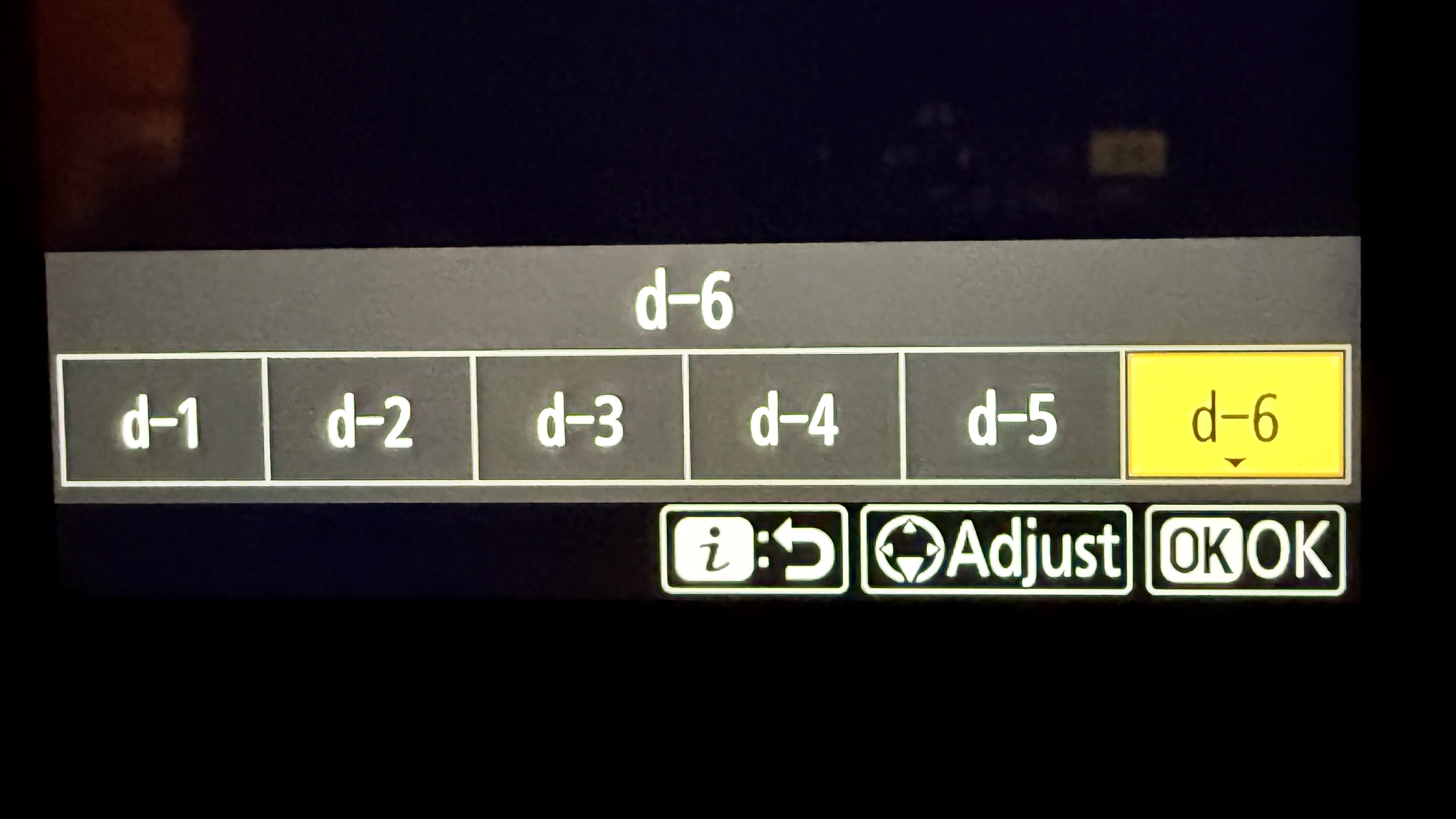

Hope somebody here can help. I have a brand new four day old Z6lll.
Been going through all the menus, customizing my settings and button functions. And now I’m trying to record a custom white balance, but there is no option to record a new setting.
I can access all the slots “PRE – 1 – 6“ , but there’s no option to record a new WB.
I’ve tried going through the main shooting menu to White Balance, I’ve tried assigning one of the custom buttons on the body and also I have it in the “info“ menu, and all of them will show me the presets, but not give me the option to record a new one
Maybe I messed something up when customizing my settings? I have scoured the Internet and every tutorial says the same thing and there should be an option to record a new point, but there isn’t…
Also when getting to the presets I’ve tried holding down the OK button, and every other button on the camera. No dice.
Coming from 22 yrs of Nikon DSLR’s, and am not a newbie…. Just new to mirrorless.

Thanks. It is what I’m looking for- but it’s not working.
As I said, I’ve been making a lot of changes to the stock settings trying to get to a base working setting for User-1,2,3.
Perhaps made a change that’s not allowing or showing the manual measurements?
At the moment my WB is set on Fn2. -the lower button- on front of body. Can’t imagine that make a difference though.
