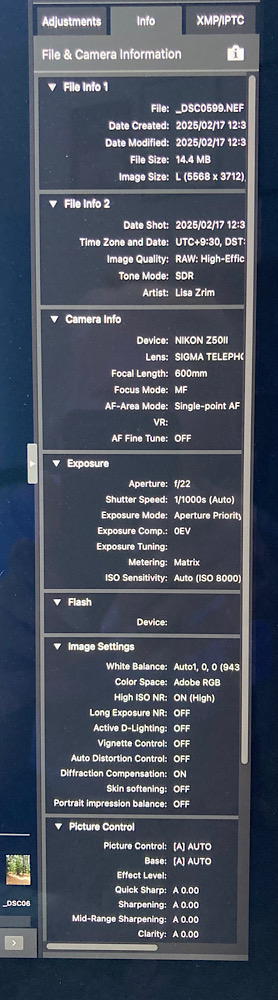

EDIT: I just looked up that Urth adapter. It does not have the electrical contacts for lens autofocus or aperture adjustment. Your photos are turning out exactly as I would expect with no autofocus or aperture control being used. Ditch the Urth and buy a Nikon adapter. It will work. At least it was the least expensive thing that caused your grief.
