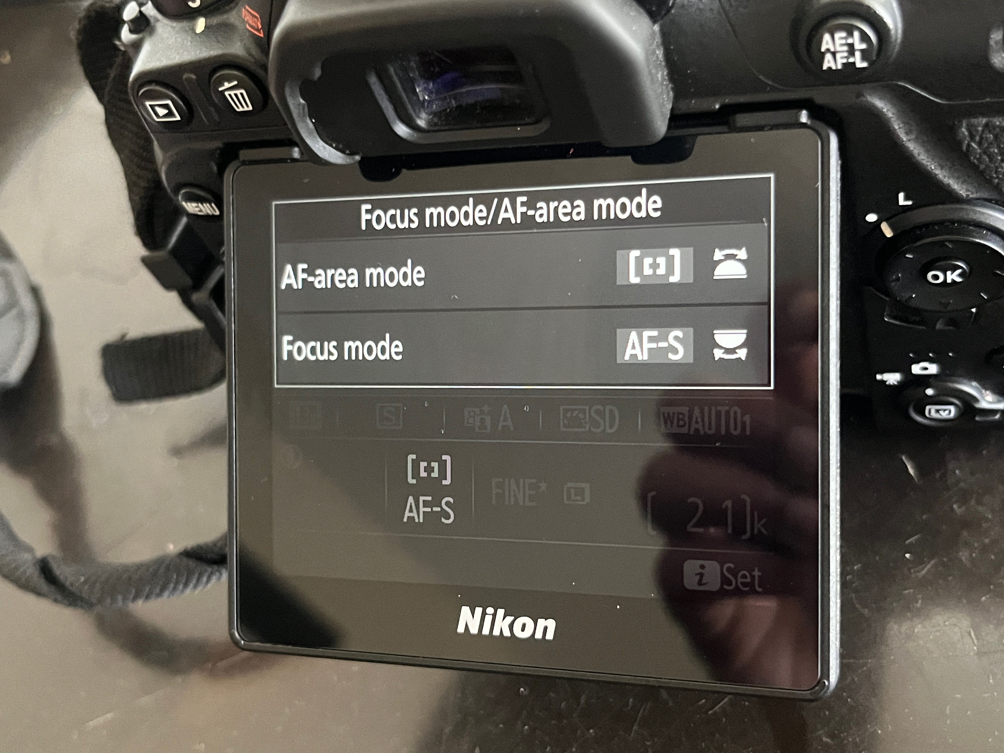

Nikon D7500 stuck on "Focus mode/AF-area mode" screen. Any help please.
Sreehariavikkal
It's stuck in this screen and no other buttons are working including menu. I am able to take photos, but can't see it.
The greens reset buttons are irresponsive, tried removing battery, charging it and turned on/off several time. Any help please? Thanks in advance!

Have you checked that there are no switches stuck in between positions? There could be some gunk built up under a button preventing any other input from another button press. You could carefully swab some alcohol around the buttons with a qtip, (I'd start with the focus mode button) to try to ungunk a stuck button, just be careful not to use too much alcohol or pressure. Afterwards, give each button a press and roll with your finger, allowing the button to snap back with the idea the button will unstuck itself from its bottomed out position.

Yes, I have tried as per your instructions and still not working🙃. I am able to look through view finder and focus and click. But nothing else works. Thank you for trying to help man
