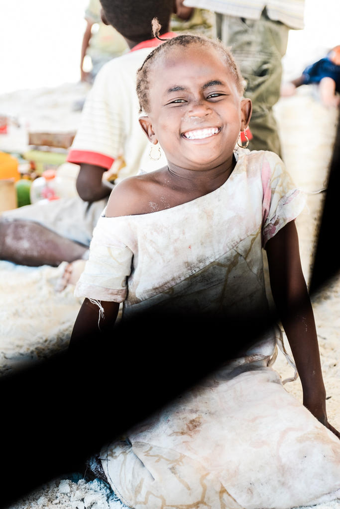

I have the same problem, "Err" message blinking, tried almost everything, seems pretty bad :(
I can see the photos in the card, the battery seems fine, the mirror is not stuck and seems to be shooting fine, maybe with a slightly different sound??
No photos are recorded though and I cannot change settings with the commands on the camera, but only through the menu...
This is the last photo the camera shot before refusing to respond anymore:
Can anyone make a better diagnosis?? thanks for your time!

Thank you so much birdseye, didn't even think about the shutter! I suppose shutter is better than sensor? do you think I might have any chance of getting it checked/fixed anywhere in on this planet? thanks!
Thank you so much birdseye, didn't even think about the shutter! I suppose shutter is better than sensor? do you think I might have any chance of getting it checked/fixed anywhere in on this planet? thanks![/QUOTE
Do you know what the shutter count is on the camera? Take your last photo shot and upload it to this site. Camera Shutter Count
To get it repaired you will need to send it off to Nikon
The shutter going out is much better than the sensor going out, yes. Having the shutter box replaced will set you back somewhere in the neighborhood $350 if you send it to Nikon for repair, but any camera shop that does repair work can handle this for you.
