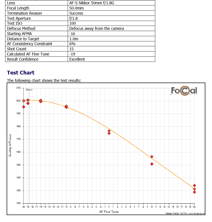

Nikkor 50mm 1.8G Fine Tune Report
Bourbon Neat
Has anyone else run their 50 through FoCal? Minus 19 on the D700 seems extreme.

Already have done the aperture test with the D700 and 50mm. The results look good to me with a broad premium plateau rather than a peak. That report is posted here: http://nikonites.com/general-lenses/31236-post-your-focal-reports.html
Looking at the above graph, that is acceptable to me while being a bit extreme to one end. The curve is smooth and then just at -20 it takes a dip. From that i am assuming the tuning came in for the lens and body combination, a very close call whew.
As [MENTION=13090]Horoscope Fish[/MENTION] stated above "All the lenses I ran through FoCal had adjustments in the single digits such as +5, -7 or what have you." When checking the comparison with all uploaded results, the 50mm was bunched together from -5 to +5 with an exception on each end. My other lenses calibrated with Focal were in the single digit catergory.
Anyone have a clue to the numbering system of the Quality of Focus?
