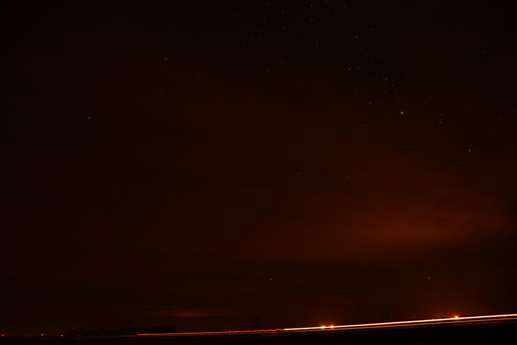

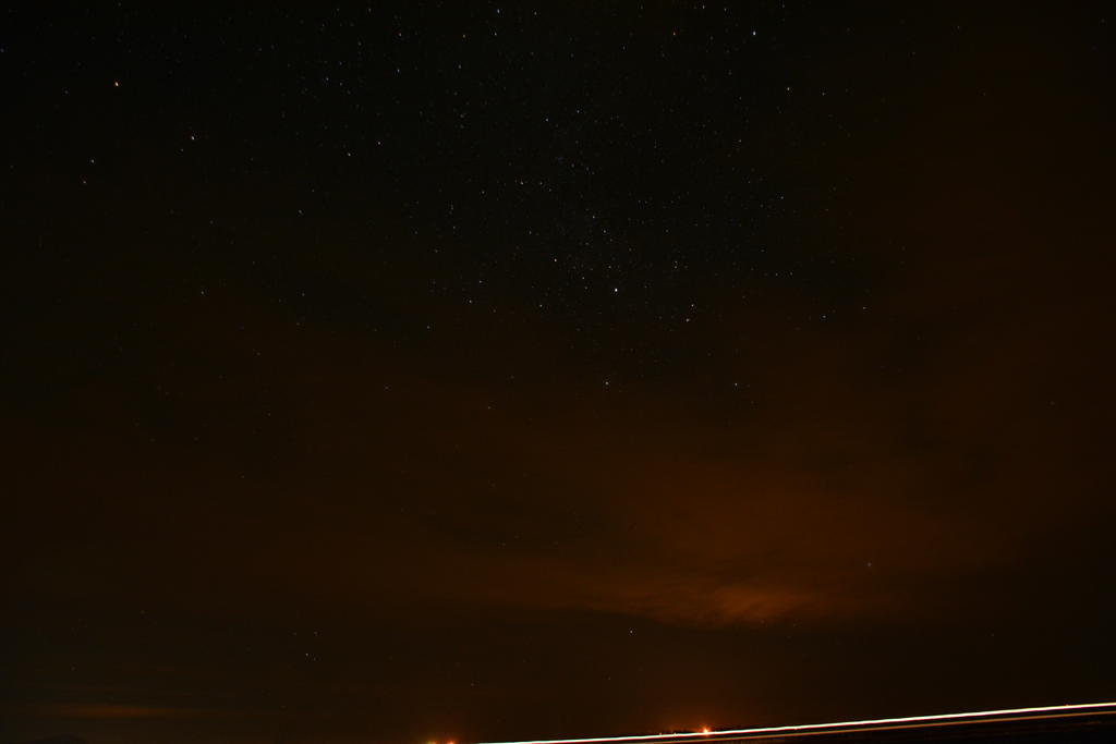

Just a quick question, I took some night sky pictures a few days ago and it was all good but today, without changing any settings, the pictures turned red-ish (please see below). Tried everything I know but it still looked the same way. I was using M mode, 25"/f4.0/600 ISO. All other settings were within the reasonable range, WB was in auto mode.
Not sure if the temperature was the issue, afterall it was only -5. Also it was even colder the last time I was out.
What could've caused this and what setting can I adjust to make it look normal?
thanks!
These are the red-ish photo from today, please see the normal picture from a few days earlier below

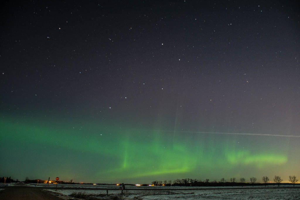

from few days earlier

The red you see in your pictures is caused by the city lights reflections in the clouds above. I suspect that for your northern lights picture there were no clouds and you were facing a different direction. Is that possible?
BackdoorArts
Like Marcel, I suspect ambient light pollution. Clouds and haze will bring out even minor ground lights when it may not be visible on clear nights.

Hi Marcel, thx for replying...when I took the northern light pic the sky was more clear indeed. but I've also taken some pictures with clouds in the sky in the same area, they didn't turn out to be red-ish...:confused:
Guan Yiming
thx for replying. Last night was no different than any other night (at least from what I saw with my eyes). I used to be even closer to city lights but never got this kind of red-ish pics...btw I was miles away from the nearest town.
Marcel
Happily retired
It's not the distance between you and the city that counts, it's the distance between the city and clouds. When the clouds are very high, even if you don't see them with the naked eyes, the city lights still is hitting on them and the camera captures it. The brain auto-corrects the color cast of the clouds, but the camera can't.
