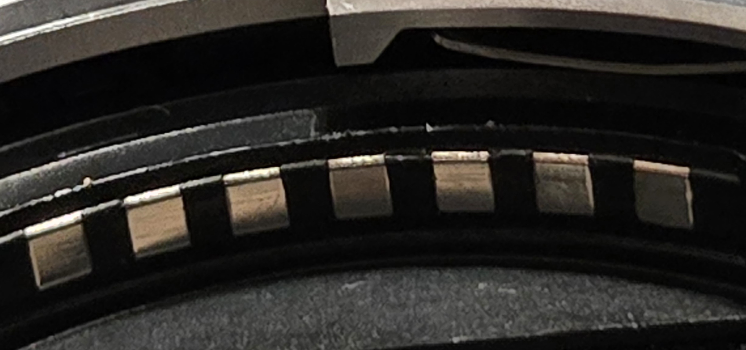

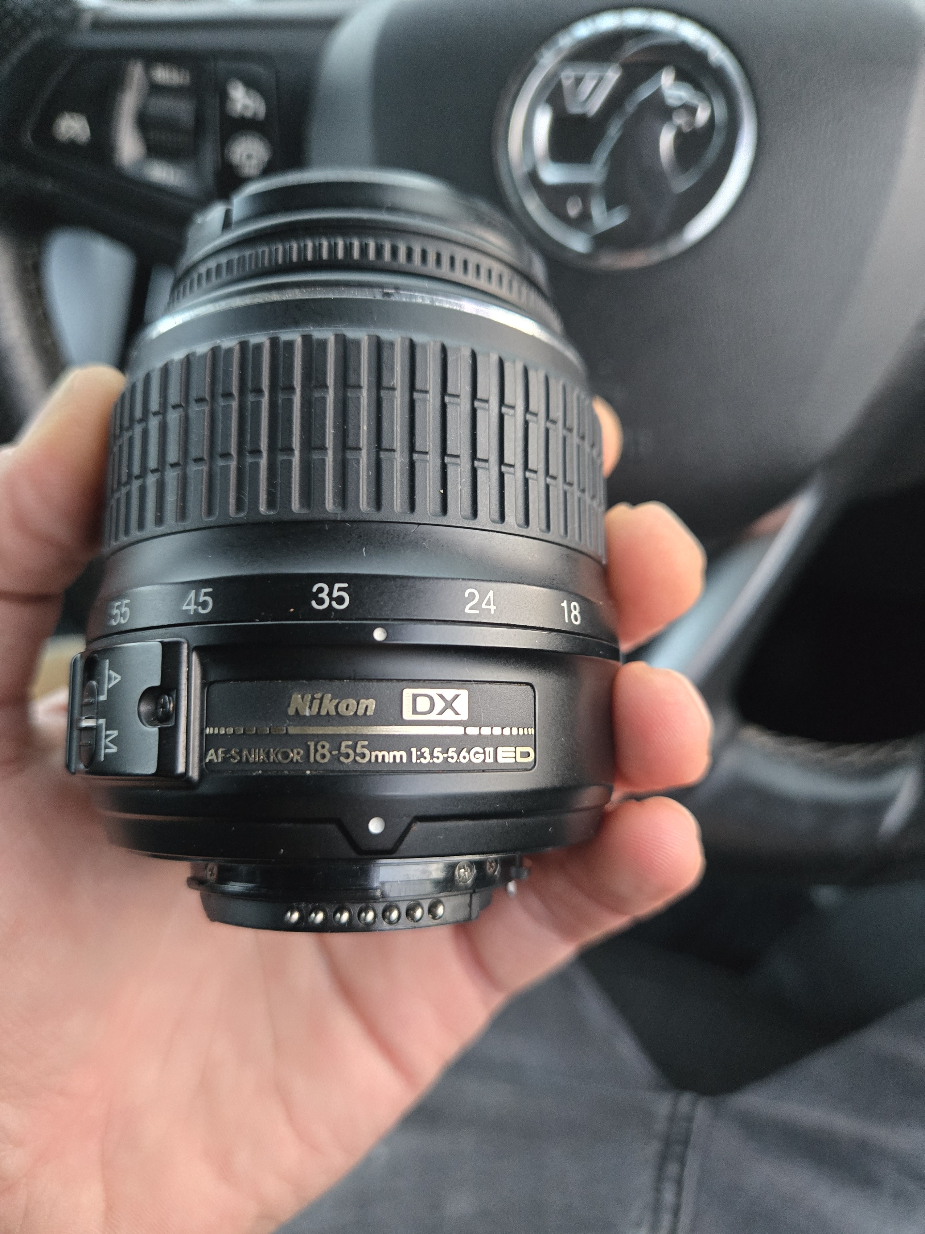

I would appreciate a bit of help with my camera. D5100 I purchased the camera body in perfect working order however the seller said that the camera would only work in manual mode. I suspected from the description that he was unsure even if he had the correct lens in the first place. I took a gamble and received the camera without any lens however he included two nikon batteries and charger. I purchased a lens witch I assume is compatible to make things work in auto. Don't get me wrong manual is a good thing to make me learn photography in general and the camera does indeed work manually with this lens. But for some reason or another I get an error message saying lens not attached. I understand the reasons why it comes up with this error.. the lens or camera can not communicate to each other. So how does one go about sorting out this issue 🤔 . I've tried cleaning the contacts on the camera and lens and they look perfect to me. However to my untrained eye maybe there could be issues. I've taken a photo of the lens to see if its compatible or not and the contact points in the camera. Any help would be Appreciated.

The lens is compatible. While it is possible to have two two lenses exhibit the same problem it is less likely the problem is with the lens. It is always worth a second attempt to clean the contacts. My preferred method is a couple drops of DeOxit on a micro-fiber towel.
If the same results are obtained try a two button reset by holding the I button with the menu button for 2 seconds these a usual red.

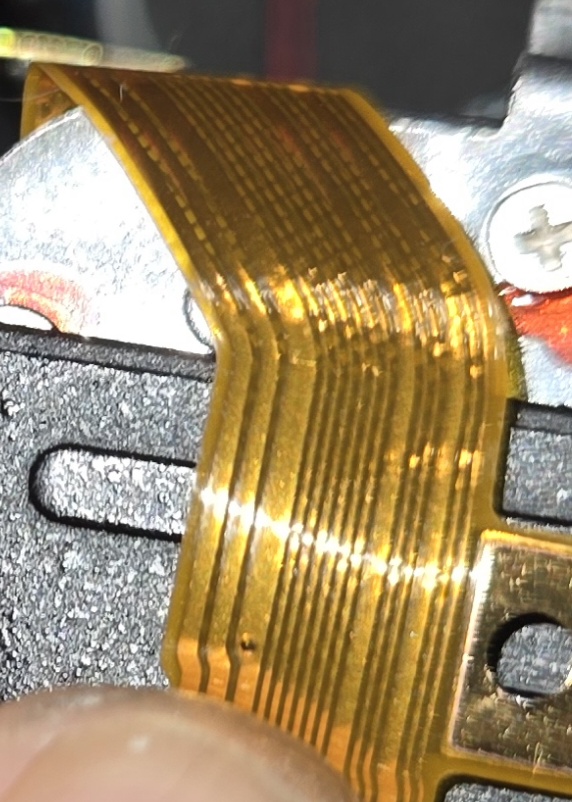

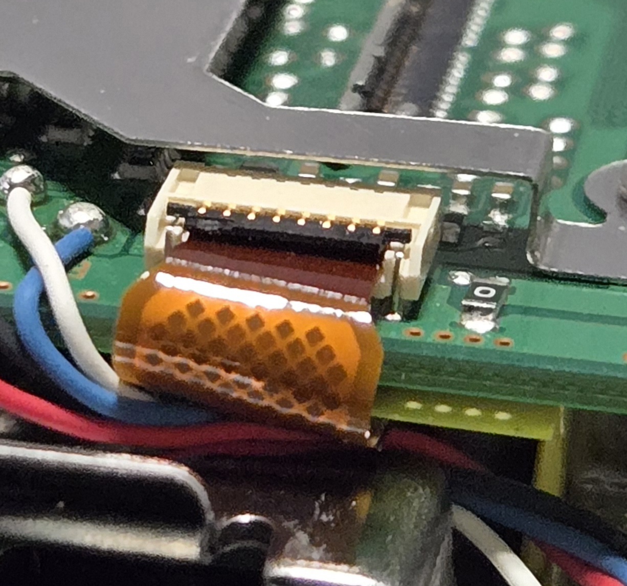

Just a tiny update... I took of the rear back of the camera this morning and discovered this ribbon flex cable. To me it looks like is not seated correctly and the wires below it are kind of sitting funny not allowing it to seat properly where it needs to be. Fingers crossed this could maybe sort out my problem.

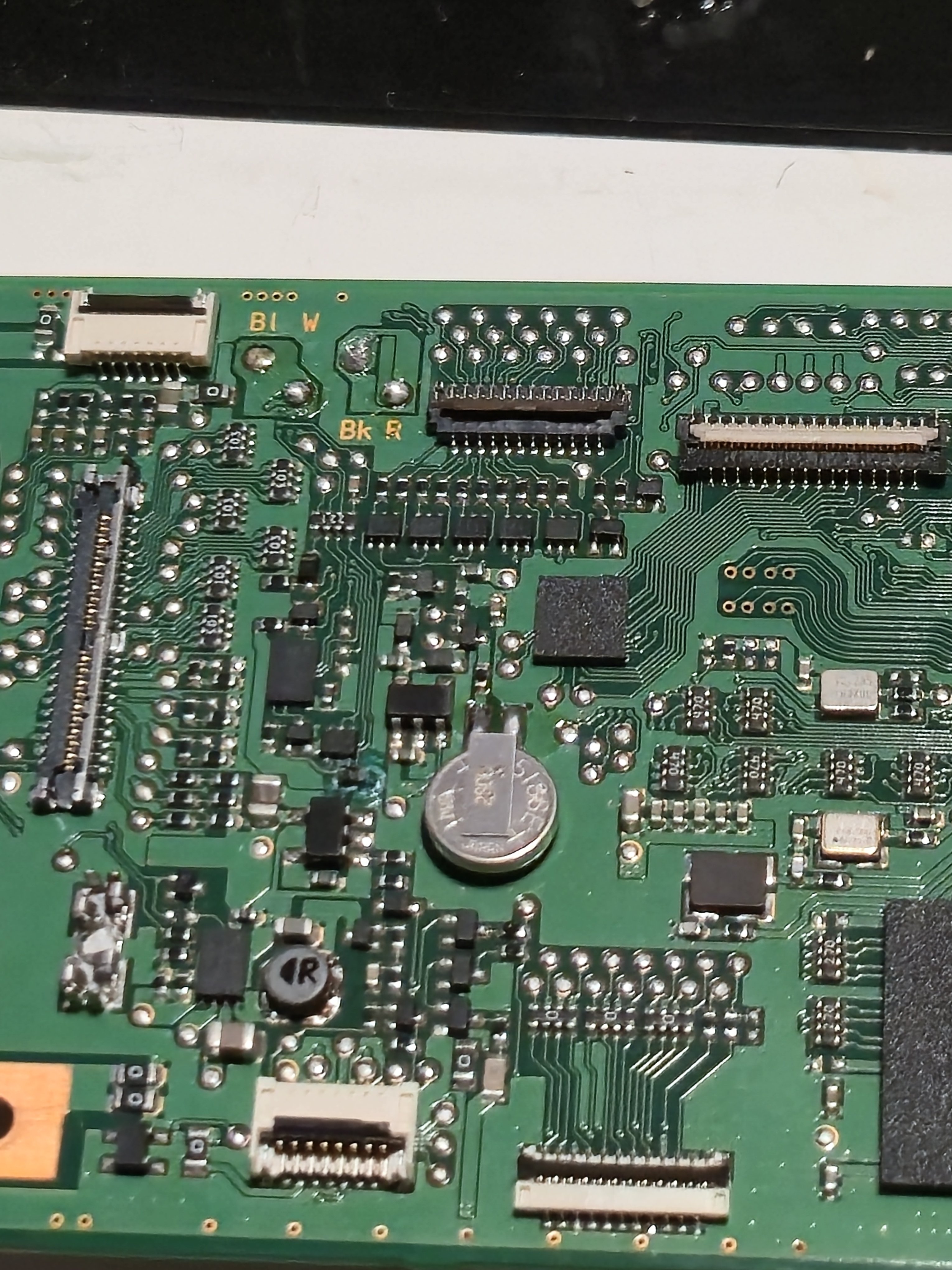

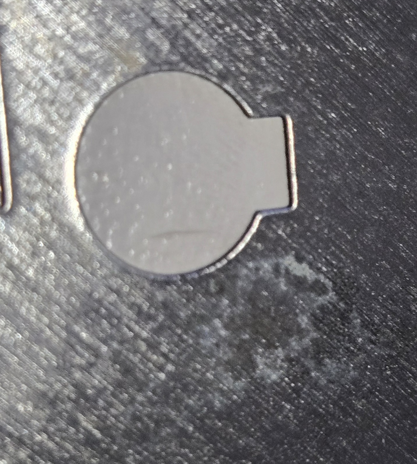

Well i now have discovered the problem. So as mentioned above I believed it to be the ribbon cable but it turns out whoever had this camera before me I suspect had tried to repair or replace something within the camera. And they have ended up creating a short near the internal battery on the main board. It's pretty easy to see what they had done. Picked up the body with a well placed thumb and squashed the metal protector to the main board. Crazy how there is no protection what so ever on the underside of that metal plate. Anyway I have now re assembled everything and it seams as though the colours on the lcd display are all weird colours now lol. But im putting that down to the faulty main board. Strange it was working correctly in the beginning though. Ohh well. New main board or just scrap it. If you look carefully you can probably see the capacitor thats gone near the battery. It was hard to get a close up. Anyways all I suppose this has been at least solved. However id like to keep the thread alive just so I can update it. Or someone else might have the same issue as I have had. And they you use and check my photos just for there checks if they choose to.

Take a chance, you win sometimes, you lose sometimes. Somebody else digging inside the body was not the top of my list of guesses.

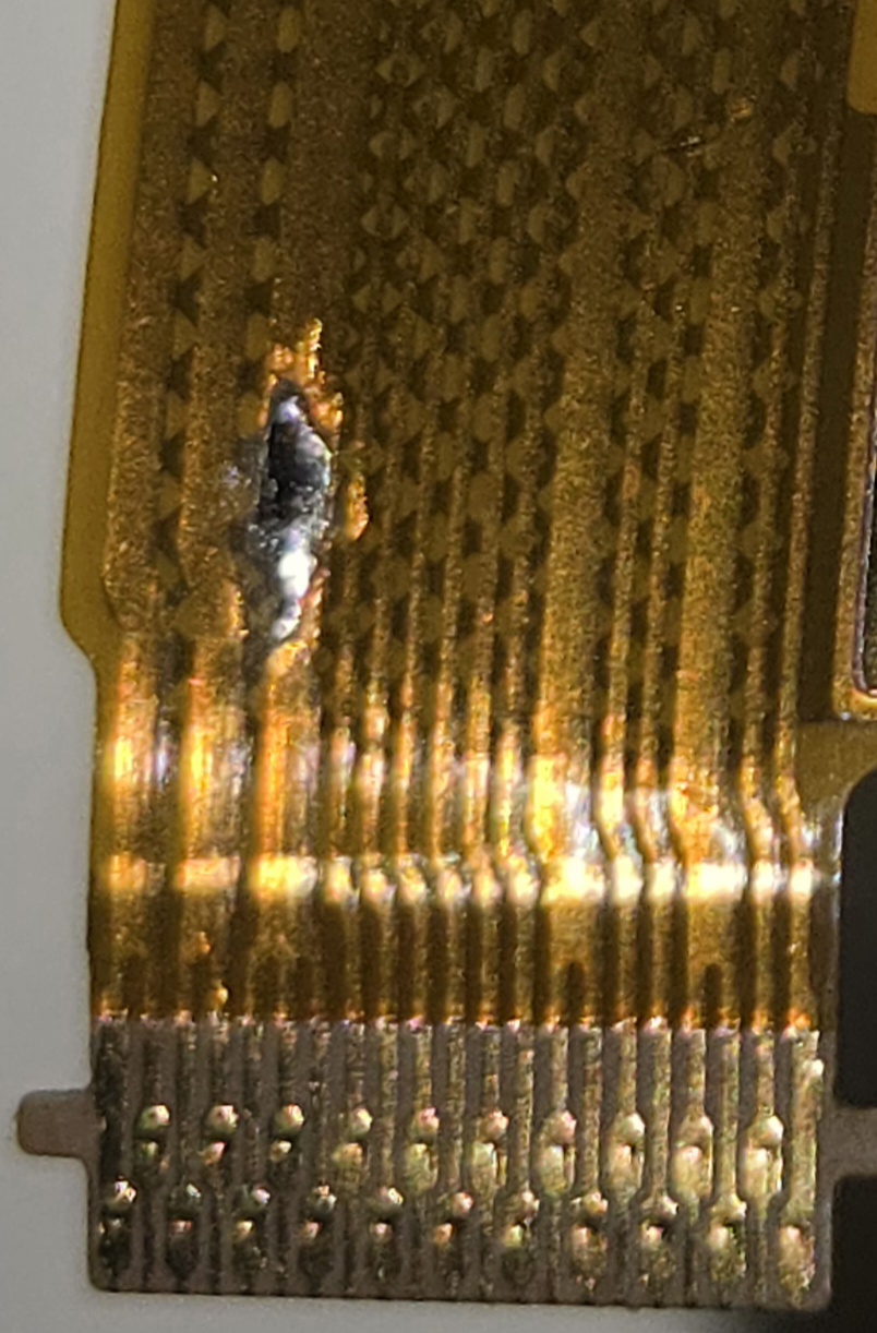

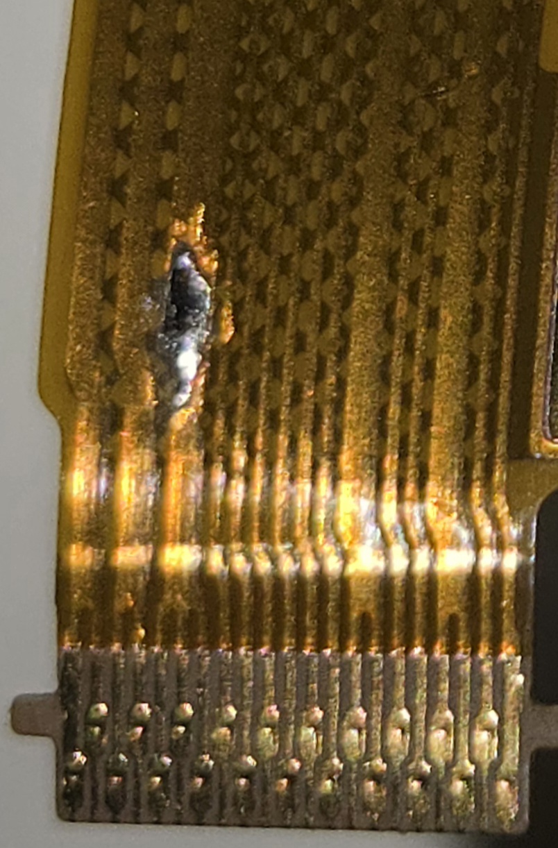

Just a bit of an update.. basically I have now fixed the camera. I had to buy a new mainboard and a new lcd hinge assembly and new led backlight. All total cost of parts came to £37. I also had to do a repair on the flex cable that connects to the lens assembly. There was a tiny hole that i suspect someone had put there trying to remove the cable before me. Luckily i saw it before assembling all the camera backtogethrr. But at least i now have a working camera without any lens not attached error and fully auto focuses. . Overall im now very happy.
