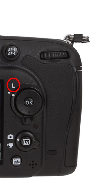

Try flipping the focus lock switch a few times as well; the one on the back of the camera attached to the "OK" button. You want this switch in the lower/dot position, not in "L" (Lock) mode, like you see in the picture.
I've inadvertently flipped this switch a few times, causing no end of confusion...

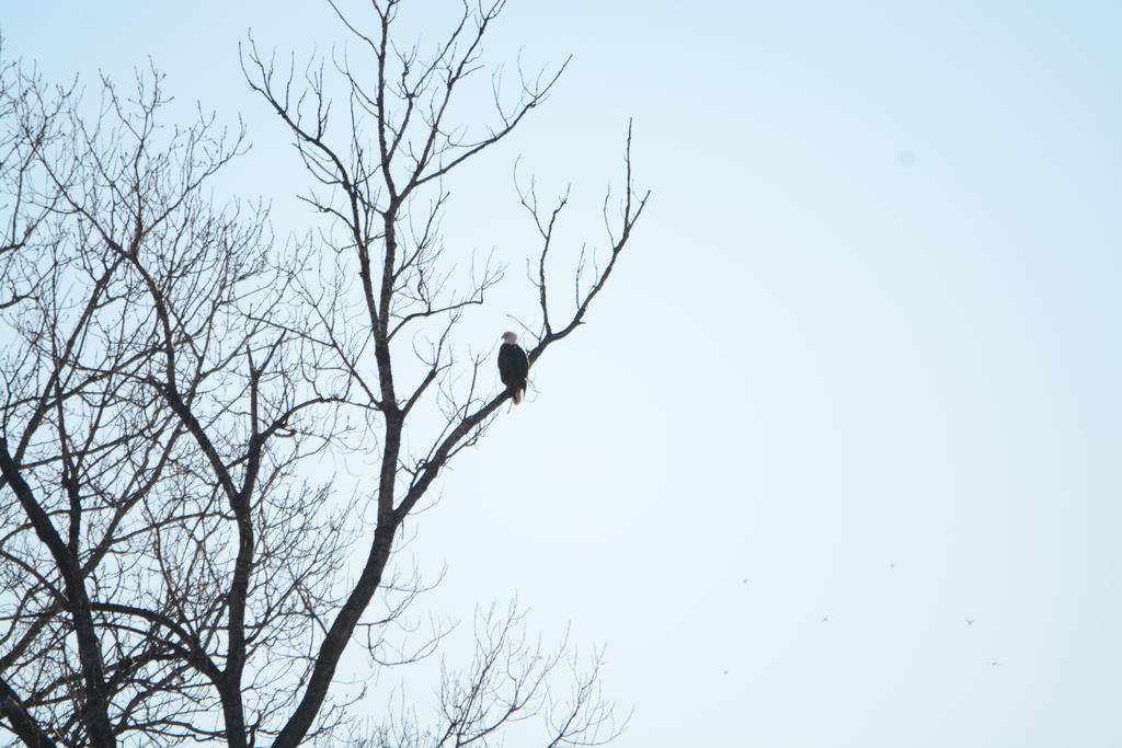

Close up pic was takin with D5200, with a Sigma 150-500 mm lens, f6.3, ss 1/320
Further away one is takin with D7100, same lens same settings. But it is just not acceptable.

Well the problem could be your lens, your camera body or, as is often the case, one of "pilot-error". The latter can be difficult for us to rule that out in a forum because we're not there in the same room with you. To help troubleshoot the issue I would suggest doing a reset on the camera and then try taking some very simple pictures, in good light, with the camera in full "Automatic". If you have a different lens you could try working with that would help as well.
We need to figure out where, exactly, the problem lies.

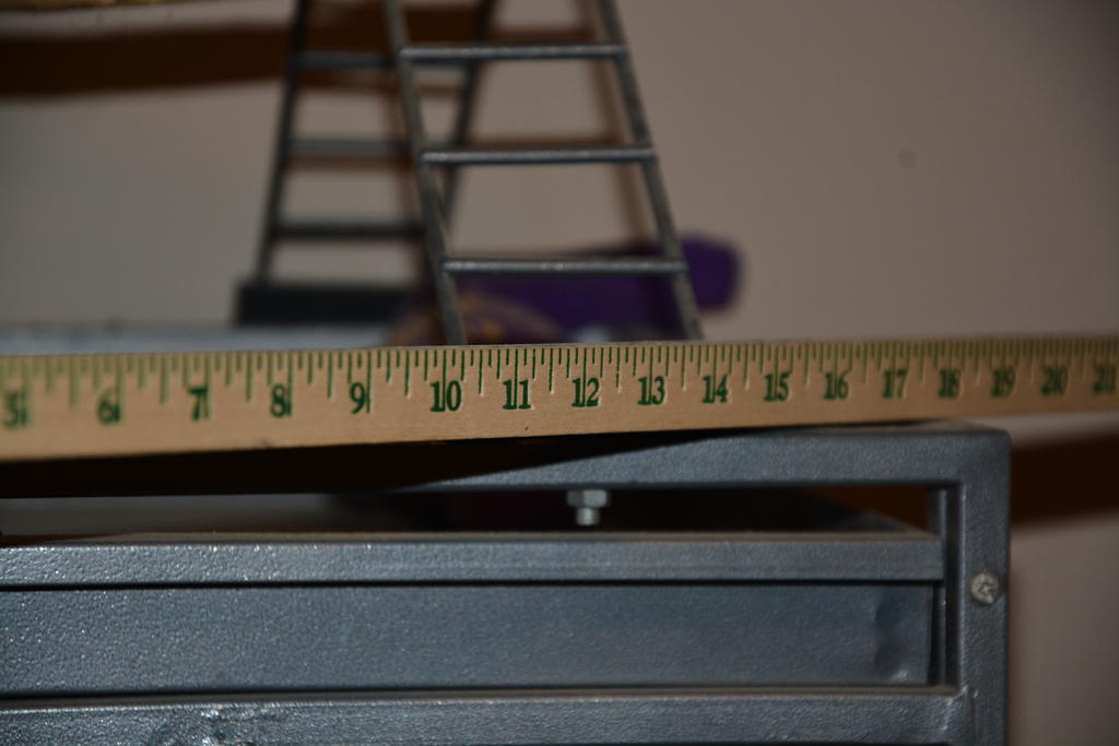

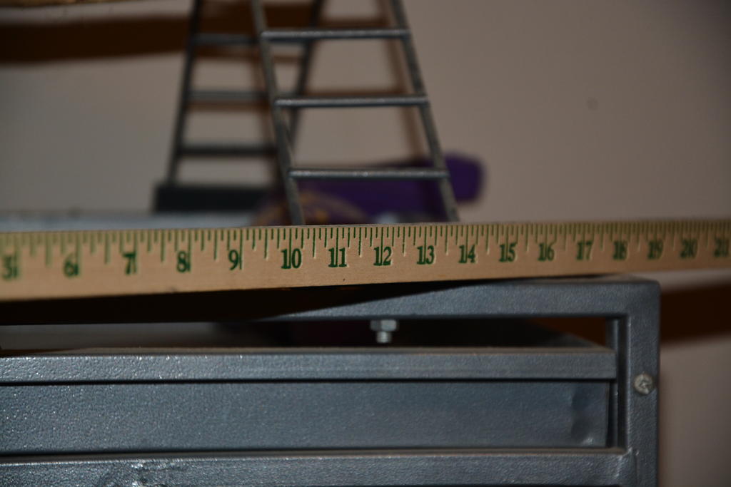

Here is one test photo.
I focused directly on the 12. To me it looks as if the focal point is more towards the 11 than the 12. Is this what you where speaking about the focus being back or forward focusing?
Horoscope Fish
Okay that shot looks pretty darn sharp to me and yes, front focusing and back focusing are just what they sound like; the point of sharp focus is in front of, or behind, the focus point used in the viewfinder.
Looking at this shot I agree in that you might, possibly, need to do a minor adjustment to your auto-focus for this lens. Maybe. The D7100 has a AF Fine Tune function in the Setup (Wrench icon) menu. This would be a VERY minor adjustment, however, and would not account for the fuzzy shots you posted earlier. The above shot, while it MAY show some slight front-focus, is still very sharp overall.
