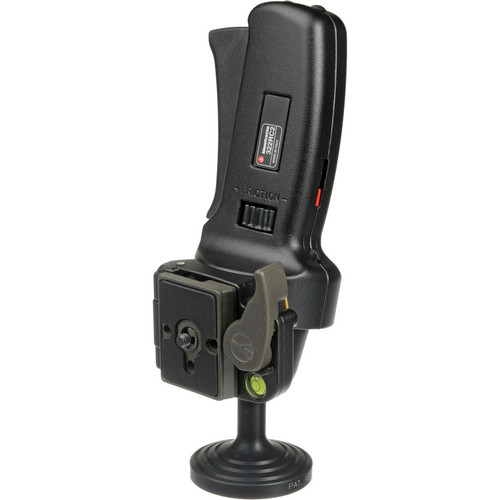

I HAVE 2 MONO-PODS MOUNTED WITH A MANFROTTO 322RC2 HEAD. I LOVE IT. MINE IS MOUNTED VERTICALLY.
The 322RC2 is unique in that it allows the camera mounting assembly to be positioned for left or right hand operation, in horizontal or vertical position, and in addition, will allow you to unblock, move, position and lock your camera with one hand in one position. This is due to the revolutionary design of its grip handle which incorporates the ball lock lever. The very act of taking your hand away from the grip locks the head into position, which eliminates the extra step of having to tighten a knob or lever before being ready to shoot. The tension of the ball can be adjusted to accommodate the load weight.
This head is not suitable for continuous tracking of moving subjects, it is not practical since one must always grip the lever to release the ball and thus your hand would tire after prolonged use.
An ideal head for action or wedding and portrait photographers.
Fast, one-handed positioning Customizable for left or right-handed use, horizontal or vertical Built-in bubble level Optional 322RA adapter or 341 Junior Elbow bracket allow camera to be centered over tripod in horizontal and vertical axes 1-DSC_4811.jpg
JUST PRESS THE TRIGGER AND YOU CAN GO FROM LANDSCAPE TO PORTRAIT SUPER FAST.

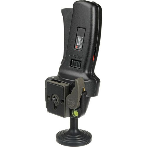

Fast, one-handed positioning Customizable for left or right-handed use, horizontal or vertical Built-in bubble level Optional 322RA adapter or 341 Junior Elbow bracket allow camera to be centered over tripod in horizontal and vertical axes View attachment 239594

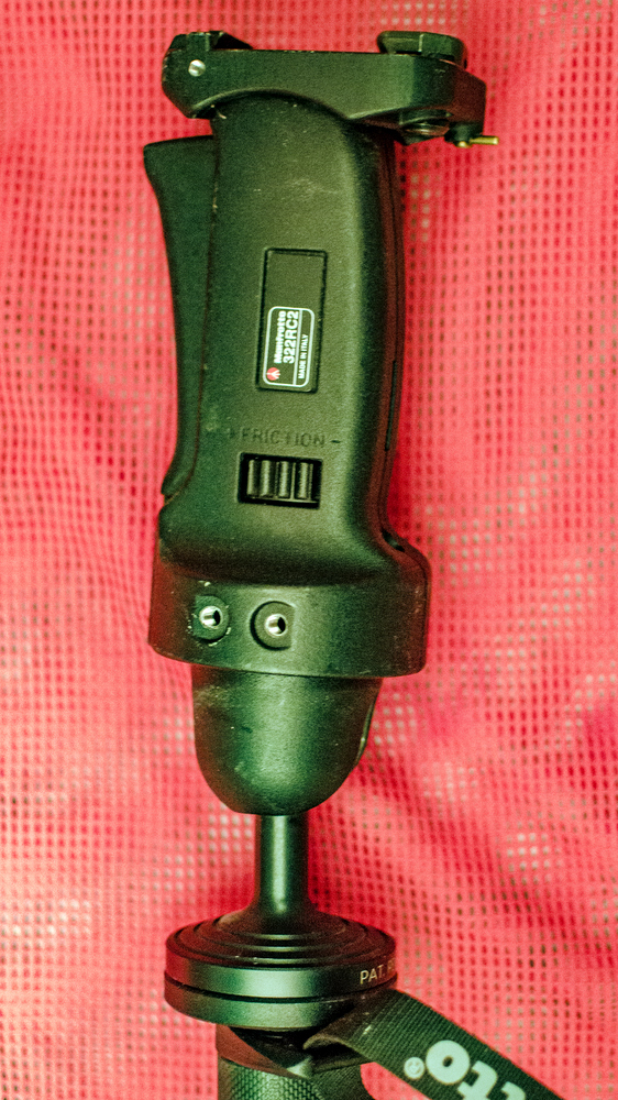

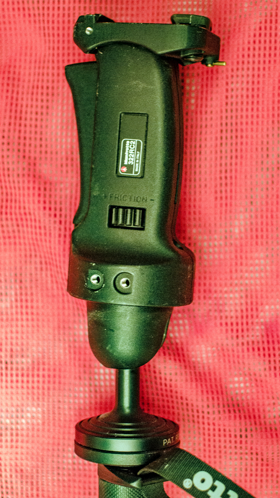

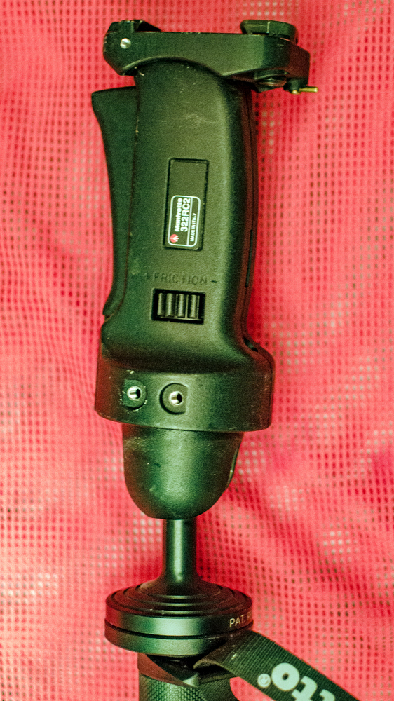

That kind of ballhead should work well. I didn't know they still made them with the one-handed grip. Is yours the same as this one? This one's plate is lower down on the grip. Yours looks like it is on the end. Or can the plate be moved?
nikonpup
yes, the plate can be moved. The plate is attached by 2 screws (plate has 6 screw holes for different mounting) the handle has 3 locations for mounting the plate. In my picture you can see the mounting holes
on the side.
