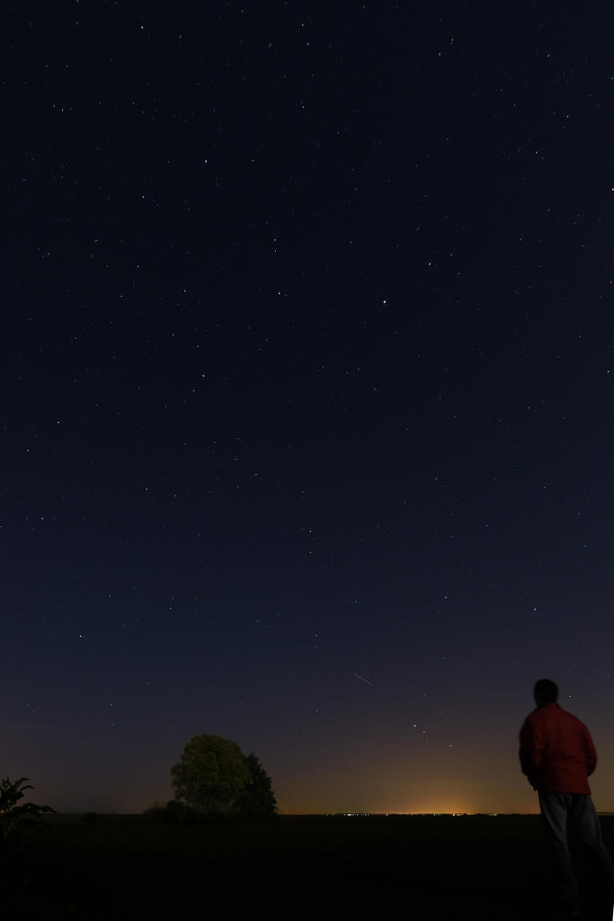

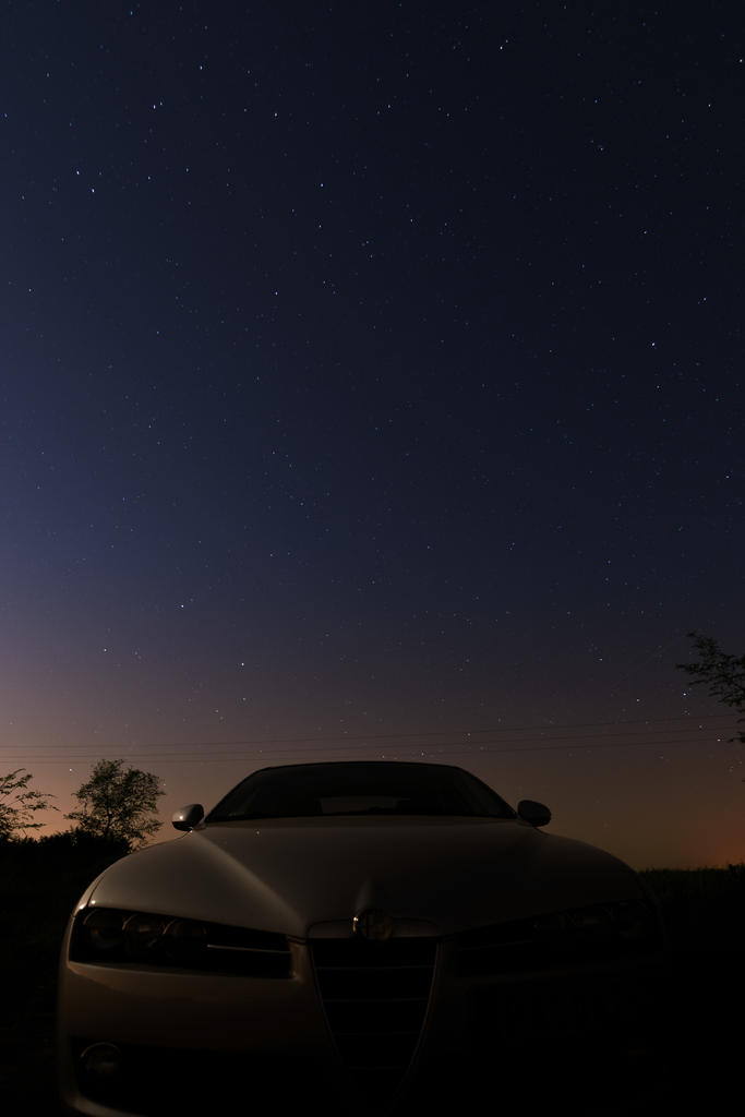

Somewhere in April I bought Tokina 11-16 f2.8 and soon after I made some night shots without planing, the Moon was high in the sky, there is light pollution everywhere, but somehow I was satisfied with results. These are some of my shots:

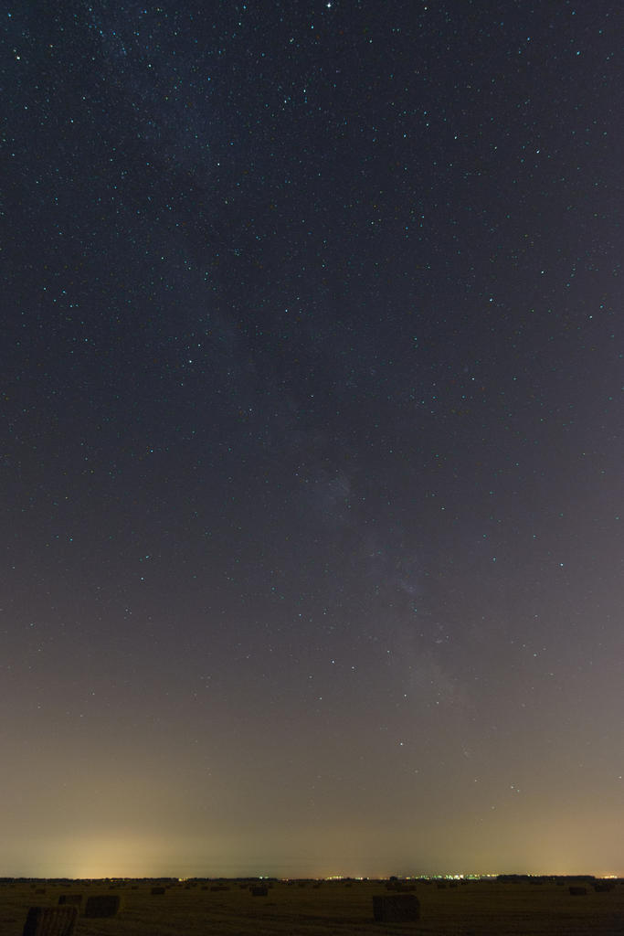

All in all I made some shots of Milky Way, but I am not satisfied. Here is one of my shots, raw file and processed one:
I would like to know what you think about it, is the original photo too faint, or my editing technique needs improvement?

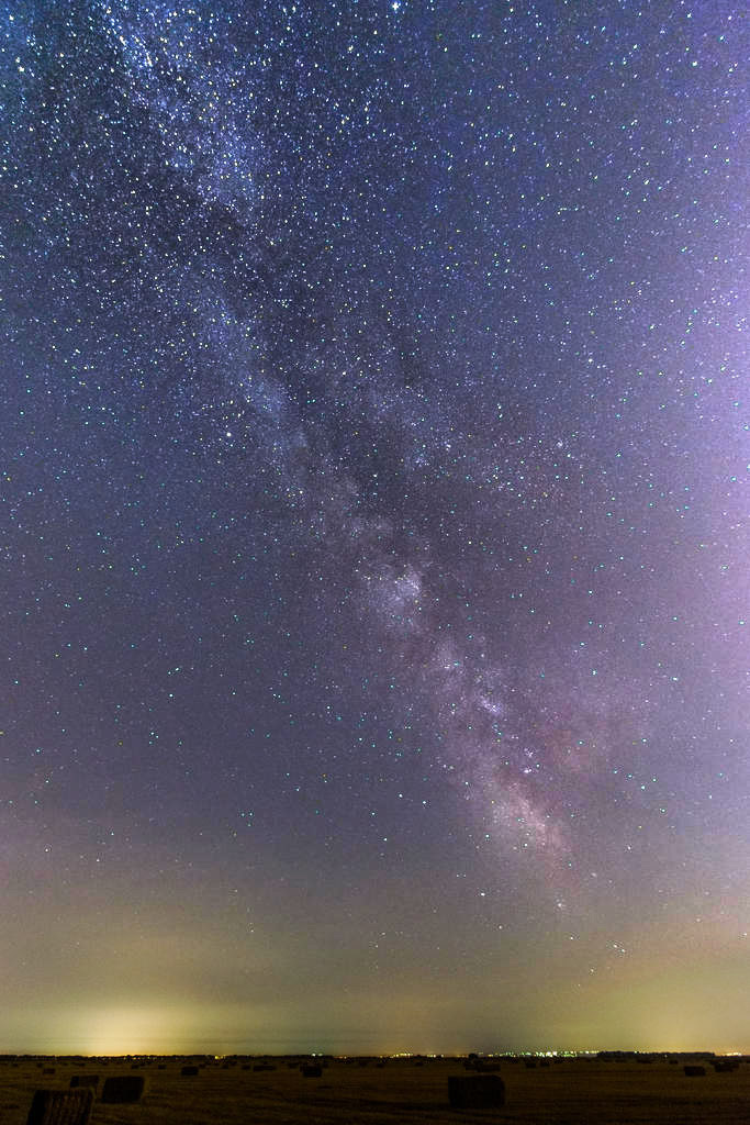

What I find is that when using blending modes in PS or any other program allowing such, that you can push it very easy.
Here I just copied the layer and used color dodge at 70% opacity. Don't pay attention to the bottom part, that needs more work than I invested into it. It's just to show you can push or pull it quite a bit by using blending modes:

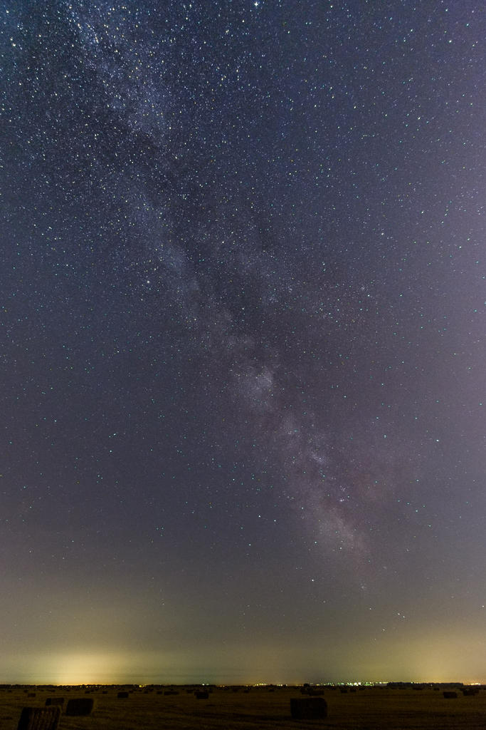

You can do better than me on the full image. It requires some work since you'll not only affect the milky way but the light pollution too. With a mask and different opacity erasing you'll get it tweaked as you desire.
