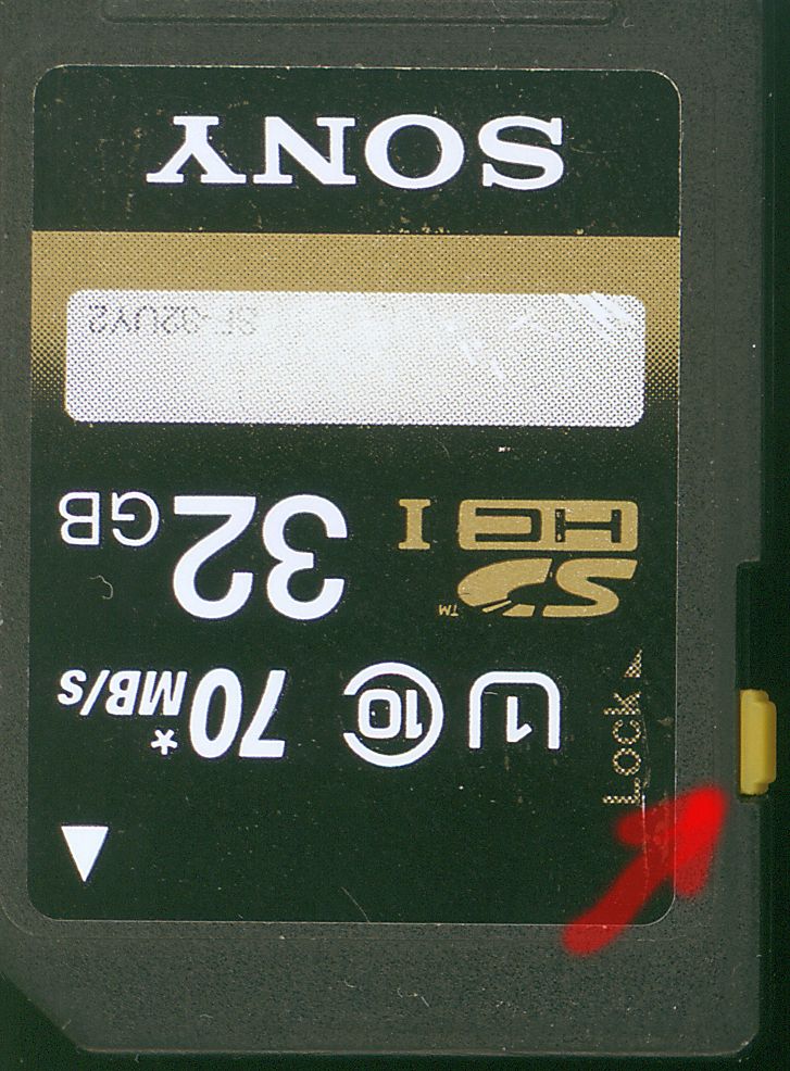

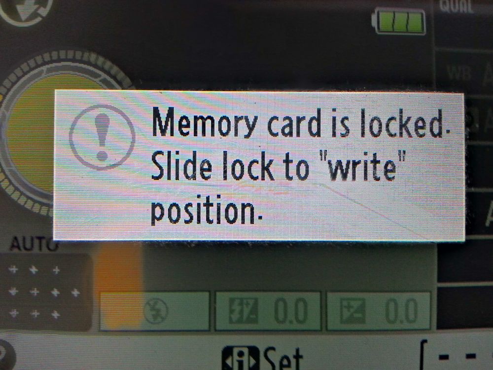

I have verified the behavior that I expect, with my D3200, that if I slide the write-protect slider on an SD card to the lock position, and insert it in my camera, I get the exact same result, albeit not in all caps.
I have to think that if you're getting this message, when you insert an SD card, even if the slider is not in the “lock” position, then the switch in your camera that detects the position of this slider must be damaged or malfunctioning. Perhaps there's some bit of foreign debris in the slot that is jamming that switch. I just tried looking into the slot in my own camera to see if I can see that switch, but I cannot. You might try carefully blowing out that slot with a rocket blower or some canned air. Definitely, make sure that the slider on your SD card is in the unlocked position. Unlocked is toward the contact end, the end that goes first into the camera.

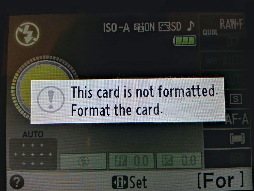

Formatting an SD card in my computer, in NTFS format, and then inserting it in my camera, gets me this message:
I think the problem has to be with the switch in the camera, that detects the position of the write-protect slider on the card.
