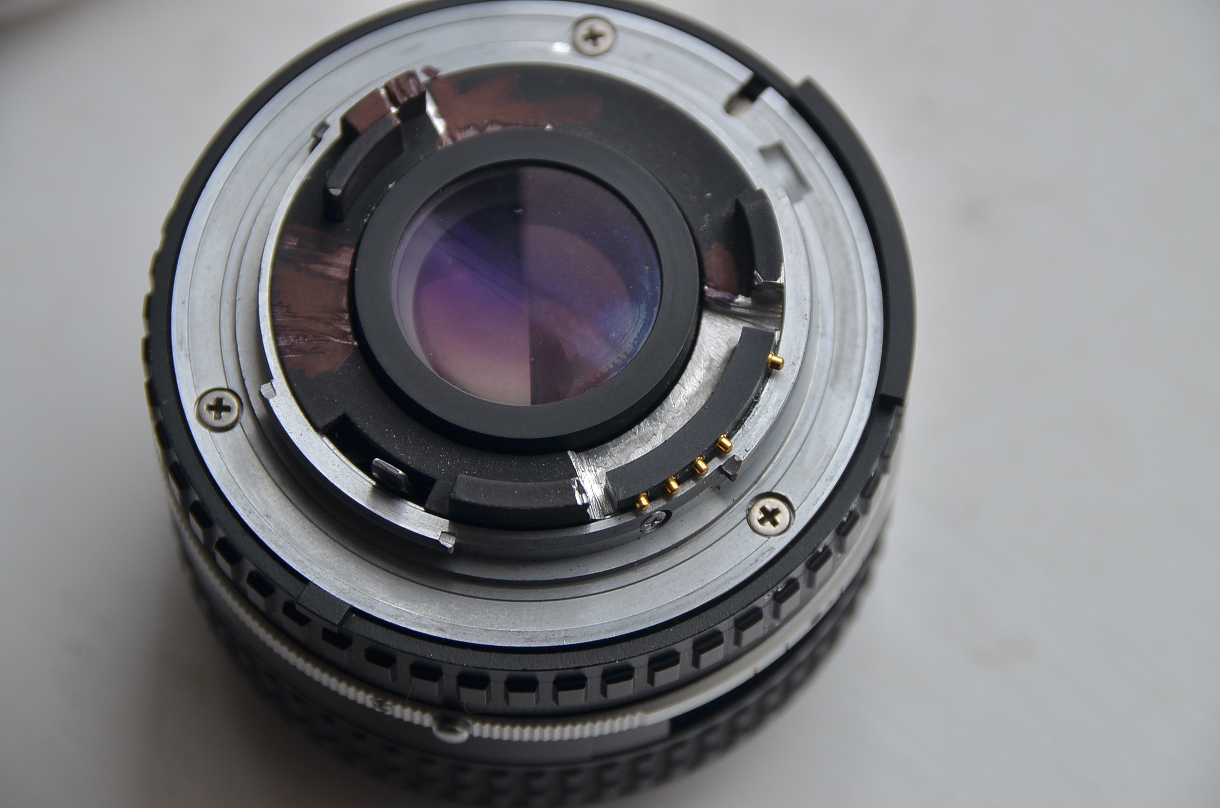

The only improvement you can make is to fit a CPU emulator then it will work in all modes APSM and the only thing left is to focus ...you can even set back focus on a camera that does not allow that ,....$30 ebay..you can see the pins in the photo below
