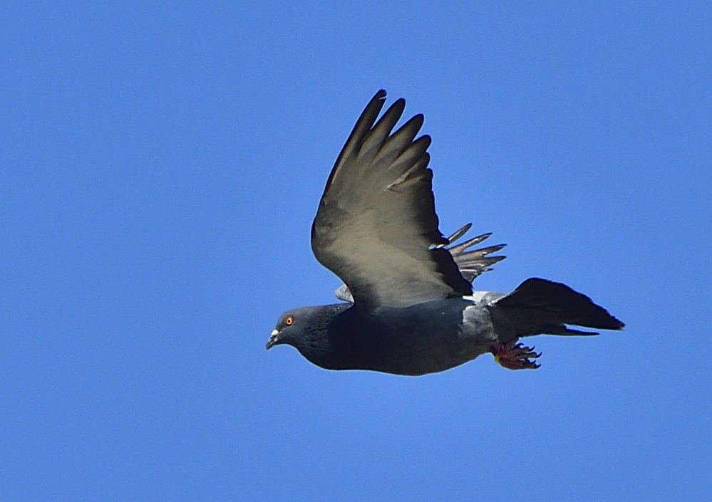

Roy1961
trying this to see what happens, i should have had my SS a little higher.
