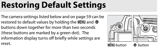

After purchasing a used camera it is a good idea to reset the defaults.
But I do believe that BF Hammer is correct that there is a cable issue going to the rear screen.
