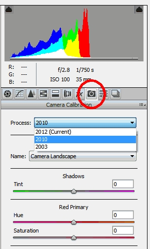

I'll just point out that those of us who use Adobe Camera RAW/Photoshop can also take advantage of this handy tip...
The required adjustment menu can be found under the "Camera Calibration" tab in ACR:

Can't you do the same by upping the shadows in the exposure part and then pull them up further in the curves section of LR?
I used gradients and brushes doing something similar with highlights since you can keep stacking them.
wornish
Just tried it and the answer is almost the same as using the 2010 process but not quite as powerful even if you have Basic shadows at 100% and Tone Curve shadows at 100%.
And of course you can use the adjustment brush and stack layers of increased exposure with no limit - until its all blown out white.
But I think the intent is to simply recover a shadow area beyond what the 2012 process version can do in a very simple way especially if you save the setting as a user preset you can see if its worth doing in one click.
I never tried it with shadows but with night shots when I had light pollution in my sky, I used to stack gradients killing the highlights.
Still, it's an easy trick they show in the video. I didn't even know I could go back to previous version.
