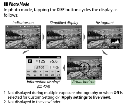

Title says it all. The level has disappeared from the Viewfinder. It's there on the LCD screen. Been through the menus and can't find how to bring it back.

A you talking about the virtual horizon?
CNP
Tried that half a dozen times with no success, before I posted here. Tried it again just now and it worked. Fresh battery so I've got no clues as to what was going on. Grid lines are OK but that VH feature lets you control both tip & tilt.
