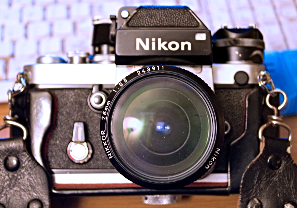

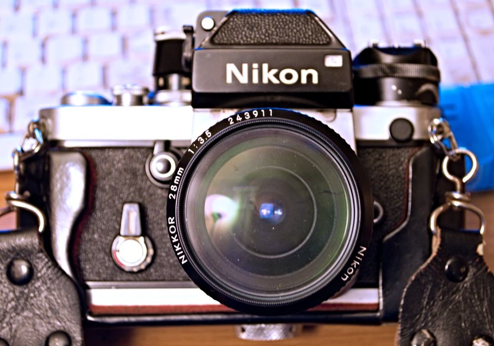

Also, it claims that “All Non-AI lenses have a letter after the word Nikkor, to tell the number of elements in the optical formula. For example, in the Nikkor-P 105mm f/2.5, the P stands for Penta, i.e. five elements.” Again, not true. That nomenclature was discontinued in 1974. AI didn't come out until 1977. My 28mm ƒ/3.5 Nikkor (Pictured below, mounted on my F2), which I believe to be from 1975, does not use this nomenclature.

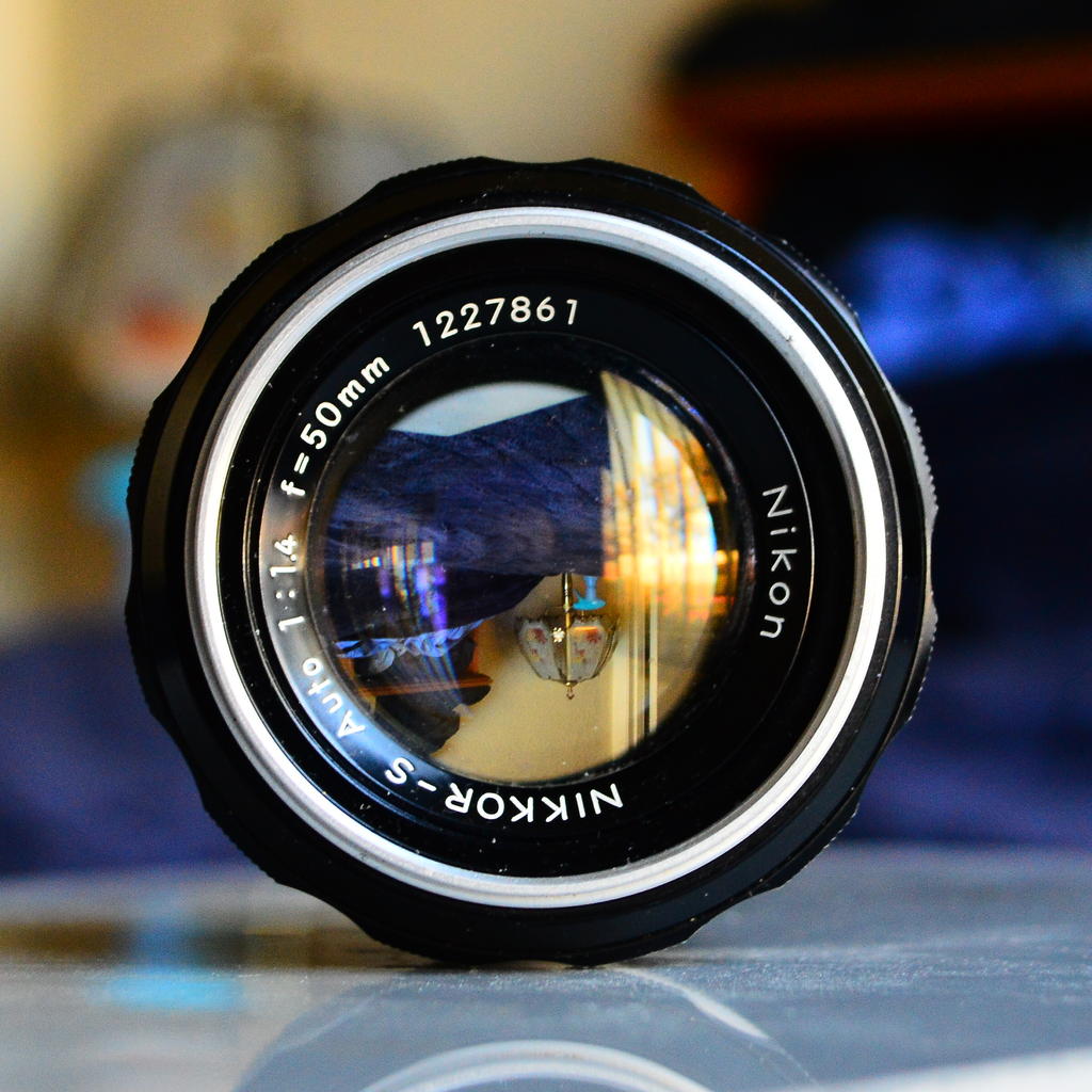

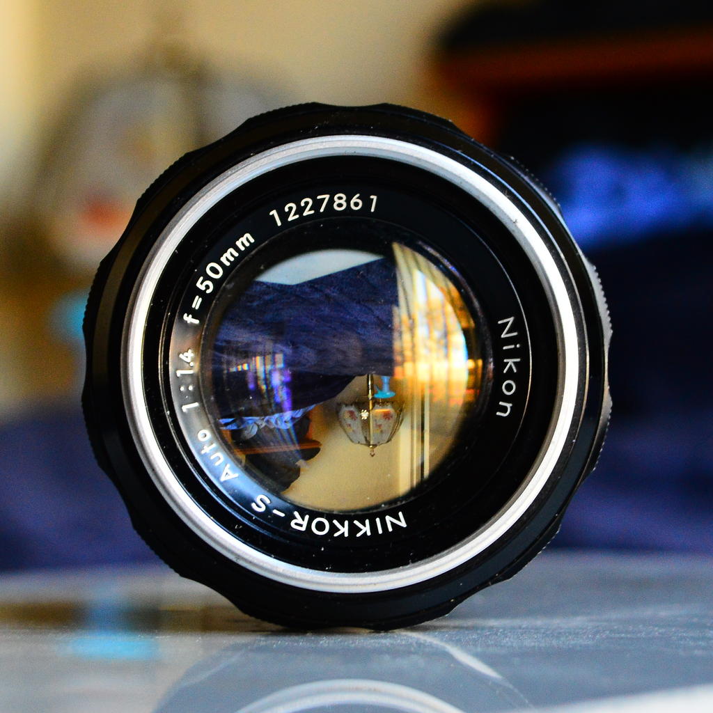

My 1972-vintage 50mm ƒ/1.4 lens, however, does use this nomenclature. The “-S” after “Nikkor” means that it has seven elements.
113469d1457503291-aperture-depth_of_field-relationship-nikkor-s-50mm-f1-4-a-csc_3529.jpg
