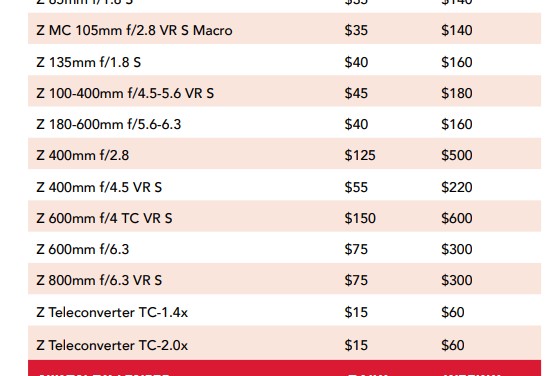

IF YOU ARE USING SEATTLE TO GO ON THE CRUISE, YOU MAY RENT A LENS FROM GLAZIER CAMERA IN SEATTLE.
PRICE LIST
THE 24-200MM LENS YOU HAVE WILL OK, I WAS CONCERNED ABOUT WEIGHT. I HAVE A 70-200, IT WEIGHS A TON. IT IS NOT CARRY AROUND COMFORTABLE. CHECK FOR LENS RENTALS ONLINE. LOTS OF INFORMATION YOU NEED TO KNOW B 4 YOU RENT.
IF YOU DO RENT THE 180-600MM I WOULD SUGGEST GETTING A MONO POD. I LIKE TO SPEND OTHER PEOPLE'S MONEY. :)
CAMERA BAGS, MEMORY CARDS, BATTERIES, LAPTOP, EXTERNAL STORAGE $$$$ ALSO YOU WILL NEED A GOOD PHOTO EDITING SOFTWARE
LIKE LIGHTROOM CLASSIC OR ON1.
