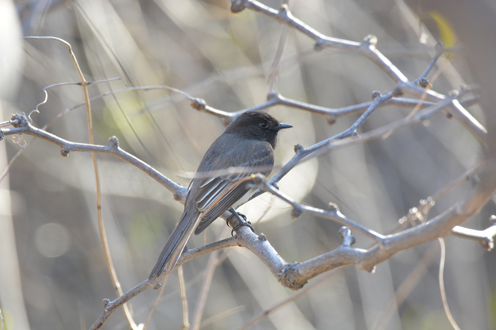

I have been trying auto ISO (set to 800), as I have been shooting in sun/shade/sorta sun/sorta shade conditions lately. I have found very odd results and am loosing a lot of pictures. Here is an example from today. Very bright sun; Tamron 150-600 at 600mm, 1/125, f7.1 -- and the ISO pushes to the max 800, blowing out the image. This has only been resized and compressed for posting
Is the camera simply trying to compensate for what it reads as contrast between the bird and background?

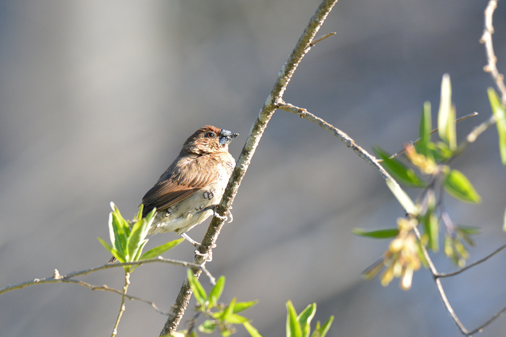

Another, full sun, 1/640, f7.1, and ISO maxed.
Is this sort of thing to be expected using auto or is there something iffy about the sensor? I am about to sent the body in to have the shutter/mirror checked after some lock-ups, so I wanted to note this down too, if wonky.

Looks like the first shot was metering the darker body of the bird which does not look very lit. And the second shot metered the background. So, I don't know that either would necessarily be unexpected.

That is what I do, too. Here is the problem in the first picture -- it is Southern California, crystal clear, dry as a desert, full blazing sun bright out and I have reduced the speed all the way down to 1/125 shooting at 600mm and it still blasts the image into a gray scale and blown out whites. Go any lower in speed and the image is a blur and focus fails -- and it is still at 650 ISO. The image in the viewfinder looks great, of course, but I am lucky to salvage a picture out of photoshop.

The exif says these shots were spot metered. Maybe that is the cause of the unexpected results.
Ah, had not thought of that. I went to spot, as the clusters were so random on what was going to be in focus and with my shots there is little time to fiddle about. That said, I will try center and see if I see a difference.

Bravo, you are correct, right on, good detective work. If we look, the Exif does say Spot metering, and Spot requires beaucoup more experience and attention. Spot metering is absolutely worst choice for novices (they don't understand it). Spot will rarely be correct, or even ballpark, without considerable user attention and knowledge.
Not that it matters, but we could ask what spot? And then, didn't that spot come out about middle gray? That will true of any color or shade the spot was on. Was middle gray desired? For example, we just learn to know that if we Spot meter on a Caucasian face (to isolate it from the background), we dang well better compensate it about +1 EV (so the face won't be middle gray). But novices don't know things yet.
It was camera Manual mode and fixed ISO 800, so no form of metering could change the camera settings at all. The user set them.
So to even ask the question about what's wrong, we have to presume the user manually zeroed the camera meter to select those settings, and thought he was metering. But he better be very knowledgeable about Spot metering to expect a correct exposure. Spot metering ain't easy. :) Spot is a very advanced technique, requiring considerable experience and special knowledge. The spot chosen should come out middle gray, regardless what it is or was.
One exception: Spot metering is used indoors, using automatic TTL flash (which does NOT Spot meter itself - it has its own method), will switch flash from TTL BL to TTL mode, and the ambient (where we use flash) is way down, insignificant, well underexposed. So even if the camera is not fully Manual, the ambient is too far down for Spot (or any metering) to affect camera settings for it.
Simply try using Center Weighted or Matrix metering next time, and the camera metering should improve greatly. :) This was not the cameras fault. It is the users fault for not understanding Spot metering well enough to use it. Not so many of us do.
