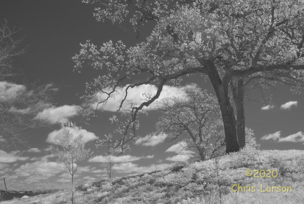

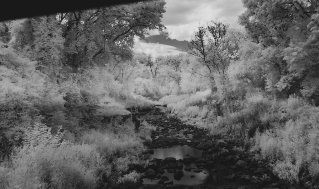

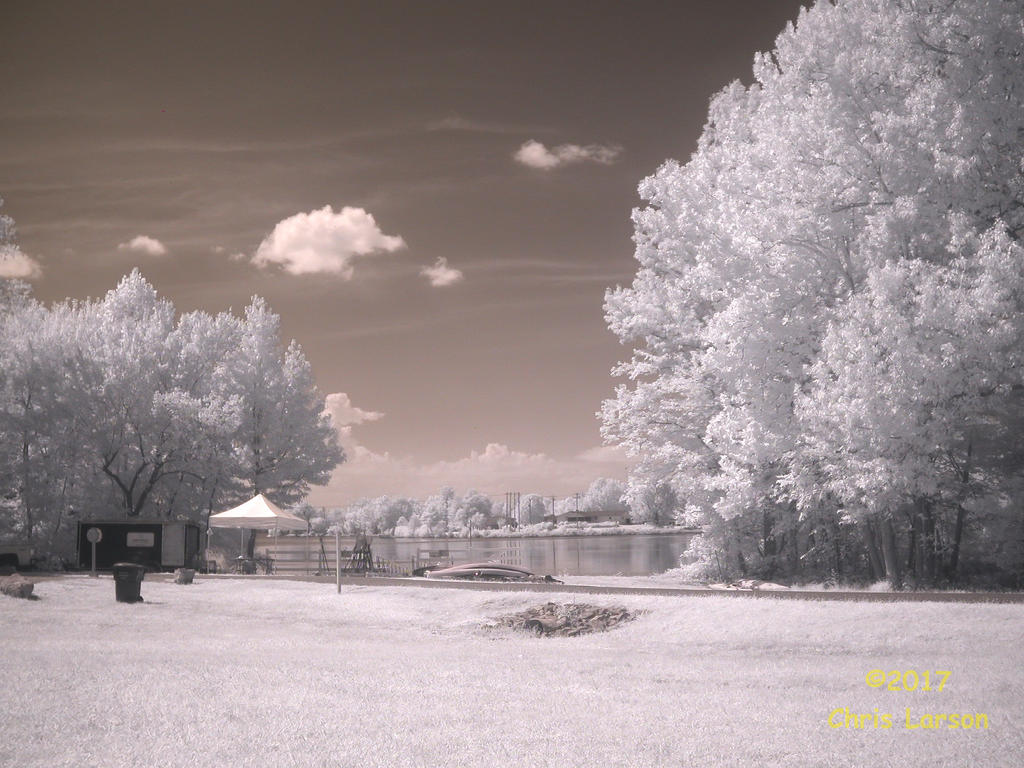

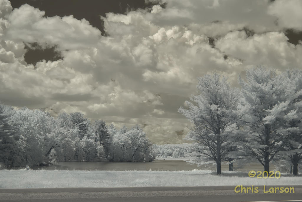

Here are 2 examples using that Coolpix 995 at the park in Madisonville, KY where I traveled to for the 2017 solar eclipse. I was too busy to try to get an eclipse shot with it though.
And an extended sampling from my D80 conversion last year. Still hurts a bit that it died.
Fully desaturated to B/W to start.

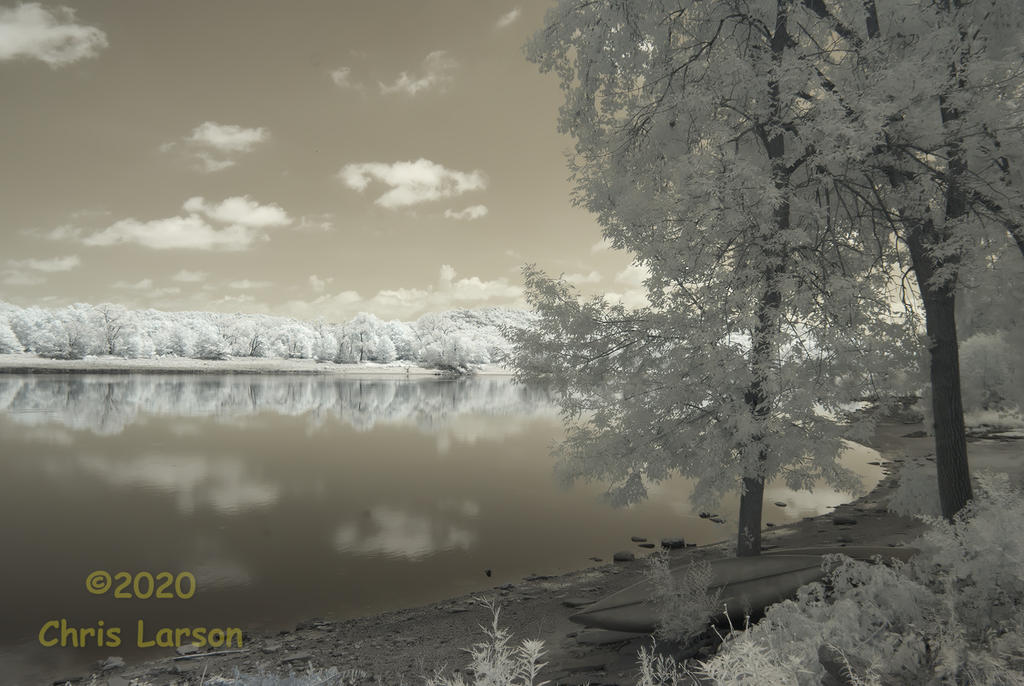

Color left as is next.
With the D80 I basically left the white balance on auto or measured a custom white balance off of green grass. I tended to shoot in aperture priority mode or in P mode. I mostly kept a very cheap 18-55mm DX (no-VR) lens on it.

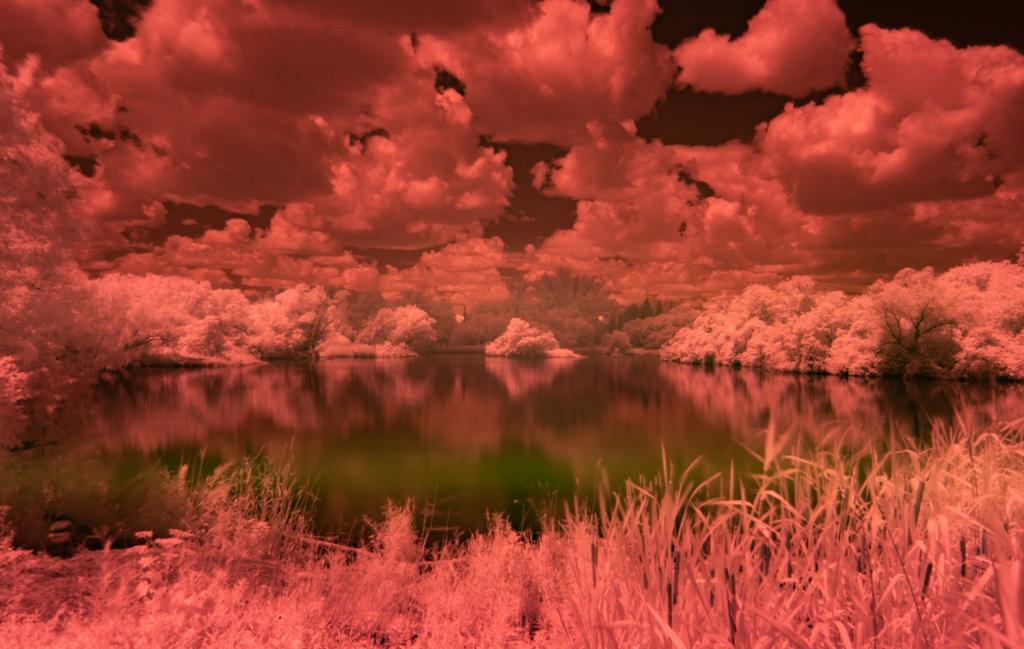

These are some of the said samples. Converted but not finished and they are not my pictures, just some raw samples

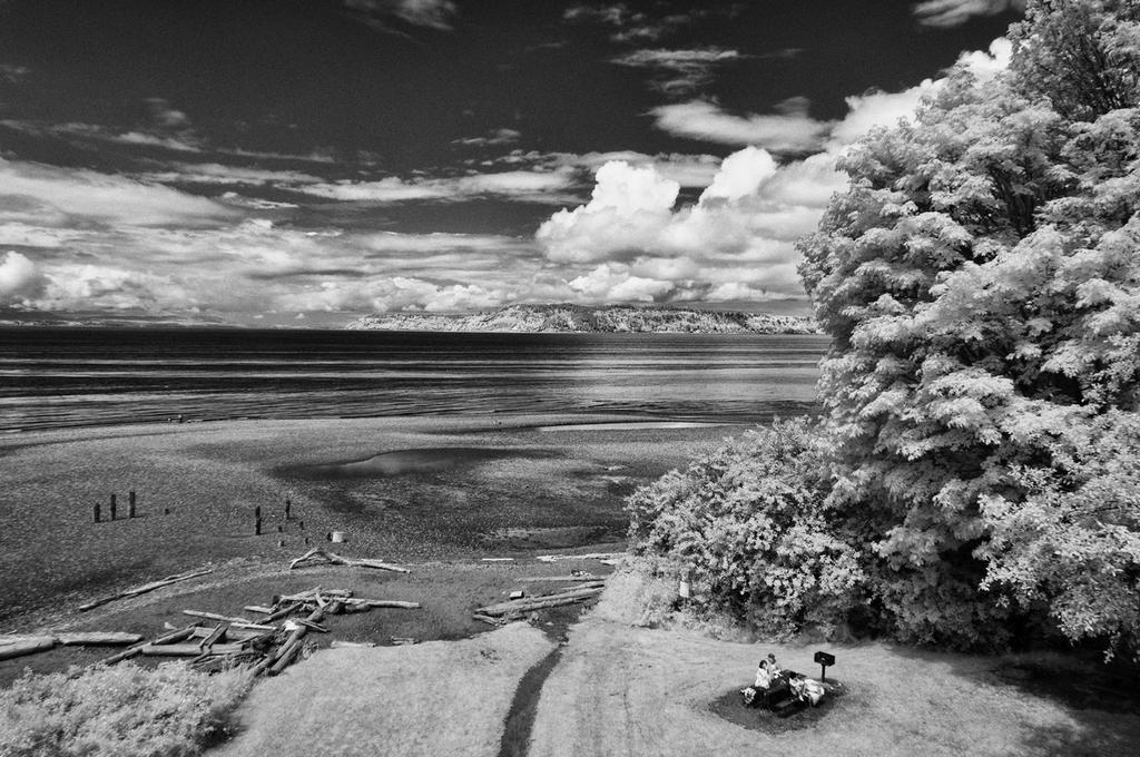

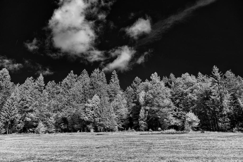

Took some ir with the filter today. The exif should show the exposure times. I had a preset white balance. Some green leaves. On average 20 seconds got me good shots with the sun shining. Sun in about 30 seconds. Bypassed the bulb exposure stuff. I found that the lens 18-55mm 1:3.5-5.6G II bleeds light in the middle of the frame. And it takes a while to set up focus filter on . Take shot disassemble etc. It's not the exposure it the dis assembly that gobbles up the time.
But I'm hooked. Now the fun part. Editing the stuff, or cheat and convert all to monochrome.
Oh, the EV was in the minus because I was shooting clouds as well
BF Hammer
Clouds sure do become dramatic in IR!
I have to question since the WB looks like it is still calibrated to visible light. Did you take the WB preset with the IR filter off the lens? If you don't use auto WB then the recommended way is to aim on some green grass and take the sample. In your case with the IR filter installed. In an IR converted camera, it will take out the pink-magenta shade on everything and make it mostly B/W. Some red will show.
lucien
I'm not sure. I read somewhere that you should shut it out. But I'm getting away with 20-30 seconds on average. I can't be bothered taking that thing off for every pic. I also find that my pics aren't as sharp as the should be. I'm heading out today for round 2. Using 2 primes today and not as windy.
