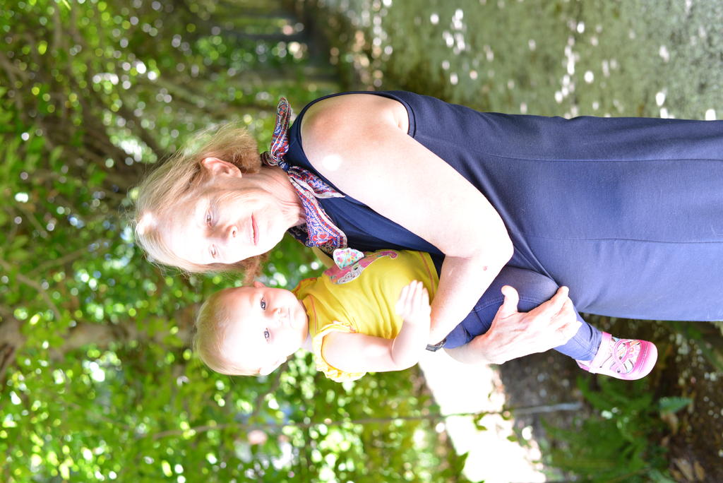

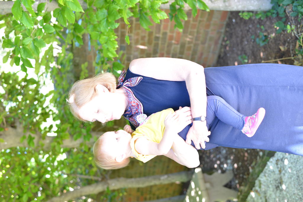

Hey everyone! I'm fairly new to digital SLRs, and I've mostly been using mine for indoor portrait shoots of my daughter (now 16mos). I've been getting great results with my indoor shots, but when I took the camera on a family trip to Colonial Williamsburg, it seemed like my exposures were all over the place. I took several shots in a row of my mother with my daughter, and some of them came out great, while others were significantly over-exposed.
I have been using spot metering, since I often take pictures in the house and I was having trouble with my subjects being under-exposed when they were standing near a window. I haven't loaded these into lightroom yet, and I'm hoping that maybe some of them are salvageable, but for next time, what can I change to avoid this? Am I using the wrong settings? Framing my subjects poorly? Here are a few examples, un-cropped and un-edited.
Thanks!

Eyelight
If not a bracketing setting, the post metering would have this effect. In every shot the center is good or not far off on exposure. Even the last shot, the jacket looks pretty good. Matrix metering would have set shorter exposures in the sunlit scenes and maybe a slightly longer exposure in #2.
Center-weighted might have been a good choice for the first two.
I also sometimes use exposure compensation to lessen the exposure in bright sun.
I would suggest going outside at mid-day and play with the metering modes and exposure compensation to get the feel for how they behave. Use the LCD to review every shot or every few shots.
#3 and the last one might be too exposed to recover, but post should work on the others.

you can clearly see it in the first three pics. the first and third have pretty much the same composition and measured from the center point from the back (dark green shrubs) and the middle one you offset it and the metering measured different in that.
WayneF
so, bottom line, if youre shooting A S or P, put it to center or matrix. you can shoot in spot, if you know how to measure for exposure properly, but scenes that change often are very problematic because the spot area will be on something dark and move the frame a bit and it will be on something light and your exposure will vary widely.
Amen, strongly seconded. Spot metering of ambient is anything but point&shoot (certainly is NOT for novices with no clue about Spot metering).
Spot metering is very special, and it does NOT make anything be exposed correctly. It simply makes the spot be a middle tone (correct or not), and ignores all else except the spot. Then you have to choose your spot, and then compensate exposure for it. This makes Spot usually be worst choice, because it is an advanced technique which requires some understanding.
In general, any routine point&shoot metering should be Center Weighted or Matrix. These modes are more for point&shoot.
See examples: Details about Metering Principles
Indoor flash may be something different. Flash does not use Spot Metering, but it does switch TTL BL to be TTL mode, which can be useful in dim ambient conditions.
Also regarding inconsistencies, do make sure you have not forgotten you are in bracketing mode.
