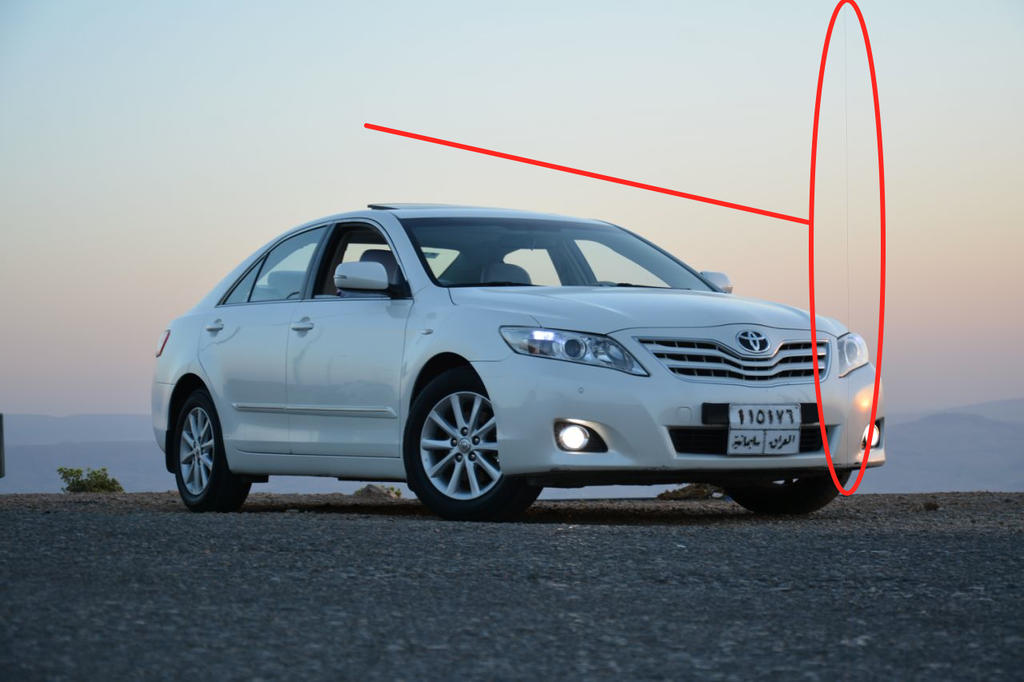

<blockquote data-quote="Felisek" data-source="post: 321784" data-attributes="member: 23887"><p>Almost certainly a sensor issue. Columns of pixels in CMOS sensors have outputs tied together (a row is selected during readout process), so it looks like the output from this particular column is damaged. As BackdoorHippie says, contact Nikon support, they will probably tell you to send the camera to them for repair.</p><p></p><p>Could you confirm that you see the same line in all pictures? If not, it might be a SD card problem.</p></blockquote><p></p>
[QUOTE="Felisek, post: 321784, member: 23887"] Almost certainly a sensor issue. Columns of pixels in CMOS sensors have outputs tied together (a row is selected during readout process), so it looks like the output from this particular column is damaged. As BackdoorHippie says, contact Nikon support, they will probably tell you to send the camera to them for repair. Could you confirm that you see the same line in all pictures? If not, it might be a SD card problem. [/QUOTE]
