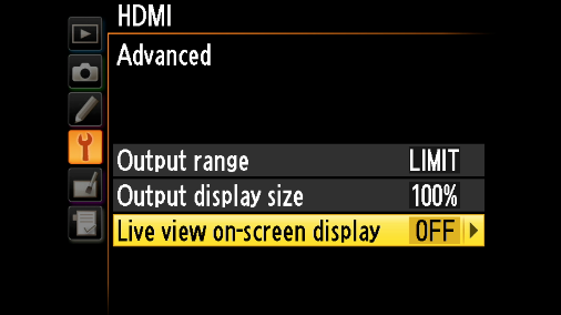

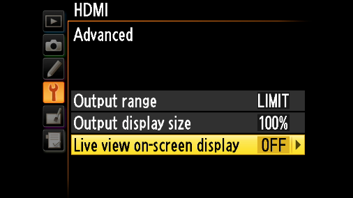

Try turning the "Live view on-screen display" off under the HDMI > Advanced settings.

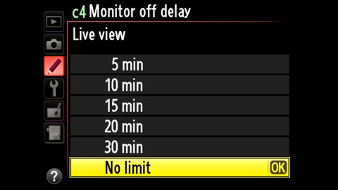

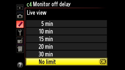

oh and if that doesn't work try settings the "Monitor off delay" to no limit - Timers/AE lock > Monitor off delay > Live view > No limit
