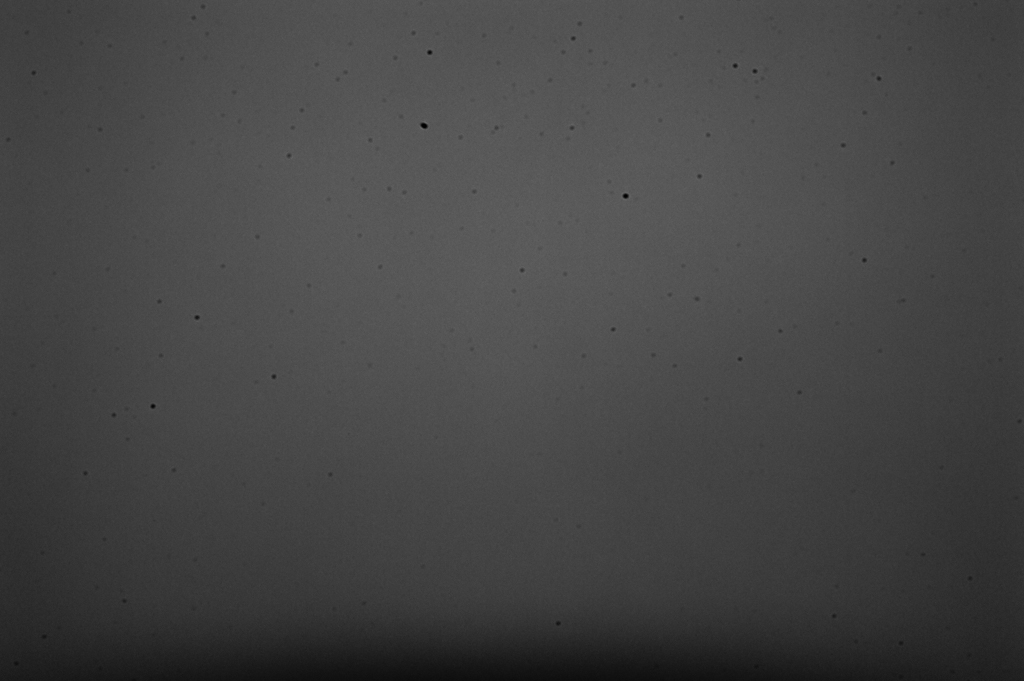

<blockquote data-quote="Eyelight" data-source="post: 415314" data-attributes="member: 24753"><p>I had noticed a few spots that would pop up in the same place, but nothing like what I found when I made a Sensor Dust Image. This is just shooting a normal photo and not using the cameras reference photo feature. There ref photo is for software to use.</p><p></p><p>Set lens to smallest f/stop, focus to infinity, if zoom lens set to longest focal length, shoot a brightly lit white surface about 10 inches (250mm) distance, process the shot for the best look and voila, you get this.</p><p></p><p>[ATTACH]139719[/ATTACH]</p></blockquote><p></p>
