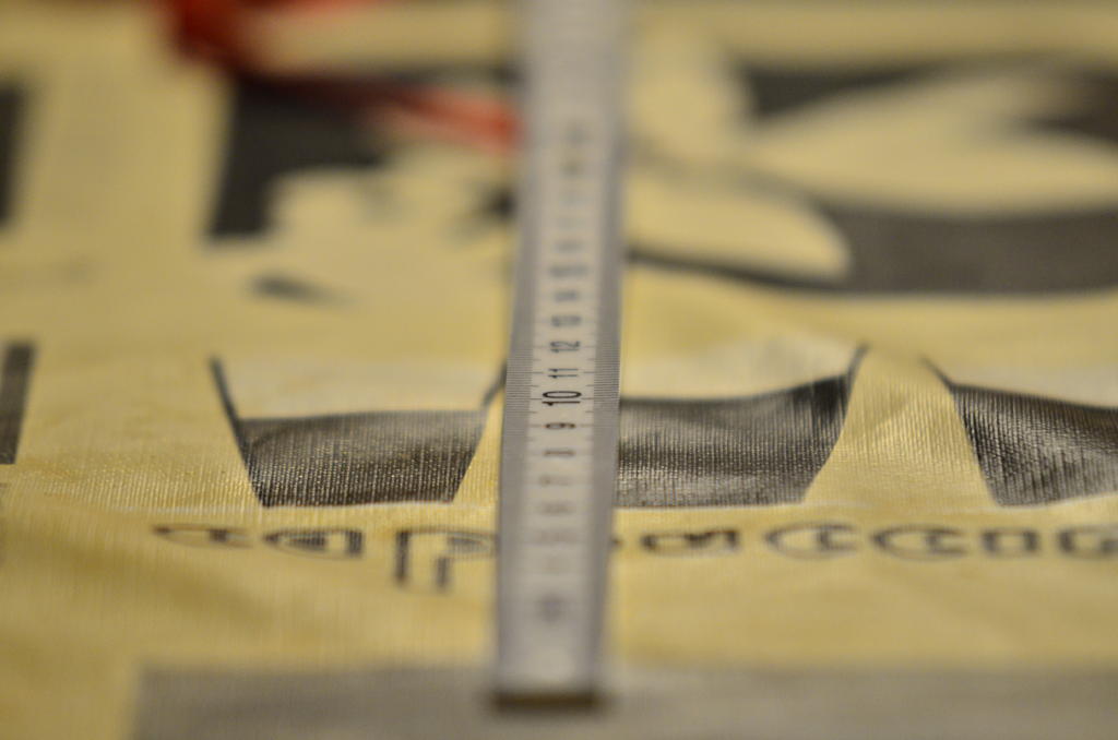

What confuses me is that i did take some controlled pictures on a tripod, and focus was exactly where i expected it to be there, but the pictures taken out in the real world suggests that my test was wrong
first one here is 200 mm, 1/250 shutter time, f/2.8 and iso 1400...focuspoint was on the 10.
Second one is 200 mm, 1/13 shutter, f.2.80 and iso 100, focuspoint was on 35.
These suggests that focus is fine, but i don't know? single point focus and af-s

That's certainly a fair enough test to show that it's working. What was the focus mode on the original photo? It a wild guess, but I do know that in Single Point mode, if you lock in on a focus point (shutter depressed 1/2 way) and then move the camera the lock point does not move as it relates to the frame, so the subject on which the final image displays as the lock point may not be the subject on which focus was actually achieved. In other words, if the camera originally locked on the cement bench to the child's right and then the camera swung left a bit it may appear to have locked on the child but in reality did not. Again, a wild guess, but it's the only way I can explain the differences in results between the calibration shots and the original photo.
