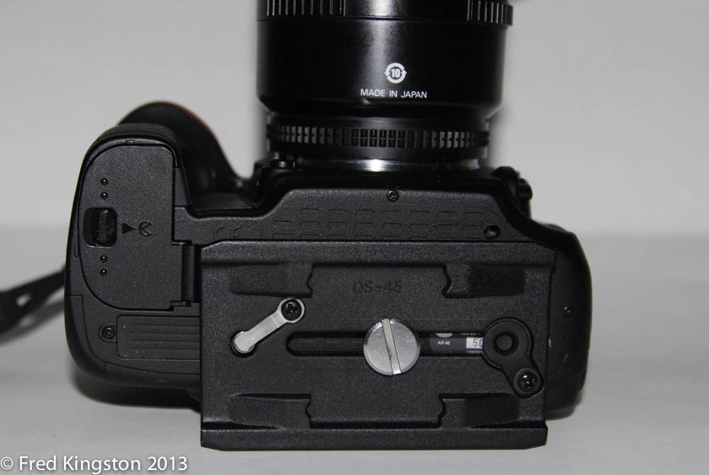

Just for reference, the QR plate on the Vanguard SBH-300 is 2.25" wide by 3.5" long... :hypnotysed:
Hi Fred, I am looking at getting this ball head. I am just wondering if the QR plate being the size it is, does it impede access to the battery compartment once fitted to the camera ?
No... here's a snap of it mounted on a D600... plenty of room to open the battery door... as you can see by the long slot the screw is in, there's plenty of lee way in the plate to mount it off center in either direction...
