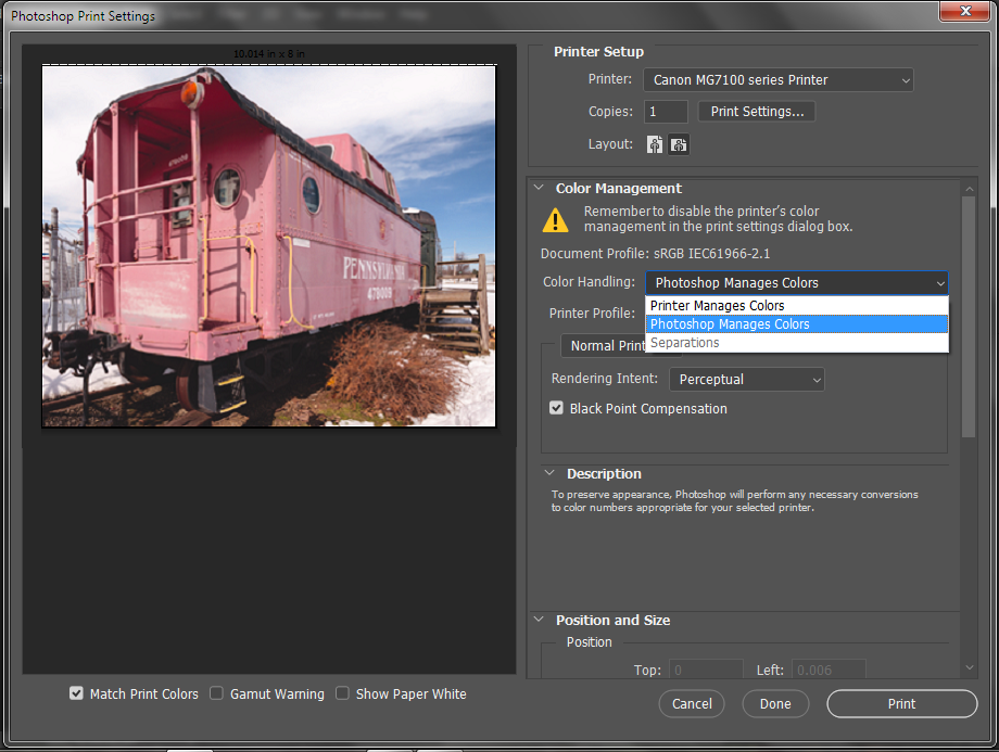

If you are printing from Photoshop, you should allow Photoshop to manage the color rather than your printer. In PCC, you should find this printing dialogue box. And be sure to choose any other printing options you want. They WILL make a difference in the final printed copy.
