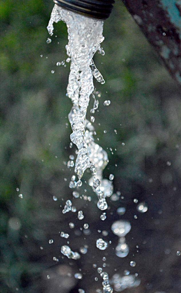

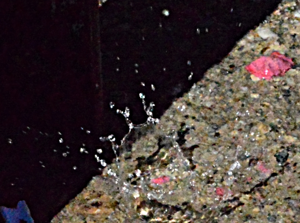

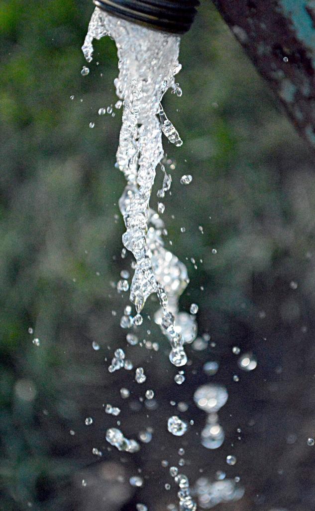

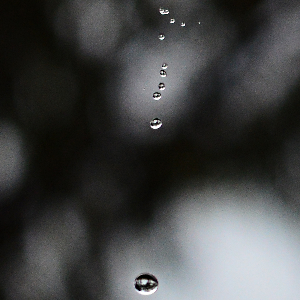

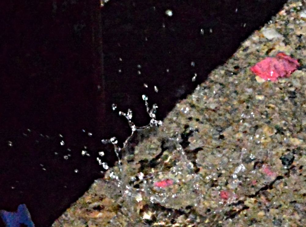

I have it in my head that a typical electronic flash has a duration of anywhere from around 1/500 to 1/2000 of a second. I don't know where I got this figure, and I don't know whether it's true or not.
I don't think any modern DSLR has shutter with a top speed of less than 1/4000 of a second. The higher models go up to 1/8000, and Nikon had one model that went up to 1/16000.
In any event, if you've got enough light, 1/4000 is plenty fast to stop falling/splashing water.
