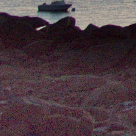

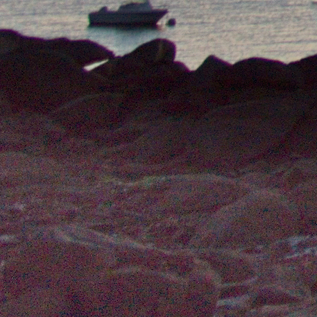

Here's a shot taken suffering clipping:
It suffers the magenta "noise" too even while being shot at 100 ISO.

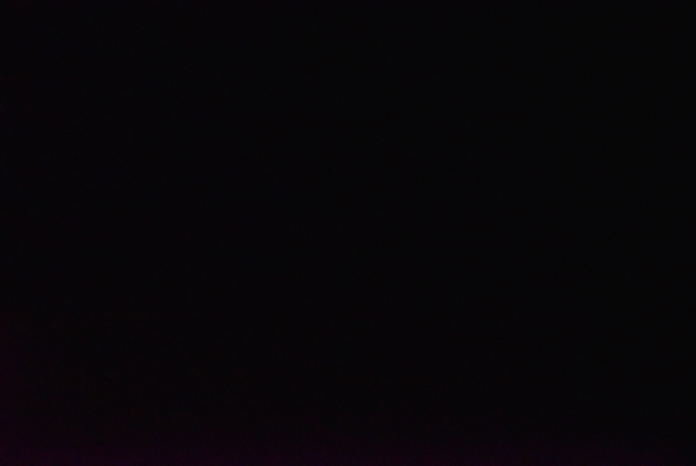

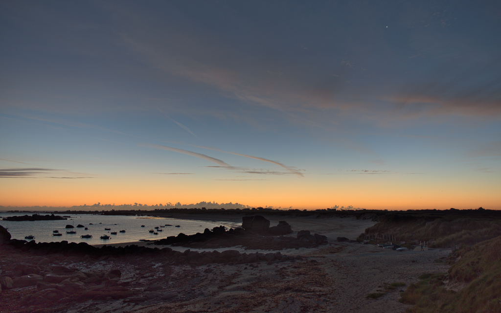

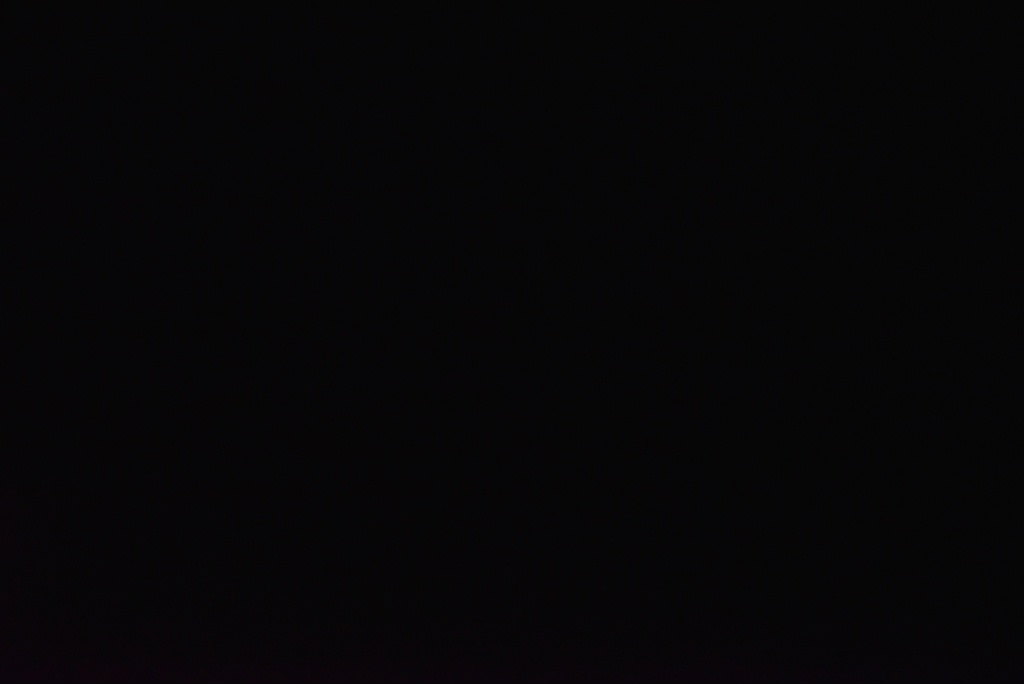

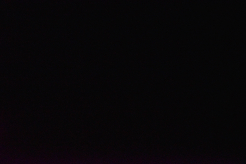

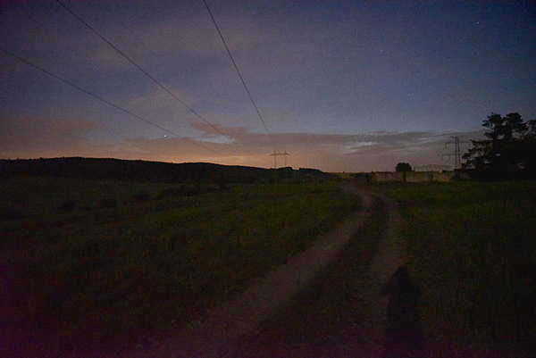

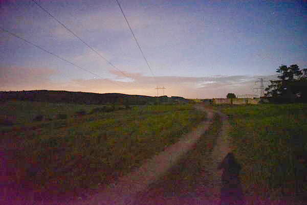

Hi everybody and thanx for your replies, to J-see especially. Yes, the magenta high ISO noise is in the pictures, not only on the rear display. Interestingly, the noise on the rear display is much more vivid then in the pictures. Usually I test the presence of the magenta noise in the photo by making an exposure with the lens cup on. Every exposure taken like this with ISO number from 5000 up shows the magenta noise, the higher ISO setting the stronger magenta noise. I hate to have found it out after purchasing the camera. Is it a normal phenomenon with all DSLRs of all makers including the most expensive top pro full frame cameras? Or should I have mine got serviced? Before purchasing my Nikon D750, I went through many reviews of the camera and its competitors and never hit a word about this annoying artefact. See this example of the night photo taken by my D750 at ISO 12800-f2.8-1/10s:

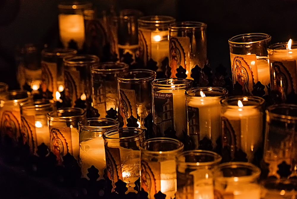

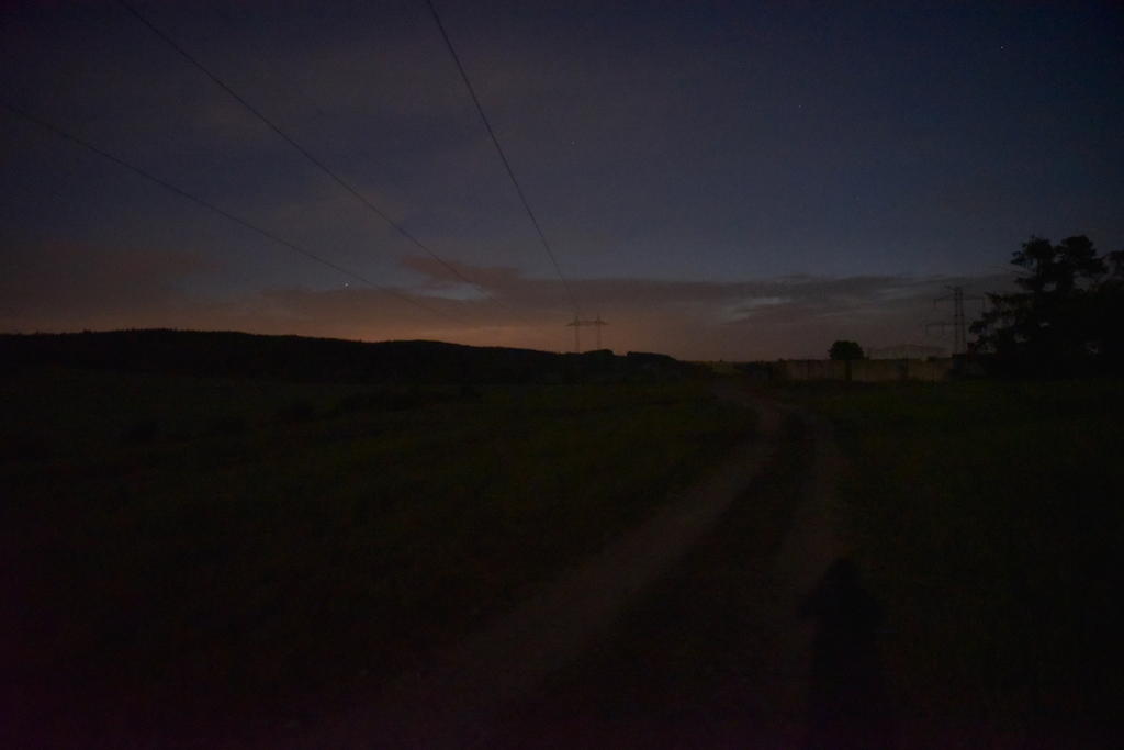

Just to reiterate what @mikew said... Here's a shot (with lots of deep shadow) I took with my D750 a while back, also shot at ISO 11,400. No no noise reduction was done:

I just checked out the shot with the lenscap on. I used some blending and brightness adjustment to show better what should not be there.
Try taking the same shot but with the viewfinder covered since it can leak light through there. If you still get the same noise, something weird is going on.
Edit: I pushed it even more.
That there is a pixel active here and there I can imagine but this is something else. Either light leaks in, the sensor "misbehaves" or amplification goes wrong.
Also try a shot at 100 ISO with the cap on.
