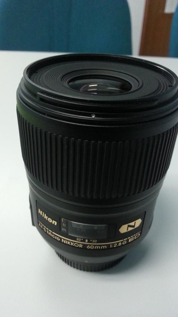

This morning, i was asked to verify our office asset. While going to the list, I notice my office got a pile of unused camera dated back from the film SLR (mostly cannon) until the latest Sony alpha and Nikon. Curious, i went to the store and inspected each of the stock. Some of them need to be 'dispose' off. Then out of nowhere, i found this lens, collecting dust. A Nikon 60 mm f/2.8 G ED
According to the store keeper, the lens has been sitting there few years ago and nobody is using it. The procurement was done by our HQ and non of us including me knew it existence. Huhu.. What's made me mad is the lens is there without front n rear cap and no filter is attached. i took the lens and observed. Being noob, i dont know how to inspect the internal part... i only press the metal thinghy at the attachment mount and look through a light ... i saw small white/grey dots..not sure what is it.. Is there any guide on how to inspects lens for internal molds etc...
I knew this is an expensive lens so care should be taken. I already asked the guy to let me keep the lens for the time being.

First, blow any dirt/dust off the front and back lenses with a Giotto Rocket blaster, then gently clean the front lens with a microfiber cloth....GENTLY! Don't rub any dirt or dust onto the lens. Clean in a circular motion starting from the center and working your way towards the outside edge of the lens. If you have access to a lens brush, such as the one found on a Lens Pen.....use it. After you're satisfied that it's clean, take a few pictures with it and see if you notice any spots on the picture.
To check internally, use a small penlight/flashlight (torch) and shine it up inside the lens from the bottom of the lens with the aperture open. That should tell you if there's any fungus or dust bunnies in there. :)
