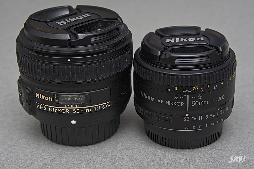

The lens on the right is an example of a AF-D that Brent mentioned. The left is an AF-S which will auto focus on the d3200. The AF-S contains a focus motor which is require for the 3200 to auto focus.
