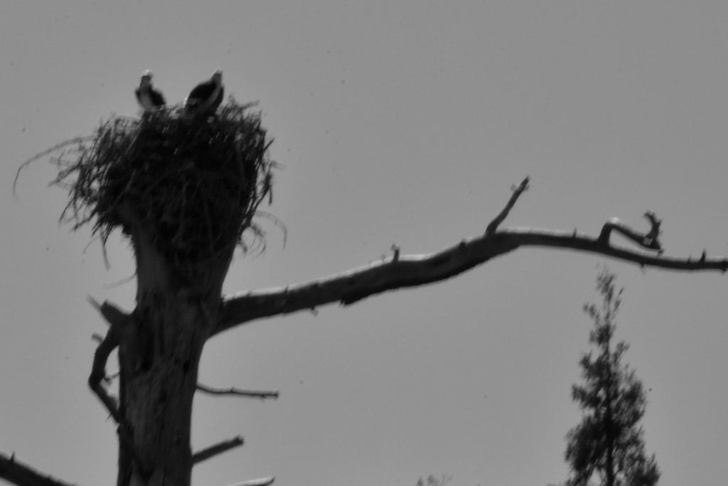

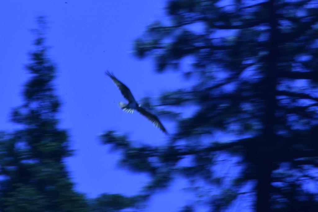

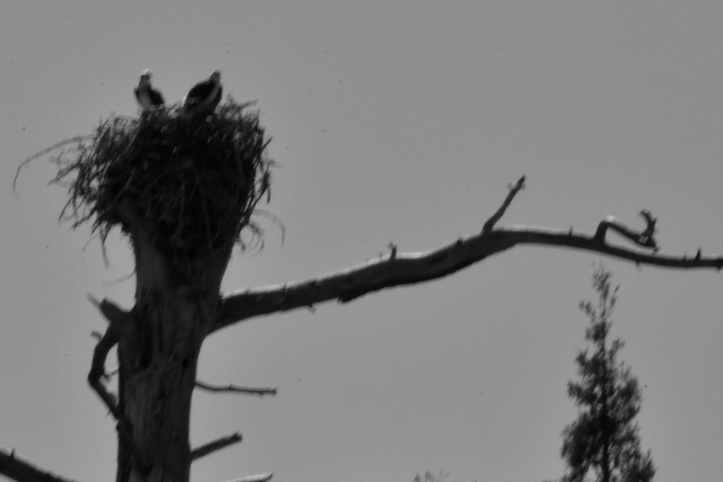

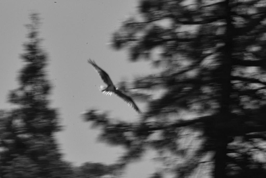

When I was at Fallen Leaf Lake last week, I had an opportunity to photograph a pair of Ospreys landing on their nest. I swapped lenses to a VR 70-300 but did not change any camera settings, and the results were blurry, even those where the ospreys were sitting relatively still. I'm interested in learning what I should have done immediately when I saw the opportunity to photograph the Ospreys, and what would have given better results. Here are a couple of examples I wish had been taken with a faster shutter speed and a higher ASA setting. I was in a boat, so use of a tripod was not feasible. I have not investigated the D7200 Scene Modes, so I wonder if the camera is smart enough to increase the ASA or shutter speed when I am photographing a moving subject or panning the camera, if I had changed modes.

Its your settings that are wrong i would suggest you go onto manual with auto ISO
I would suggest you move the shutter speed up from 1/60th which is far too slow and for learning and birds in flight go to 1,000th set the aperture at 1 stop down from wide open and use auto ISO with a max of 3200,you may want to refine these settings later but they should get you images that will set you down the right road.
paul04
That's the settings I have for birds in flight.
Auto iso (limit at 3200)
Shutter speed 1/1000th
Aperture at 6.3.
Then make small adjustments depending on available light.
Blacktop
SS 1/60th. F/45??::what:: No wonder.
Increase your SS to over a 1/1000th, open up the aperture to f/5.6 and use auto ISO.
Set focus mode to AF-C when tracking BIF.

Paul & Mike, thank you for the settings info. I can see that I need to get more familiar with the camera. Auto-ISO with a limit of 3200 is my default setting, changing to manual mode and setting aperture are both easy to do, ingrained from many years of using film cameras, but setting shutter speed on the D7200 requires a bit of search through manuals or menu settings. Time to re-read the manual, to see how to set shutter speed, and to investigate whether there is a simpler way to set up the camera so that it becomes very simple to switch from one setup to another. I was hoping that D7200 Scene Modes might be a way to go. Sports mode might be similar enough to work, but the manual does not really say what it is, just that it is optimized for fast shutter speeds...

The D7200 was set for Shutter Priority with Auto-ISO, and AF-C, which is what I use for general shooting. The aperture was set automatically.

Lots of the time with wild life you will be looking for a particular shutter sped and aperture so the one to let vary is the ISO especially with the D7200

I agree with Mike and Paul about the settings to use. On my 7200 (which my wife has now borrowed????) I have these saved on U2 which is one click away from M on the dial. This allows me to very quickly go to my BIF settings.

Same here, and on U1 more or less the same settings, apart from shutter speed set at 1/500 for static birds/animals

One thing that might help you overall is using the Minimum shutter speed under the Auto ISO setting. Set it to Auto and it will look at the length lens you are shooting and set the appropriate shutter speed for you. It also has a slider so you can adjust it to shoot a little slower or faster than normal. I generally suggest you set it one click faster and the norm. You will get a few more good shots this way.

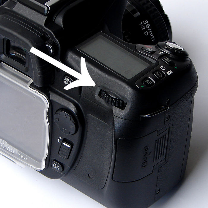

RobV

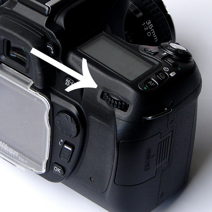

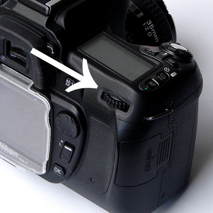

In manual mode, adjust the rear command dial for shutter speed, and the front dial for aperture.
That is one of the main reasons my 2nd DSLR had two command dials, to make manual mode as close to the film camera SLR experience as possible, especially pre-electronic.
